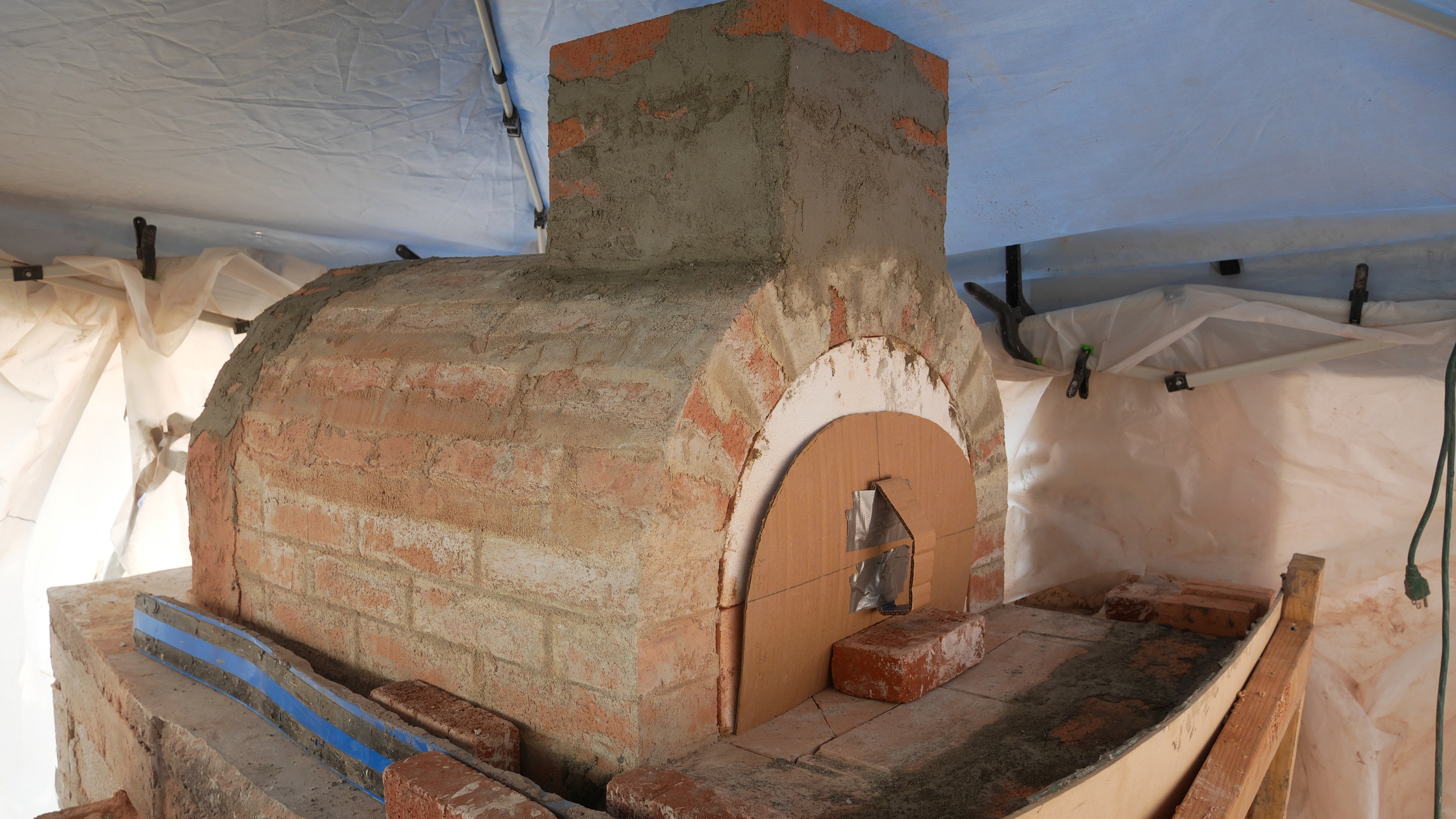

Brick work is done…now on to the fun part!
Looking good! Not sure if that hand-crafted door is going to stand up to the 1000 degree heat though.
hAHAHHAHA…Good one!!

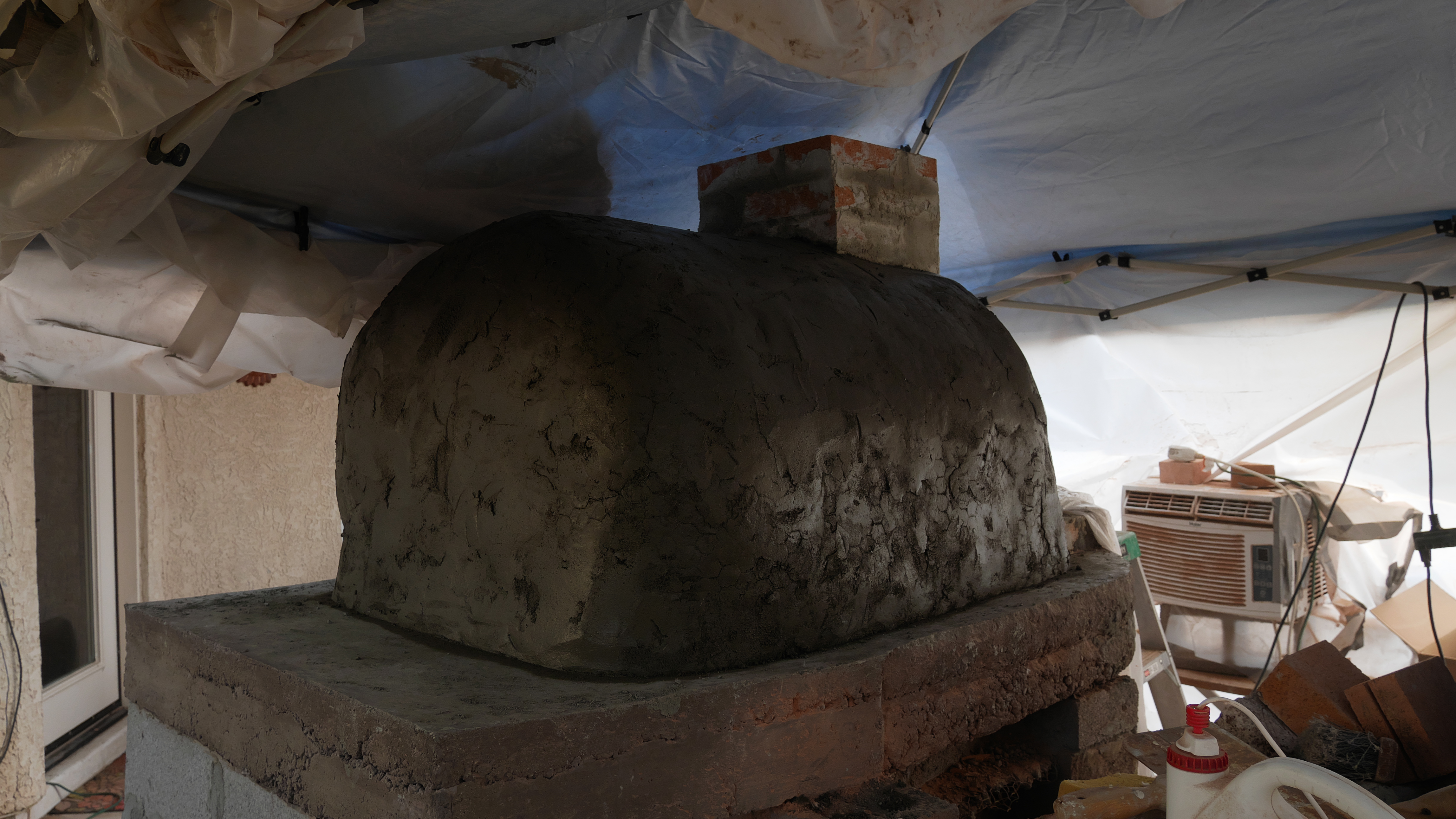

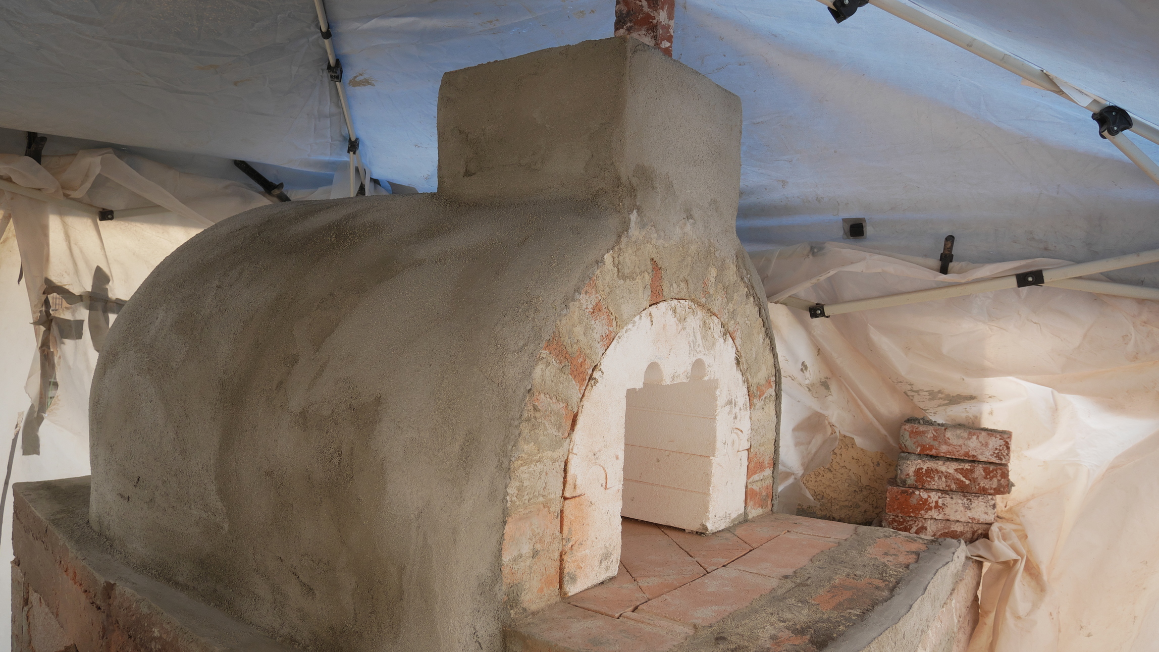

Her butt’s getting bigger with every coat of stucco! Happens to the best of us…the form comes out this weekend!
It’s All About The Form…

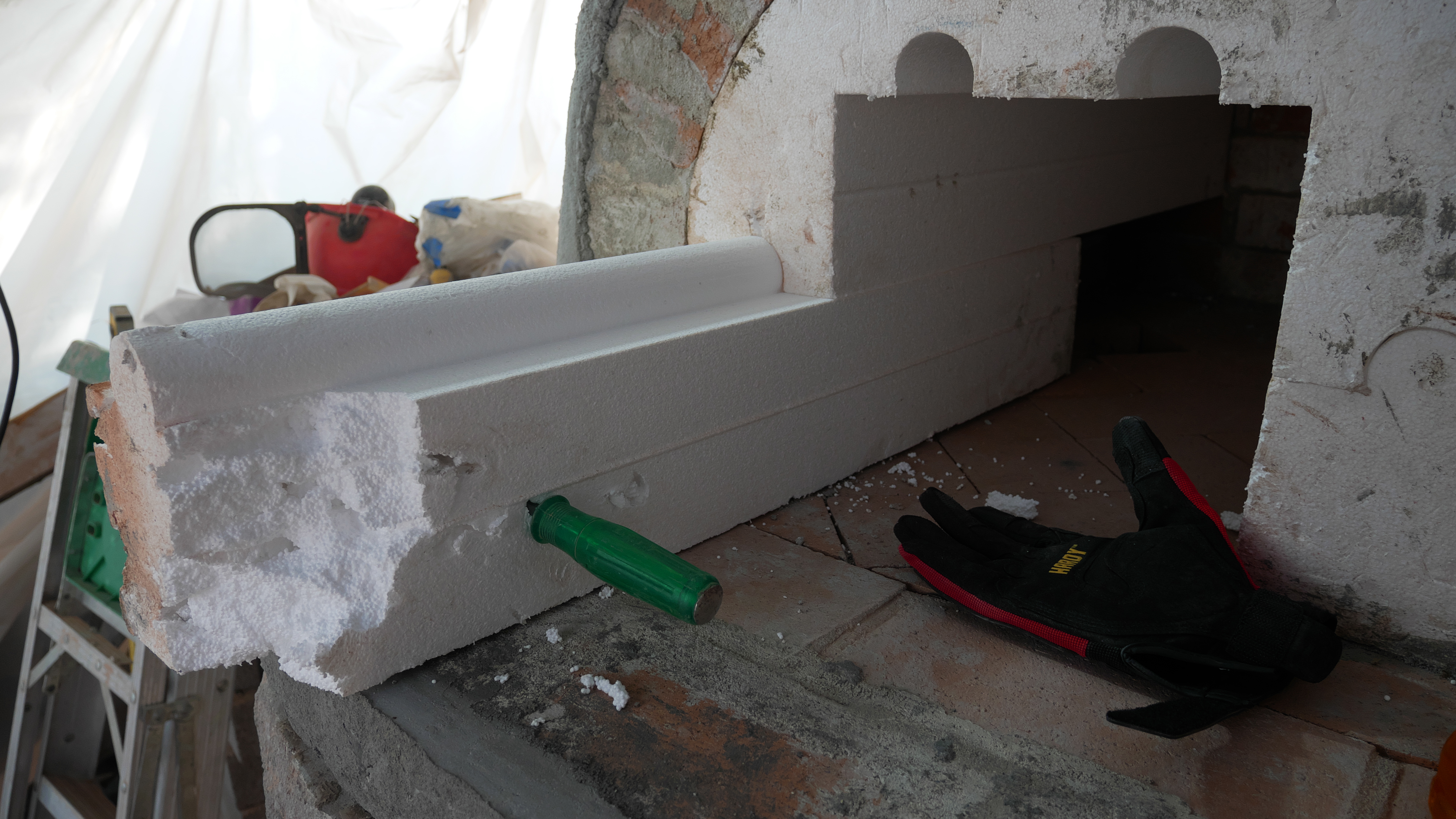

Form’s out! Apparently…there’s an oven inside of here?! Now comes the fun part! Close down the front and add some decor…
All that pan spray was worth it! First side slipped right out…
A little fighting with the other side…then the roof came right out!
I was a little heavy on the mortar I guess? Oh well…

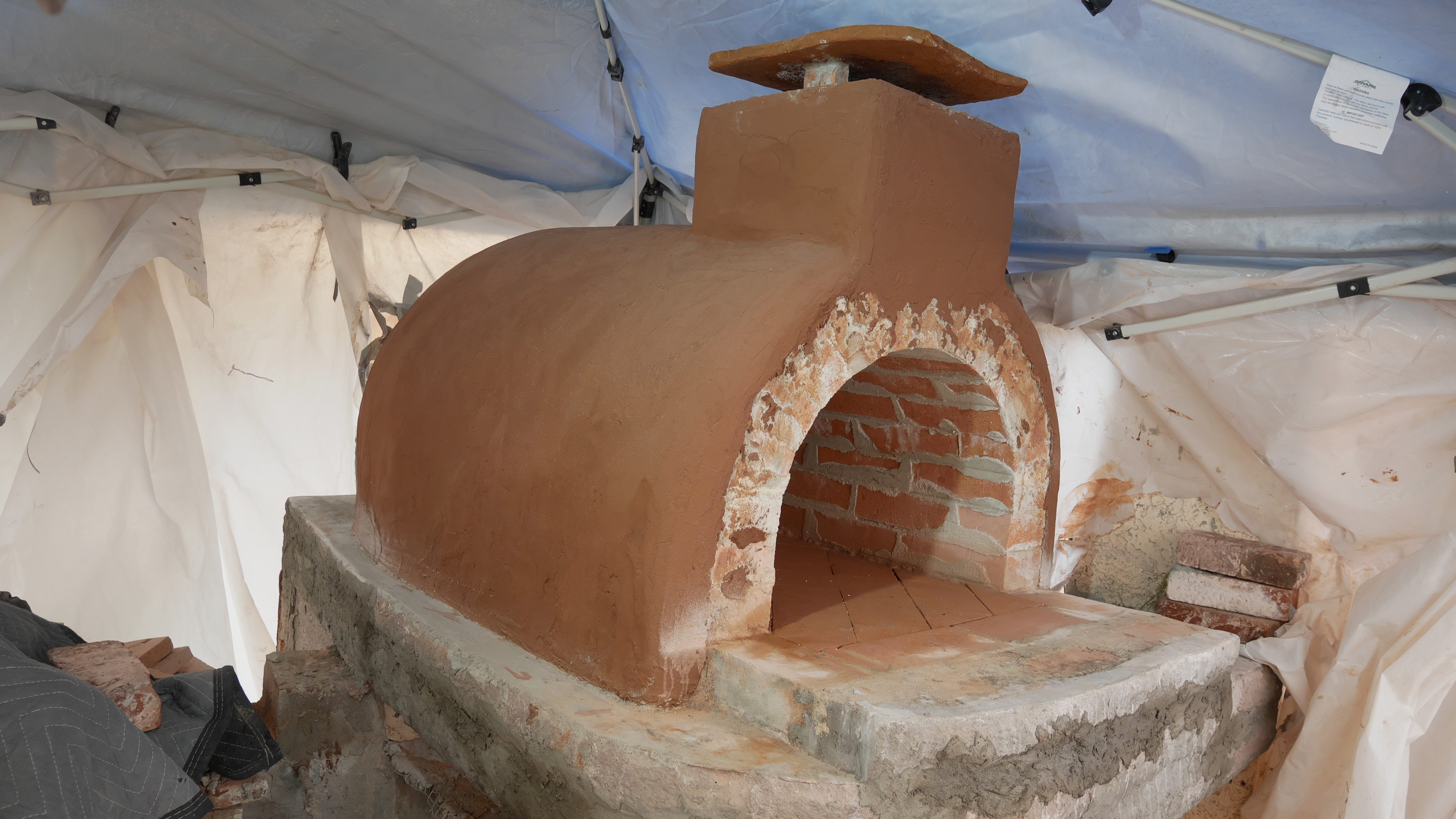

Starting to play with a little stucco (colors). I think we are going with the bottom color. My custom door has shipped!! As soon as it arrives, I will start closing off the front…
In the meanwhile, I’m playing with a “floating” chimney top…and the “stone look” on the concrete slab…

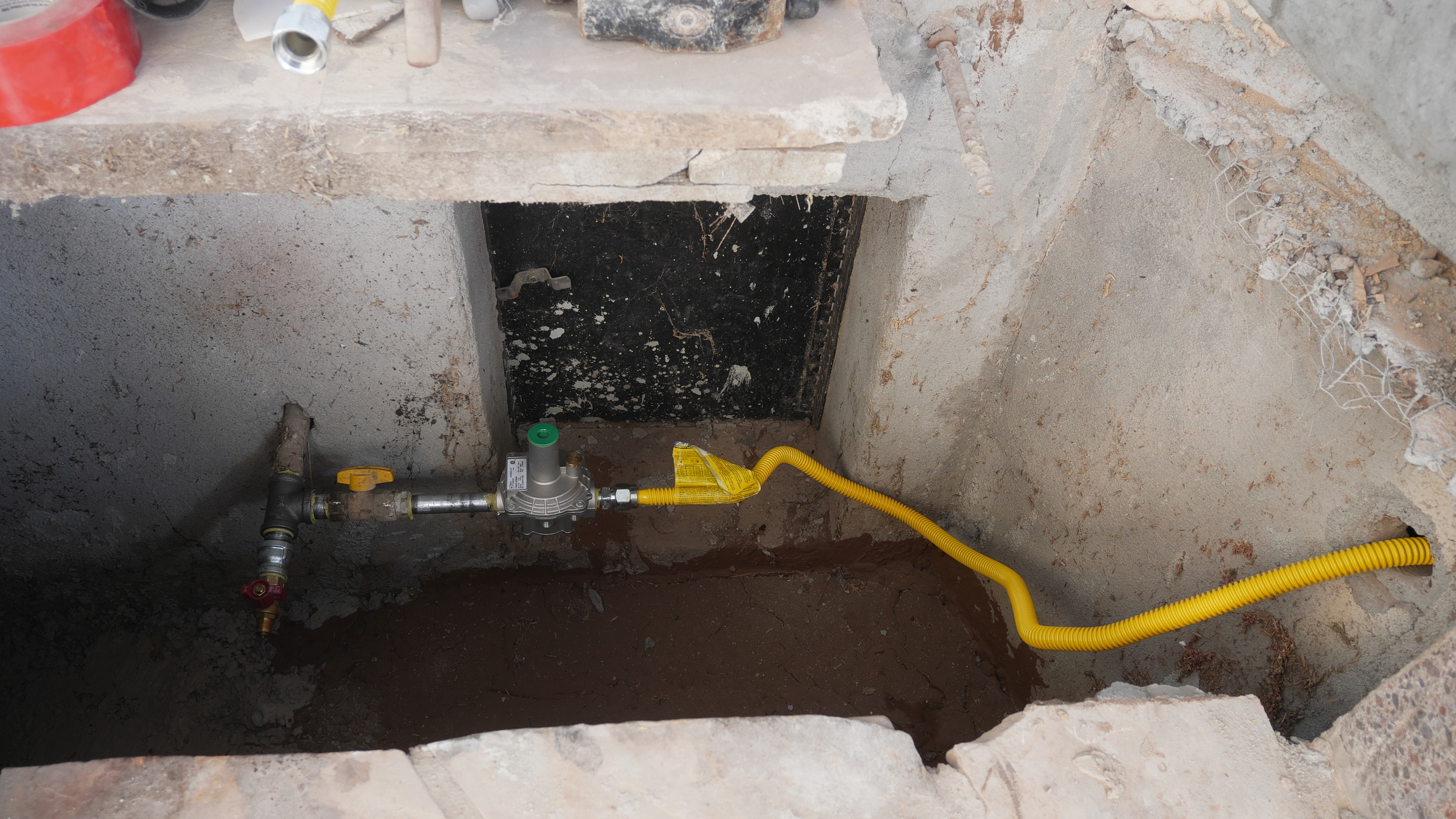

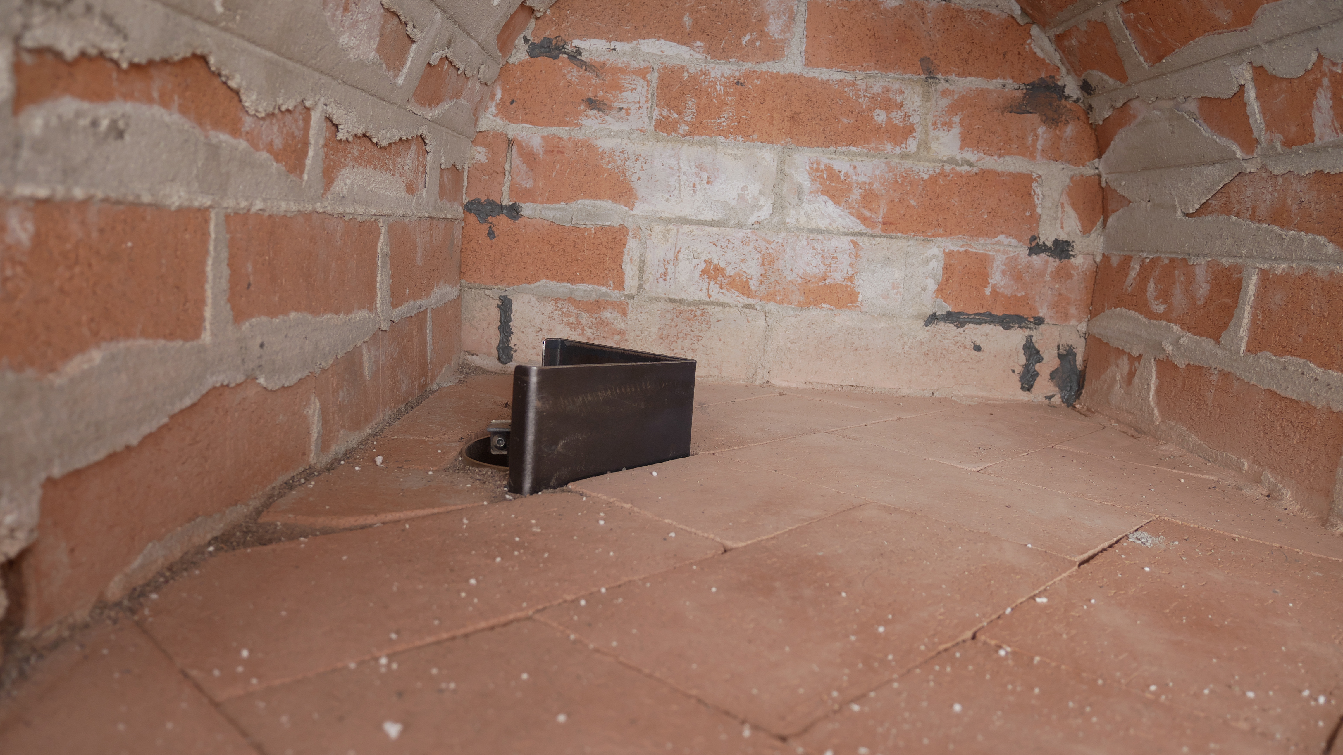

Well…here’s a last look at the Burner. It is installed and awaiting the Plumber tomorrow. Wasn’t going to tackle that myself! The Burner will be protected by a steel shield, made for me by the guy who made my oven door. Both are supposed to arrive tomorrow. The plumber has been warned to light the burner only as much as necessary, to prevent thermal shock. The oven hasn’t been cured, yet.

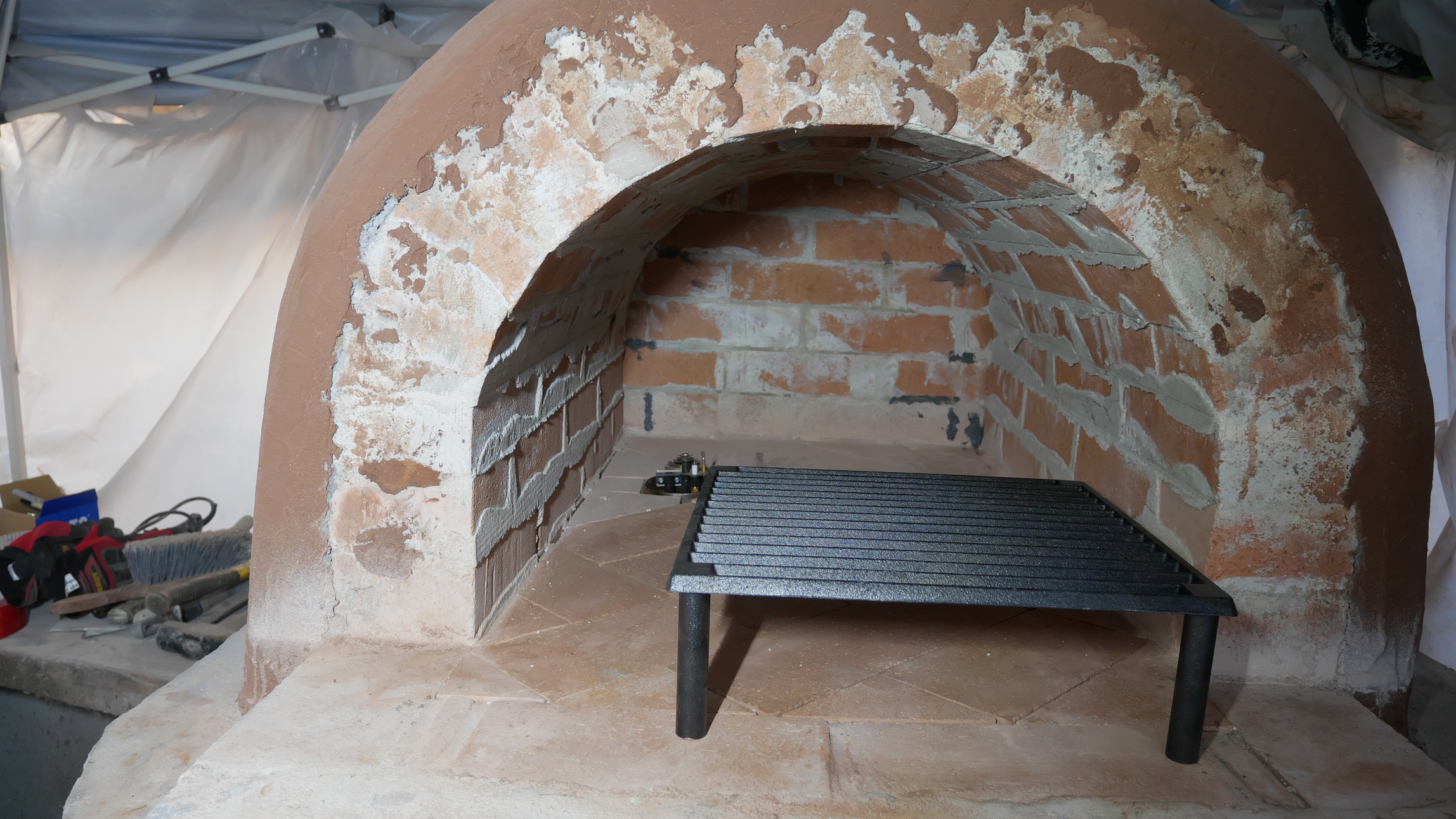

Once I have the door, I will confirm my template and start closing off the front! My Tuscan Grill rack can’t wait for the steak!

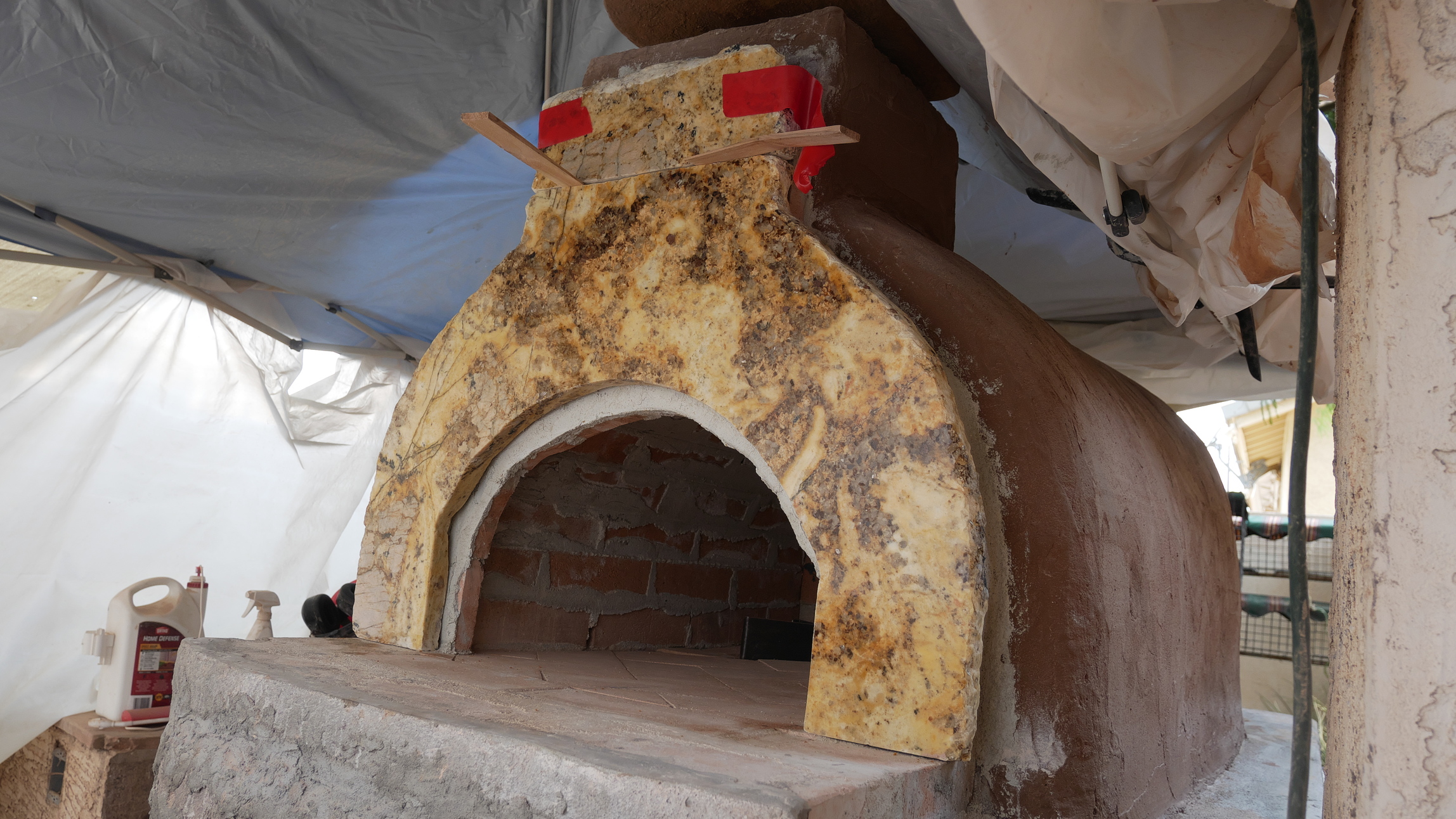

Closed down the front today. I used the same form, as it came out in (virtually) one piece. A little Sawzall work and it fit perfectly.
The door and shield came yesterday, and I was able to match it to my template. I was spot on…but it doesn’t hurt to check. Both fit perfectly…
It was a bit harder than I thought it would be. After I added the angle iron, the front stuck out about 1/4" more, towards the top. I didn’t think about that. I used the remaining mortar to add a “scratch-face” so the granite will have something to hold on to.
From here on out…it’s all decoration!
Hey All!

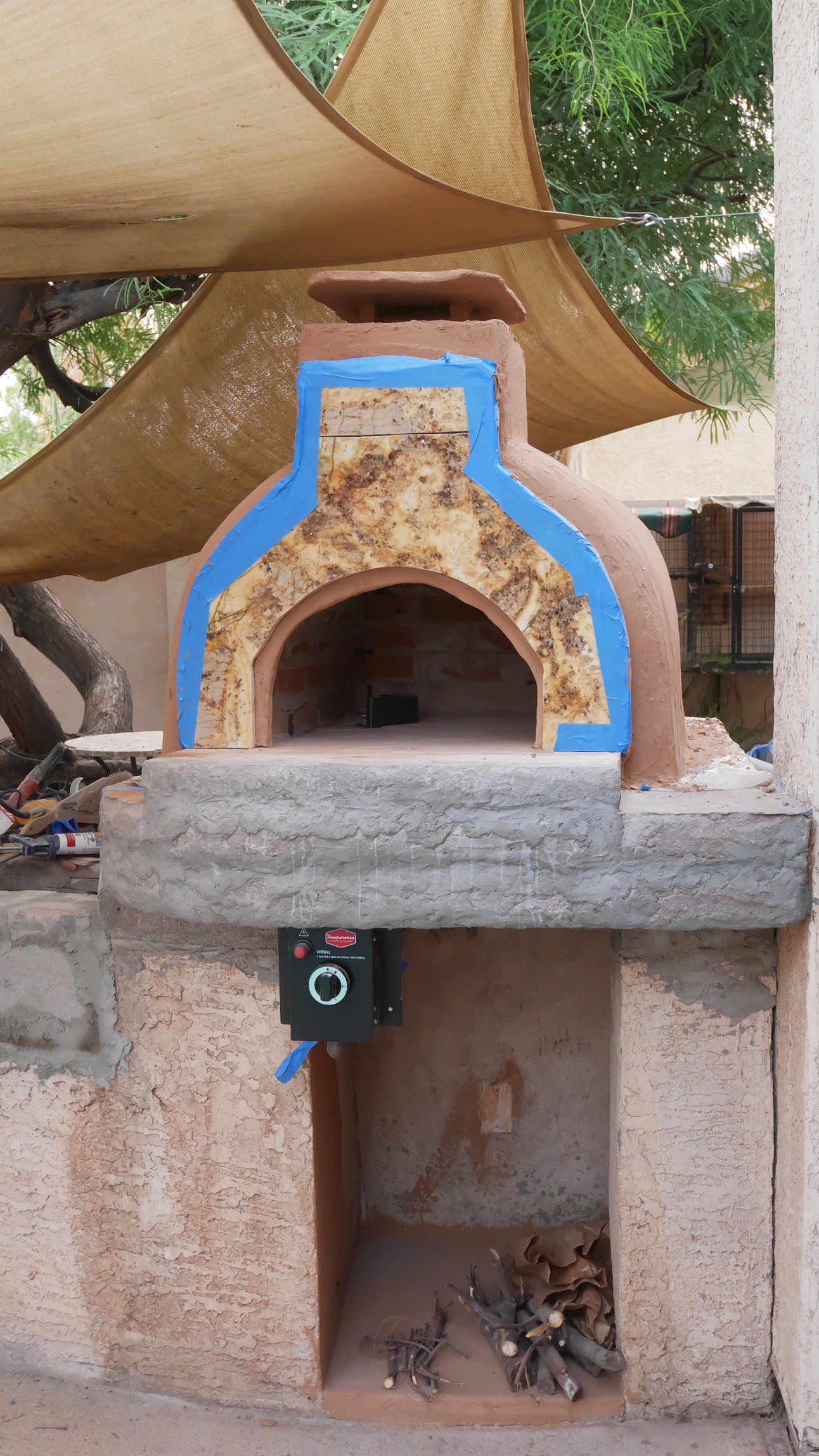

I got the granite cut and chisled this weekend. Looks pretty good, for a first timer. I need to seal the seam and then seal the granite. As soon as my stucco comes in, I can match the colors. I should be able to start the curing burns this weekend!

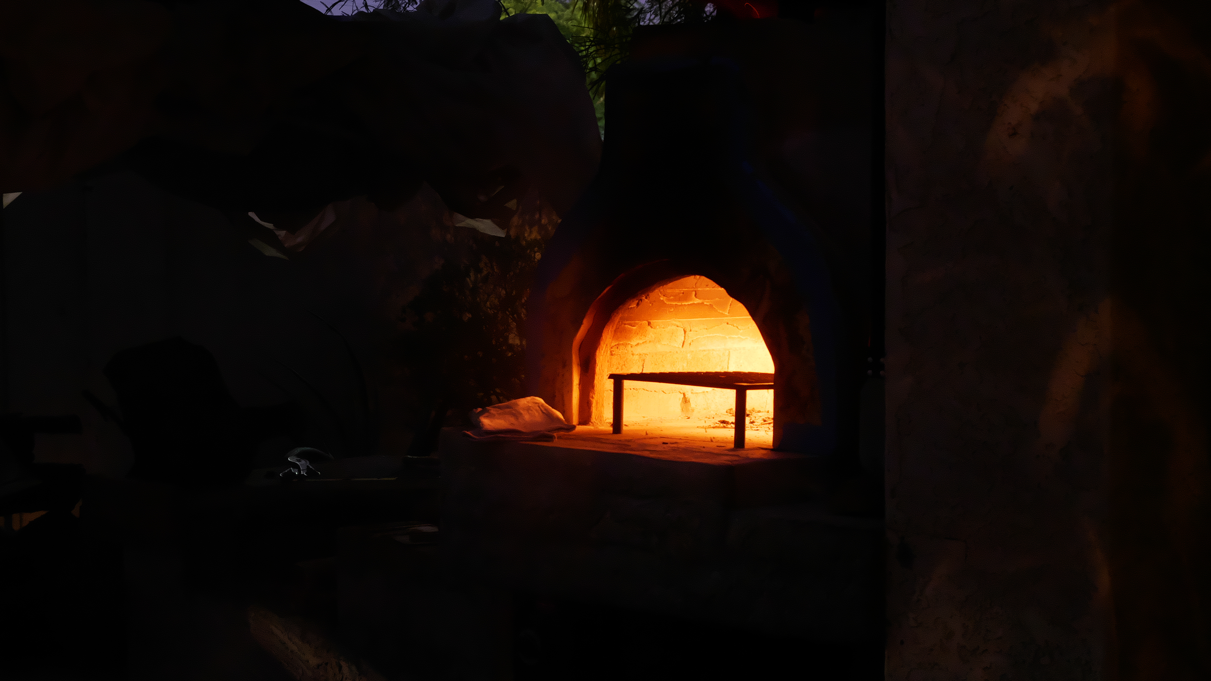

Well…after countless weeks of work, inside a tented sauna…the Carter Family Oven finally peaks at a little sunlight…and it’s first (of 6) curing fires! I’m still doing some cosmetic work on the marble and stucco…but she’ll be ready to cook by next week! Now comes the rest of the island…

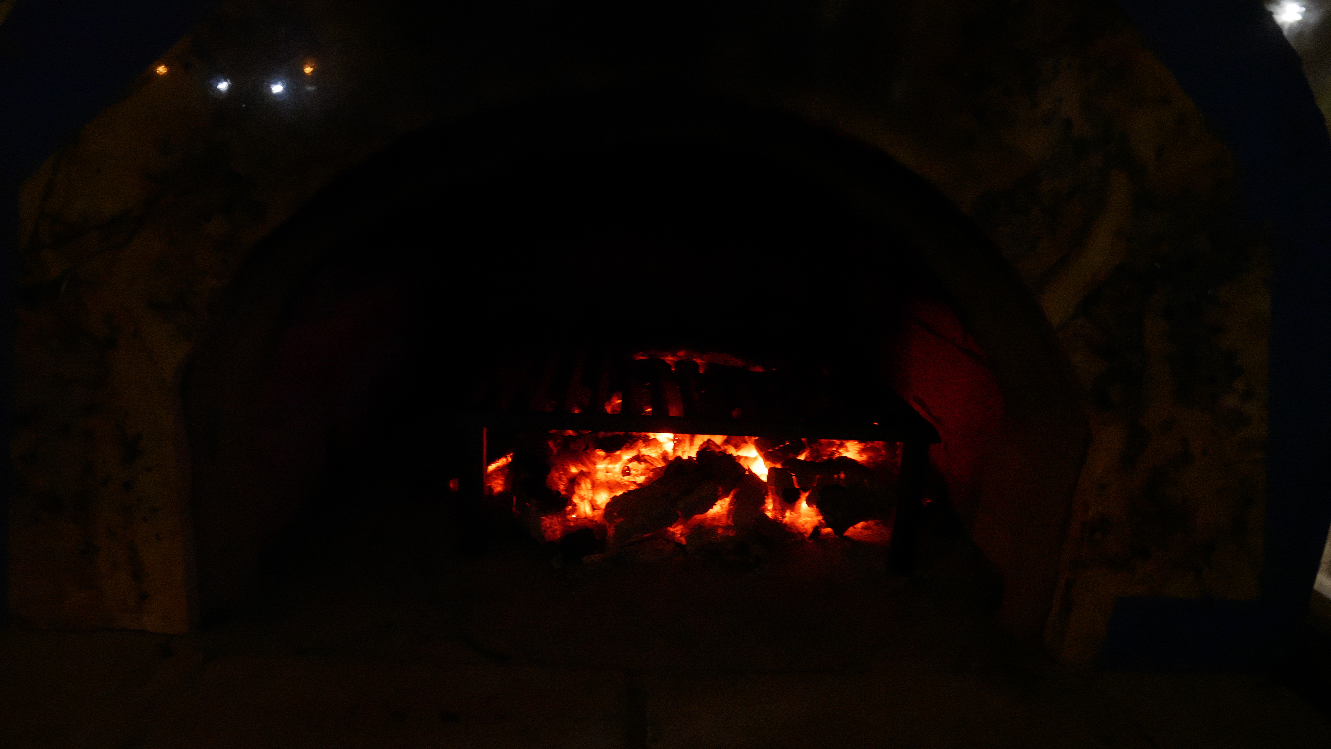

Finished my sixth and final curing fire! I could not let all those good coals go to waste…so I nuked a frozen brat and put in on the Tuscan Grill!! Cooked up in no time! While this is NOT the proper Wisconsin way to make a brat…it was rewarding as hell!! Gonna make some fresh dough for this weekend! Maybe pizza…or maybe sandwich loaves (with pizza dough)…saw it on Youtube…!! Woohooo!!! P.S. Mounting a light is a must!! Gotta see what’s going on inside my oven at night!
