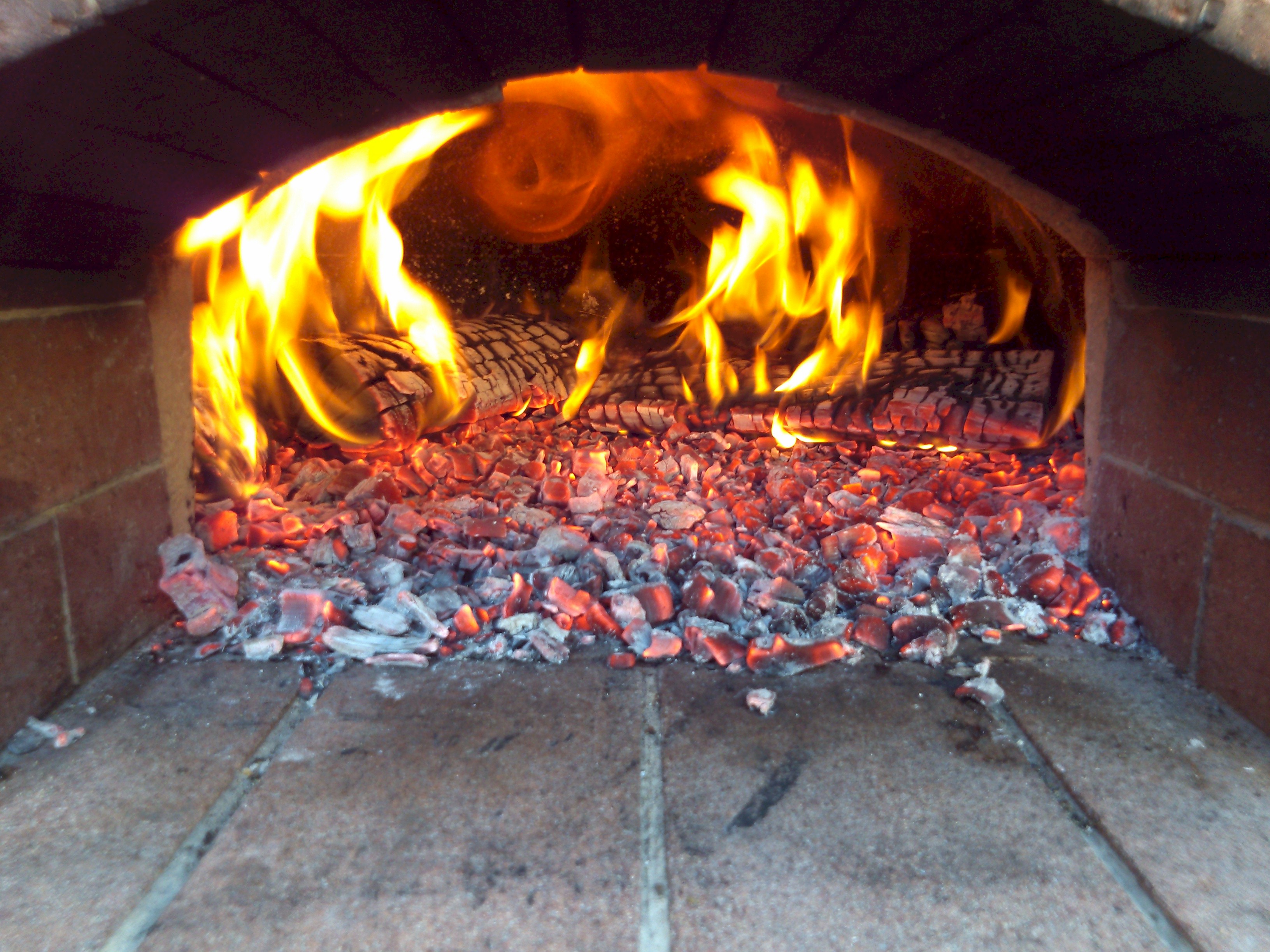

After you have started your initial fire and have a good 2 or 3 pieces of firewood burning, wait until those pieces start to char and burn down a bit. While your wood is burning, take a couple of minutes to spray or soak the head of your wood broom with water. Make sure it is thoroughly soaked.
Now head back to your oven, turn your brush head sideways (shake off any water) and beat the embers off the firewood and spread them in a circle. Blow on the fire / embers until they glow and add 3 more pieces of firewood. Grab a Diet Coke and wait about 10 or 15 minutes for this firewood to char. Once it looks like it’s starting to die down, grab the brush and beat the embers off the firewood. Again, spread them in a larger circle, blow the embers / fire to build it up and then add 3 more pieces of firewood.
You should be seeing a pattern now…
After doing this 4 – 6 times and your oven is at your desired cooking temp, break off as many embers as you can and spread the embers EVENLY over THE ENTIRE HEARTH SURFACE about 1” – 1.5” thick. Let these embers burn and glow for a good 10 or 15 minutes before you push everything to the rear or side of the oven… scrape the hearth surface clean of embers and ash… ADD 2 more SMALL pieces of firewood to the pile of red-hot embers and blow-off any ash that has landed on the hearth.
After some time has gone by, you may need to reheat the hearth (you can usually tell by pizzas taking longer to cook and/or not-so-crusty crust. Easy fix… pull some of the glowing embers back onto the hearth, add 3 or 4 pcs of firewood and let the fire roar once again! Once you are ready, repeat the Push, Add and Blow steps from before.
