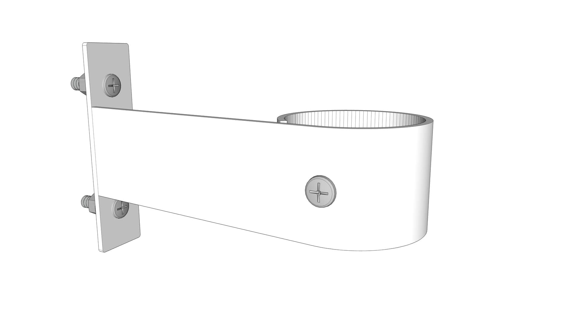

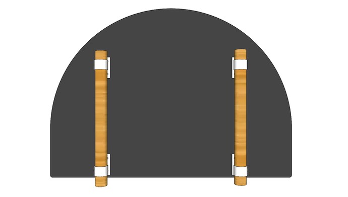

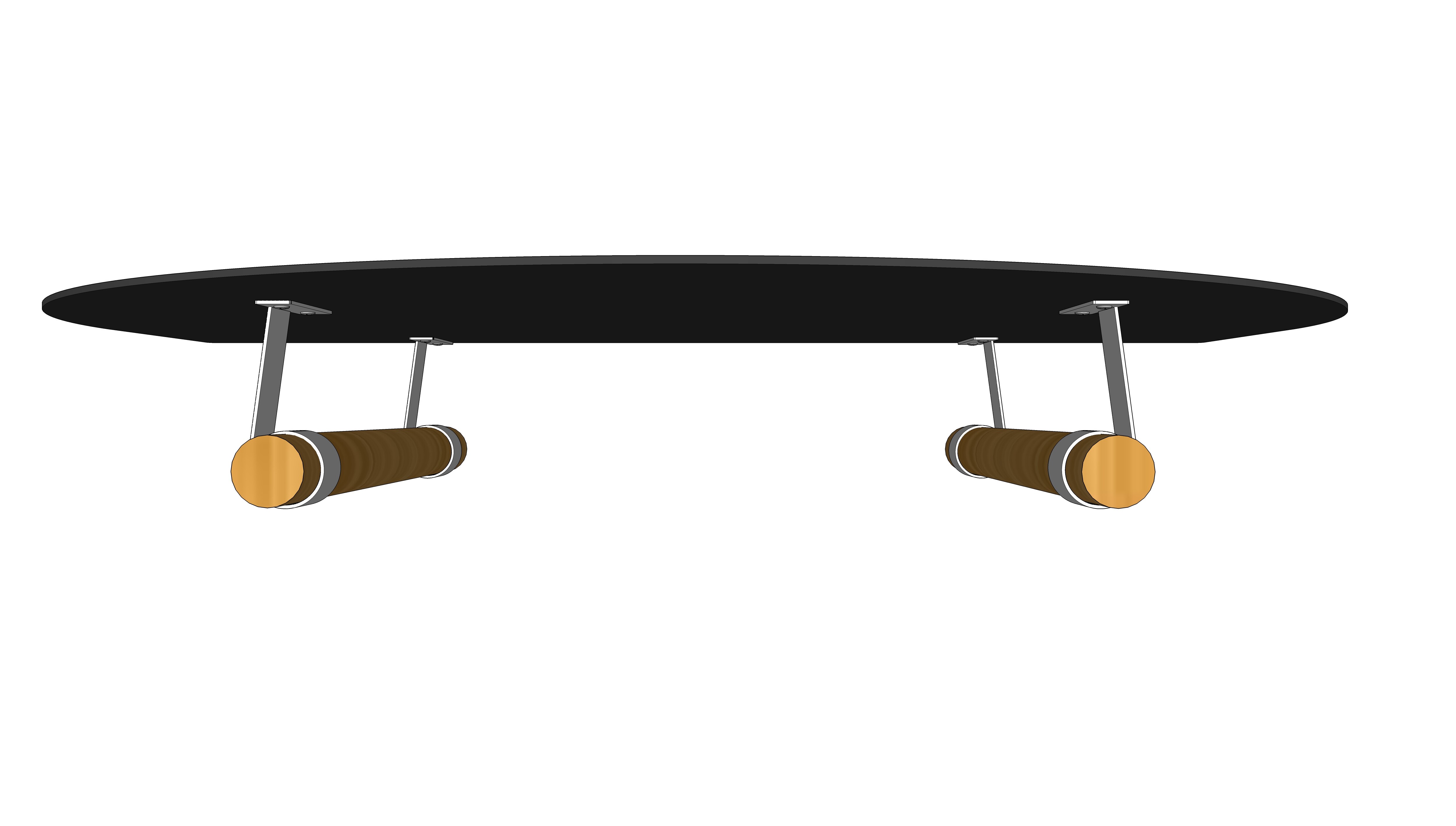

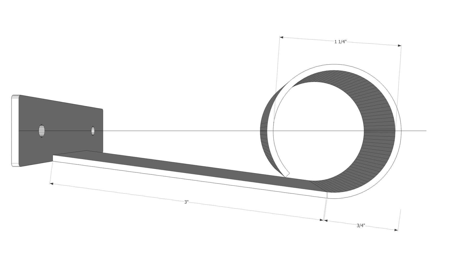

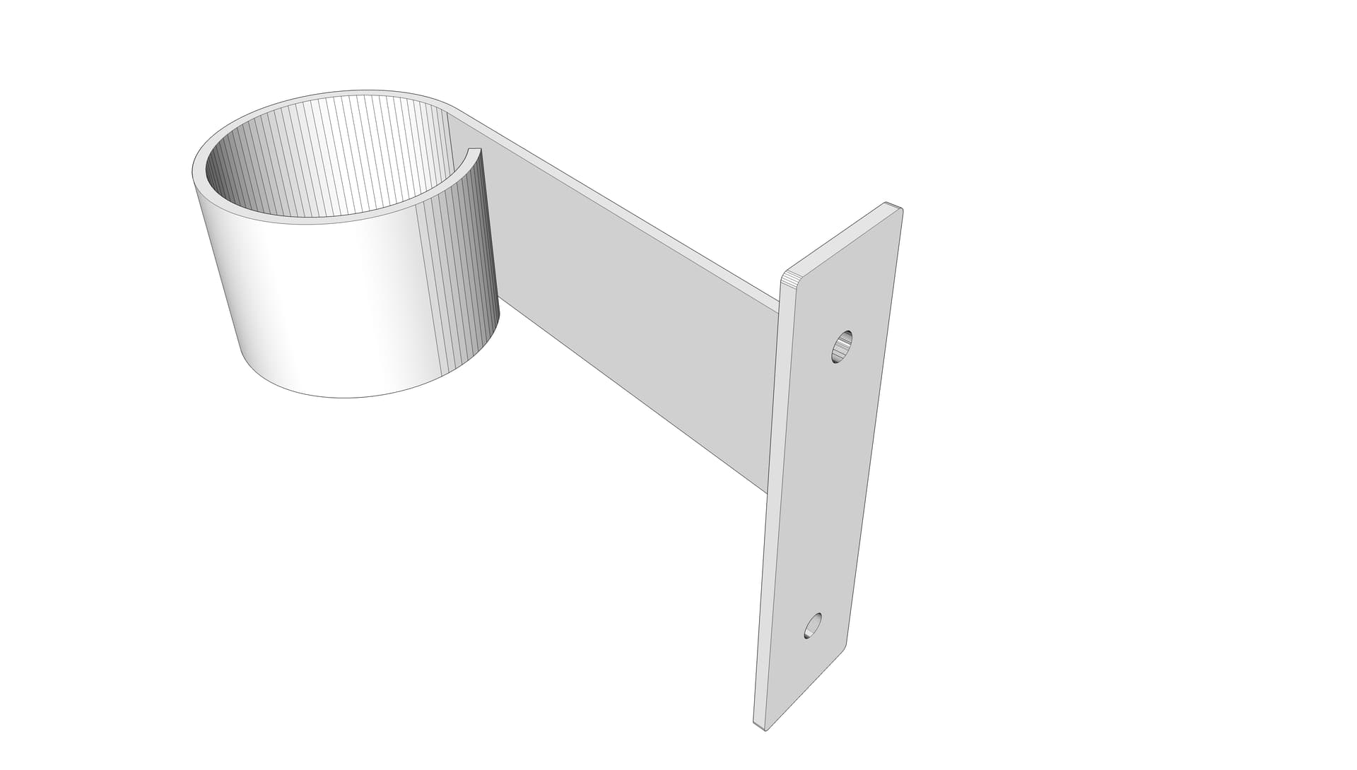

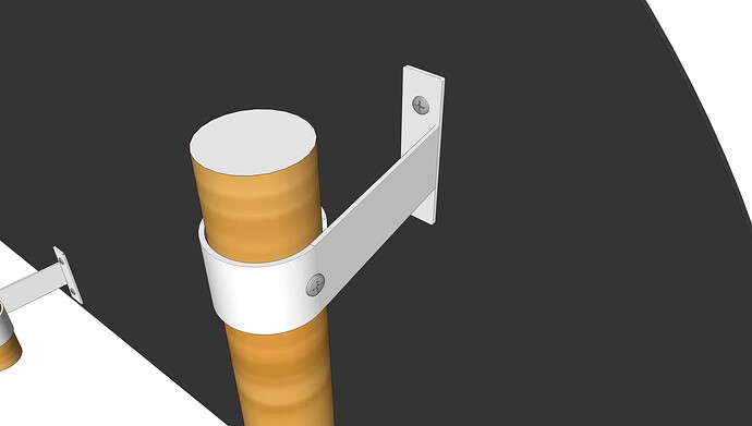

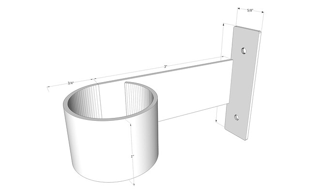

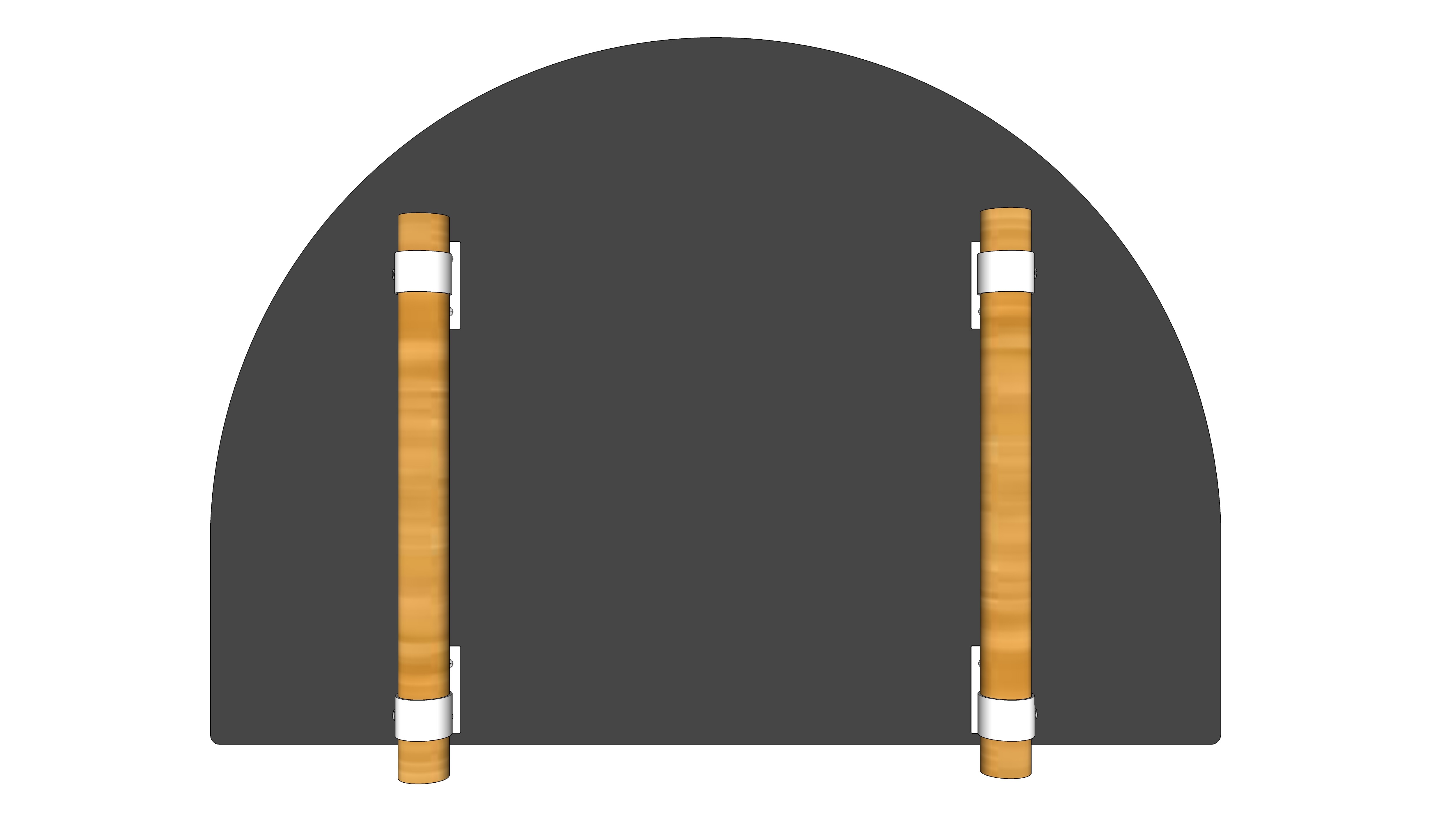

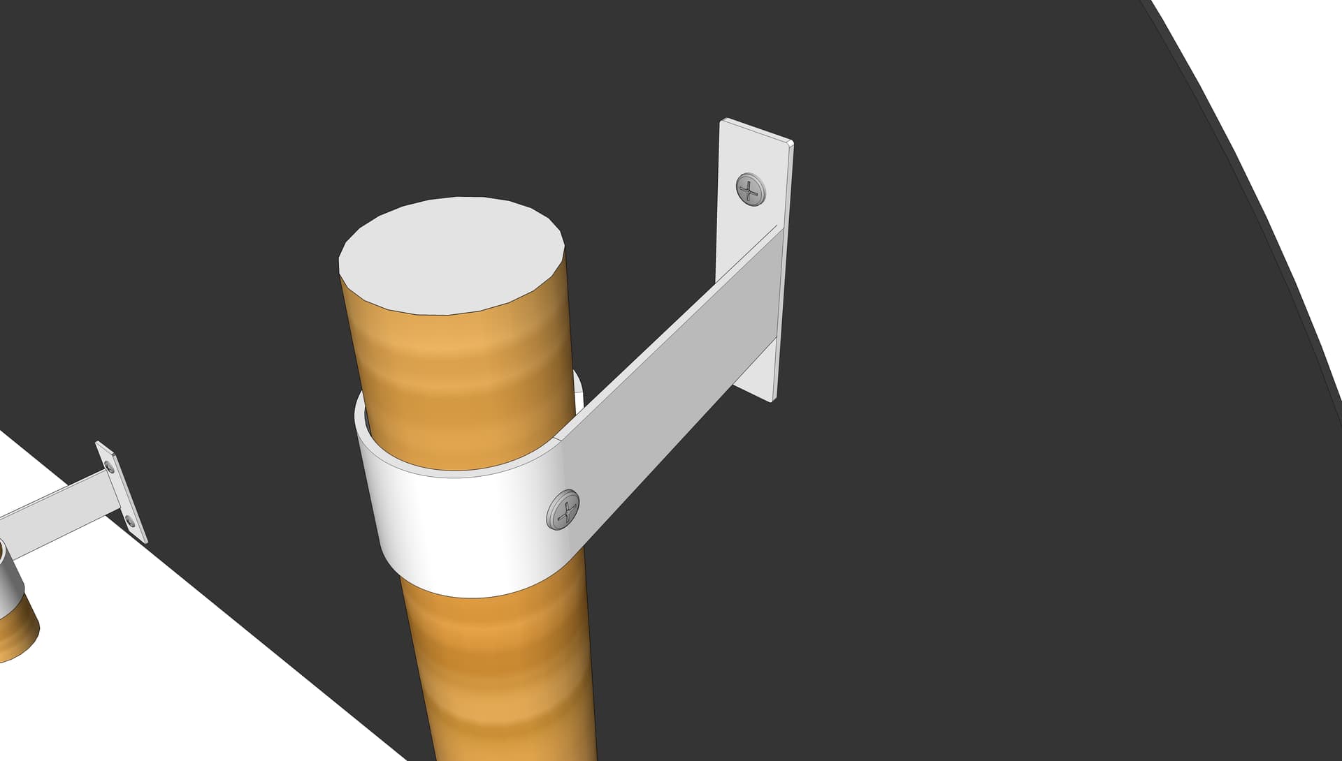

Here’s the design - I don’t have and ETA yet, but they WILL be fabricated in 2023.
IF YOU SEE ANY DESIGN ISSUES or HAVE A DESIGN RECOMMENDATION, PLEASE SEND YOUR SUGGESTIONS TO@BrickWood OR @bikerbudmatt
One other thought - could you widen the stock to match the holes in the door - so you could just bend 90 degrees and have the handle one contiguous piece, rather than a weld (it looks like) at the door?
@BrickWood has been mulling this as both a new product and a retrofit product. If you look again at his post, you’ll see:
Door handles have been on the burner, so to speak, for a couple of years. Every retrofit design up to now has run up against supply chain issues. It sounds to me like he’s found a way to meld design and materials.
No word on what a retrofit kit will include, but I know he wants to put in our hands everything that’s needed to make these handles look like they’re part of the OEM door.
Good idea. Looking at the design aesthetically, though, that might make the standoffs appear too “chunky”. More practically, it would take more raw metal stock to produce that, and I know one issue was the practical one of materials supply.
I’d be concerned about anything less than a continuous weld along that joint.
Definitely one to add to the “possible design issue” hopper.
Following up on your question about avoiding a weld, Don: I’ve confirmed with @BrickWood that the design is in fact a one piece part. He says it was just an artifact of the CAD rendering that showed it as 2 pieces.
