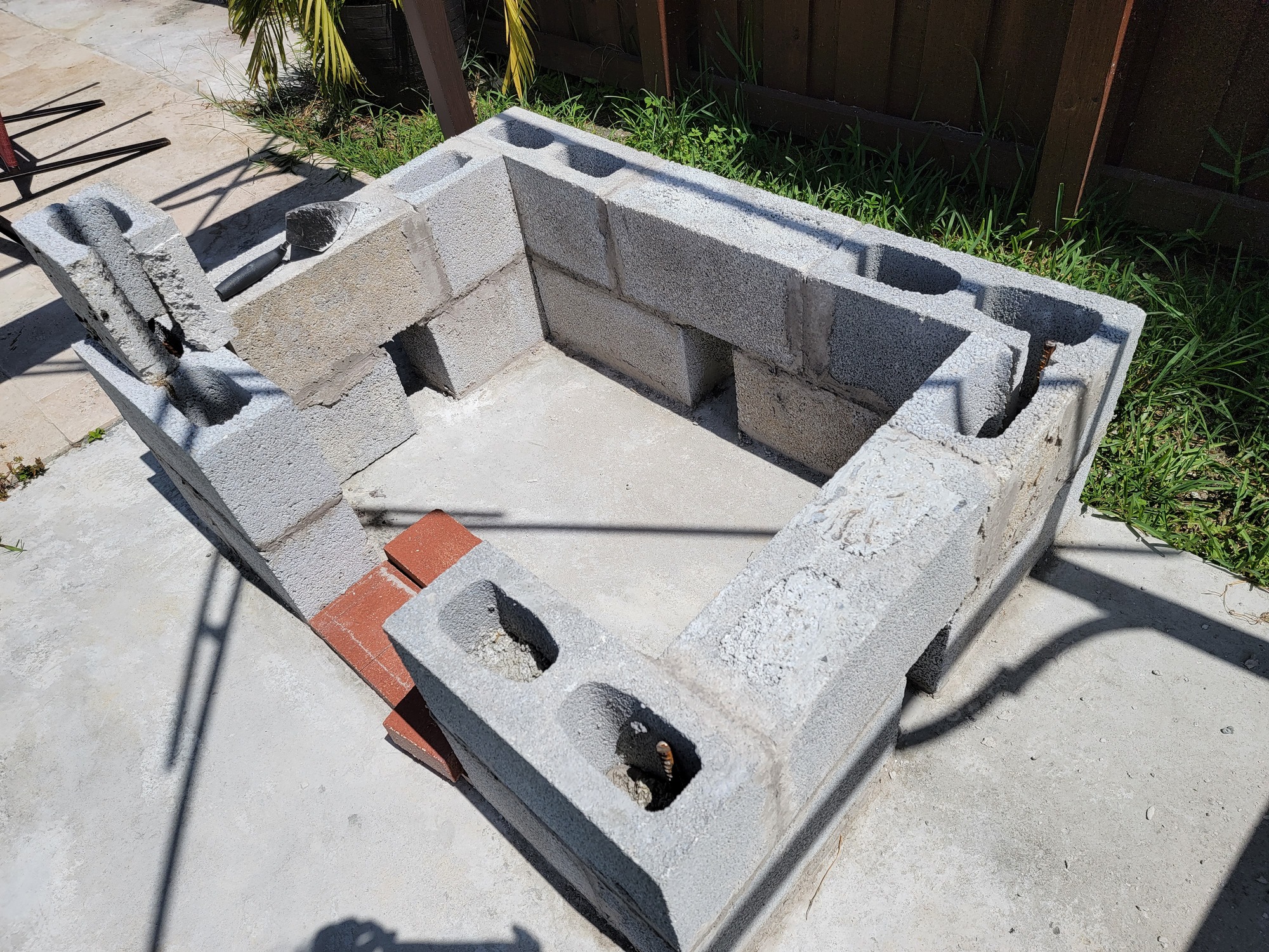

7/17/2021 - The second thing we did was to start to the actual box on the existing slab. We put the first row of cinderblocks according to instructions, piling the rows to the side first, marking the footprint of the cinderblocks, etc. We did not fill anything up, just used the mortar mix to put them in place.
7/18/2021 - We filled the first row of cinderblocks as needed and placed the second row of cinderblocks. Again, we did not fill them. Mostly because it took us a long time to put the rows and level them right, left, up, and down. The mortar flattens out with the weight of the cinderblock, and we needed to work slowly.
So far that is all we have done. We will be filling up the cinderblocks this week, some with insulation, some with concrete mix. After that, we will wait until we get the lower oven package because we will need to put the fireguards before we attempt to move the concrete slab onto place. I have not yet figure out how we will lift that heavy thing from the garage.
