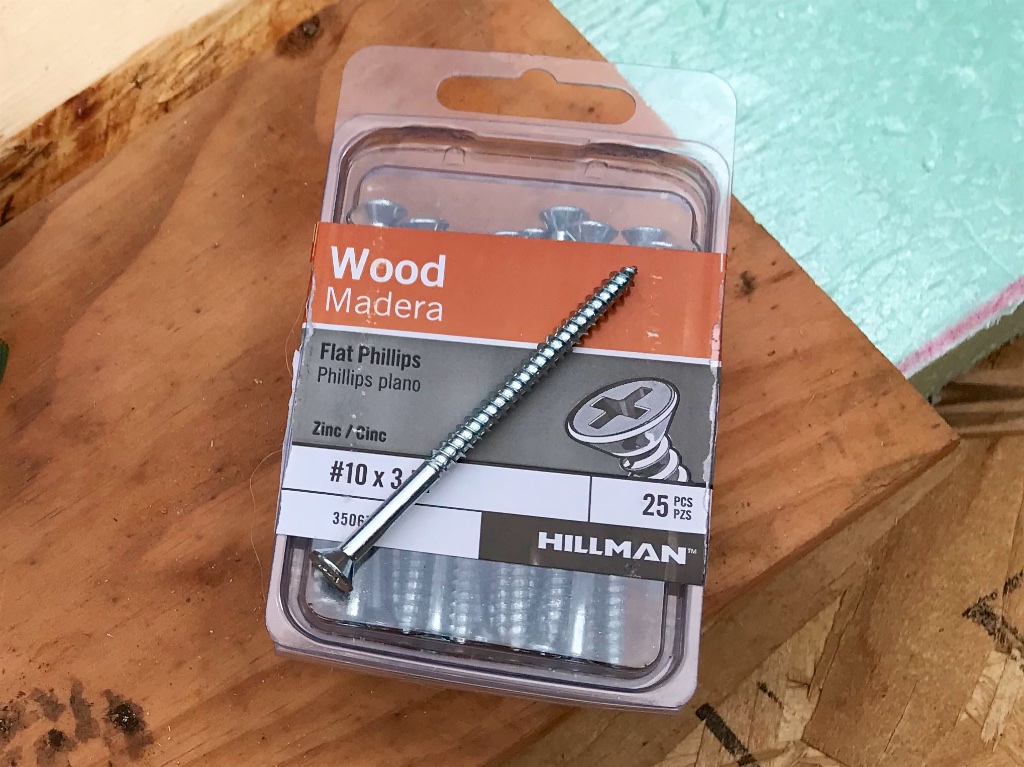

The wood screws you’ll find in the “wire goods” aisle at the big box hardware store look like they should do the job. They’re chrome-plated, they look hefty, and they even have a nice deep Phillips head.The problem is, they are not meant for being applied using a drill, at least not without pilot holes. They’re serviceable for a few things, but building a concrete form is not one of them. Also, they’re expensive. Johnny Homeowner (that’s me!!) pays through the nose for that pack of 25 wood screws.
