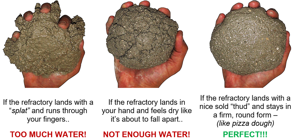

When you look at that FAQ, the photo shows the refractory being held by a bare hand. Brickwood has said in the past that the photo is for illustrative purposes, and refractory should be handled with gloved hands only (whether or not the stainless steel fibers have been added—they would only make it worse!).

Additionally, it’s considerably easier to gauge / judge the amount of water you add to the refractory as you mix the refractory w/ COLD water. And refractory needs VERY LITTLE water… just enough to pass the Ball in Hand method.
Here’s a great article about mixing Castable Refractory w/ Fibers & water…
