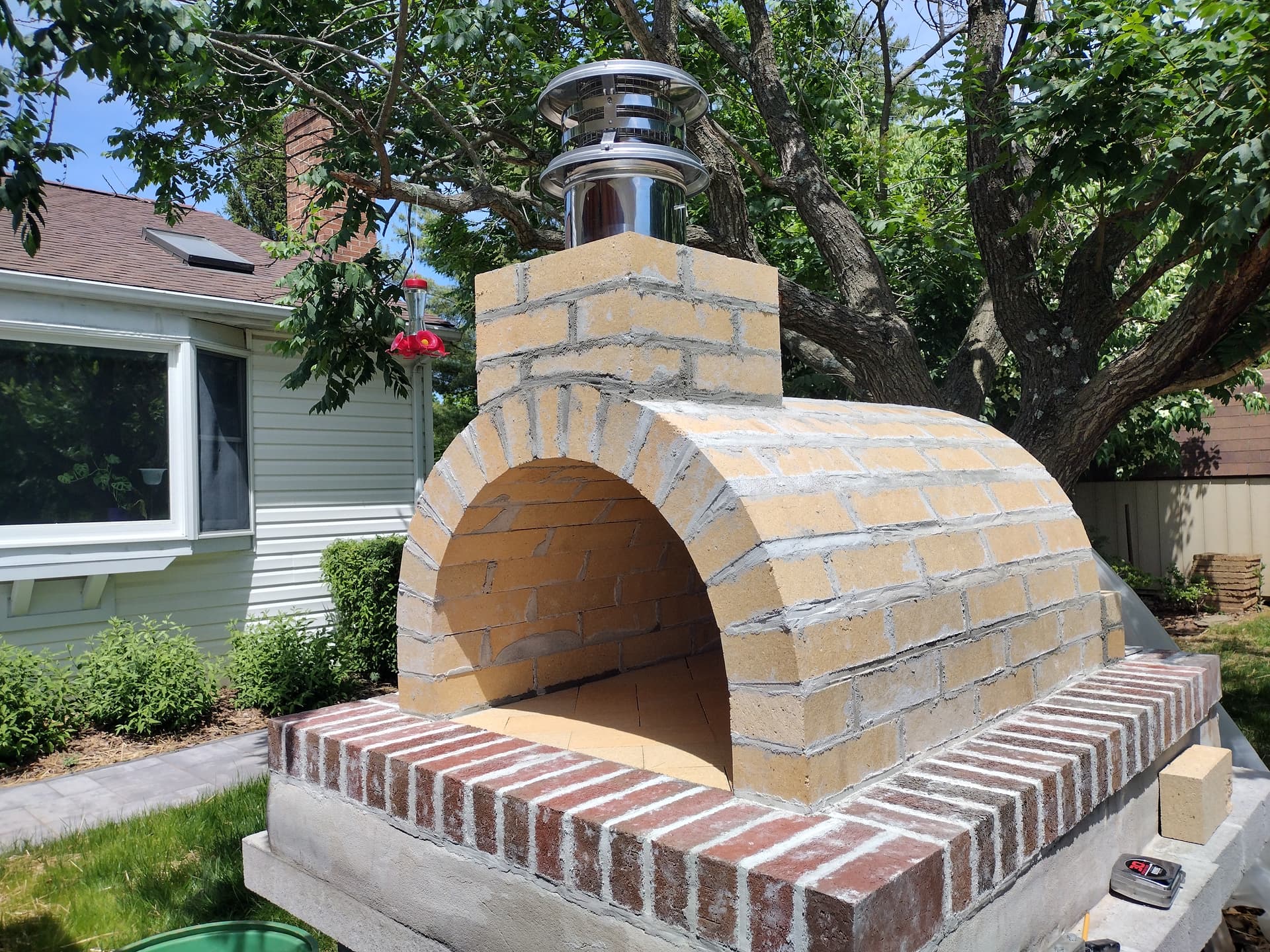

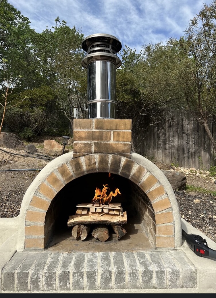

Many of us just used mortar to level the first chimney brick. I tried shaping bricks with a grinder, but was not happy with the results, so i just used the full brick. When you wrap with insulation and stucco, the effect goes away. I also added another chimney course on top - I just like the look better…![]()
