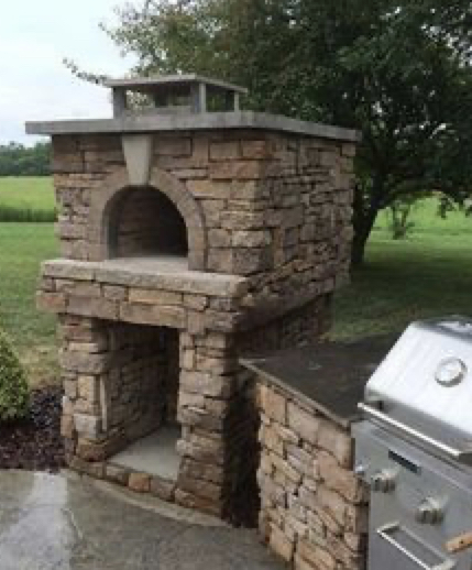

I plan to have a closed top like the attached photo. After insulation blanket, can I fill the void of space with a sand and vermiculite dry powder mix before sealing the top? Any advise is appreciated.

The vermiculite does not sound like a terrible idea because it’s so light. It could create some problems if the weight gets up there.

I would recommend that you still do the wire lathe (chicken wire) and stucco shell. The idea is to protect your mineral fiber insulation, no matter what else you build over it. While the vermiculite mix is an interesting idea, and it might take a little weight out of your fill mixture, I don’t think it adds anything in particular to a sand-based fill.
However, if you instead filled the space with Vermiculite OR Perlite, that would fill the space and add practically no weight at all. Another benefit would be that the granules are bigger than sand, so no chance of seepage through cracks.
Since much of the area is taken up with the oven itself, my very rough guesstimate is that 4 to 6 cu.ft. of the material would be enough.
