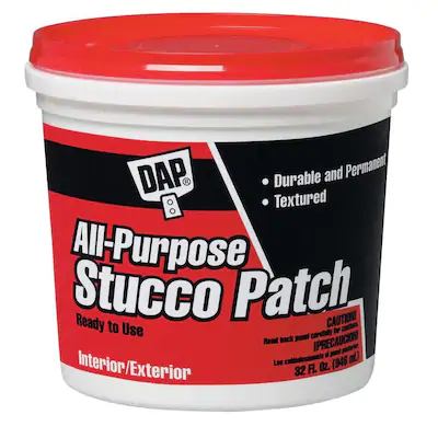

Before you seal the outer shell w/ veneer, organic water-sealant or with several layers of exterior paint, you will want to patch those hairline cracks. Grab 2" putty knife - and follow the printed instructions on the back of the container…
The DAP All-Purpose Stucco Patch is available at almost every hardware store on earth.
