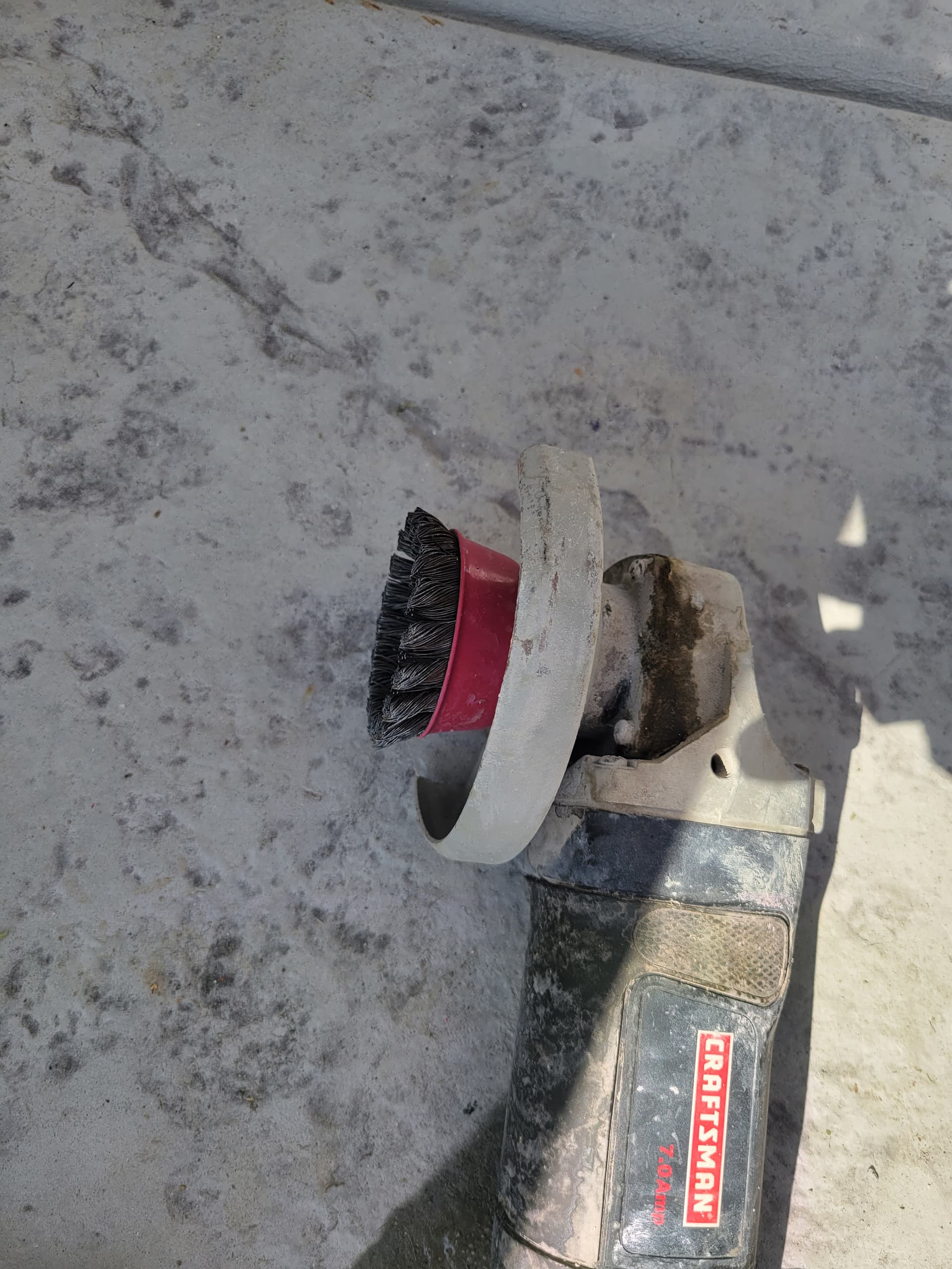

Congratulations on getting your bricks done! There are different thoughts on this subject. One is, leave it, you won’t be able to see it after you do some fires. I chose to use a angle grinder and a wire wheel to “softly” wear down the mortar. I caused no damage. There is still a little excess mortar but i am happy with it. It is a personal choice in my opinion.
