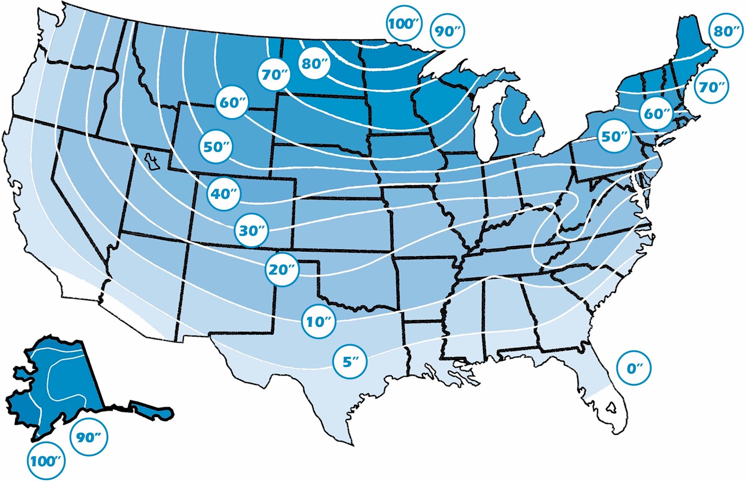

The depth of your frost line varies in different parts of the country so you will need to consult with a local structural engineer or see if you can find your city’s frost line requirements on the Google Machine. You may live in a city, town, village, county or state that REQUIRES all structures be built to the frost line.

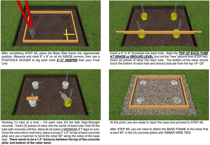

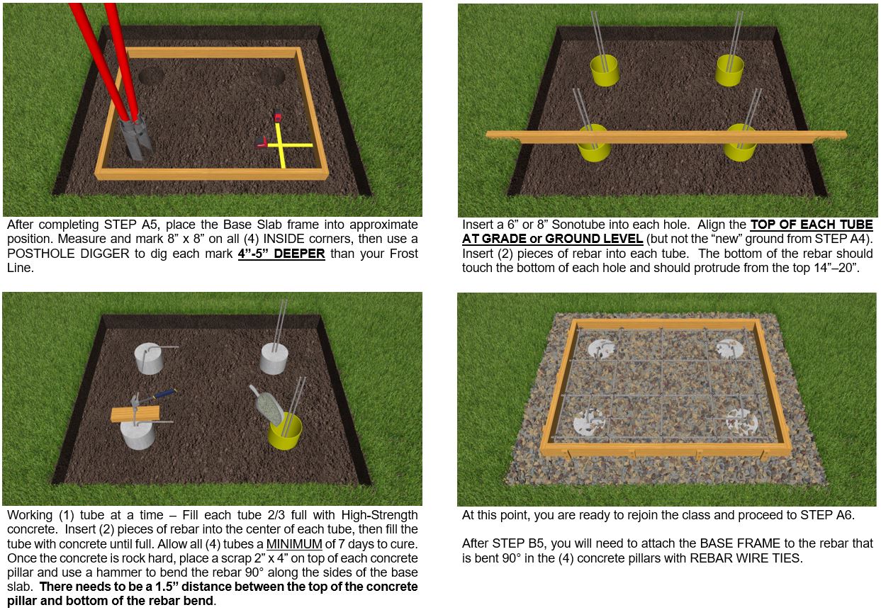

If you choose to build your BrickWood Oven or BrickWood Box base to your regional frost line, the diagram below shows you how to easily adjust your base slab. The following materials ARE NOT ON THE MATERIALS LIST – you will need to calculate and purchase these items separately. For EASY math calculations, jump on WolframAlpha.com. It’s like Google for math!
The image below is for the BrickWood Box / Frost Line installation.
