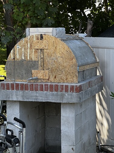

I was also afraid of losing the shape of the oven. The fiber blanket offers no structure. The chicken wire after twisting , turning in excess wire made for an in even surface. I wanted a well constructed look rather than a rounded hand crafted dome with uneven surfaces. I came up with a wood construct to insure the dome was a perfectly symmetric rounded structure.

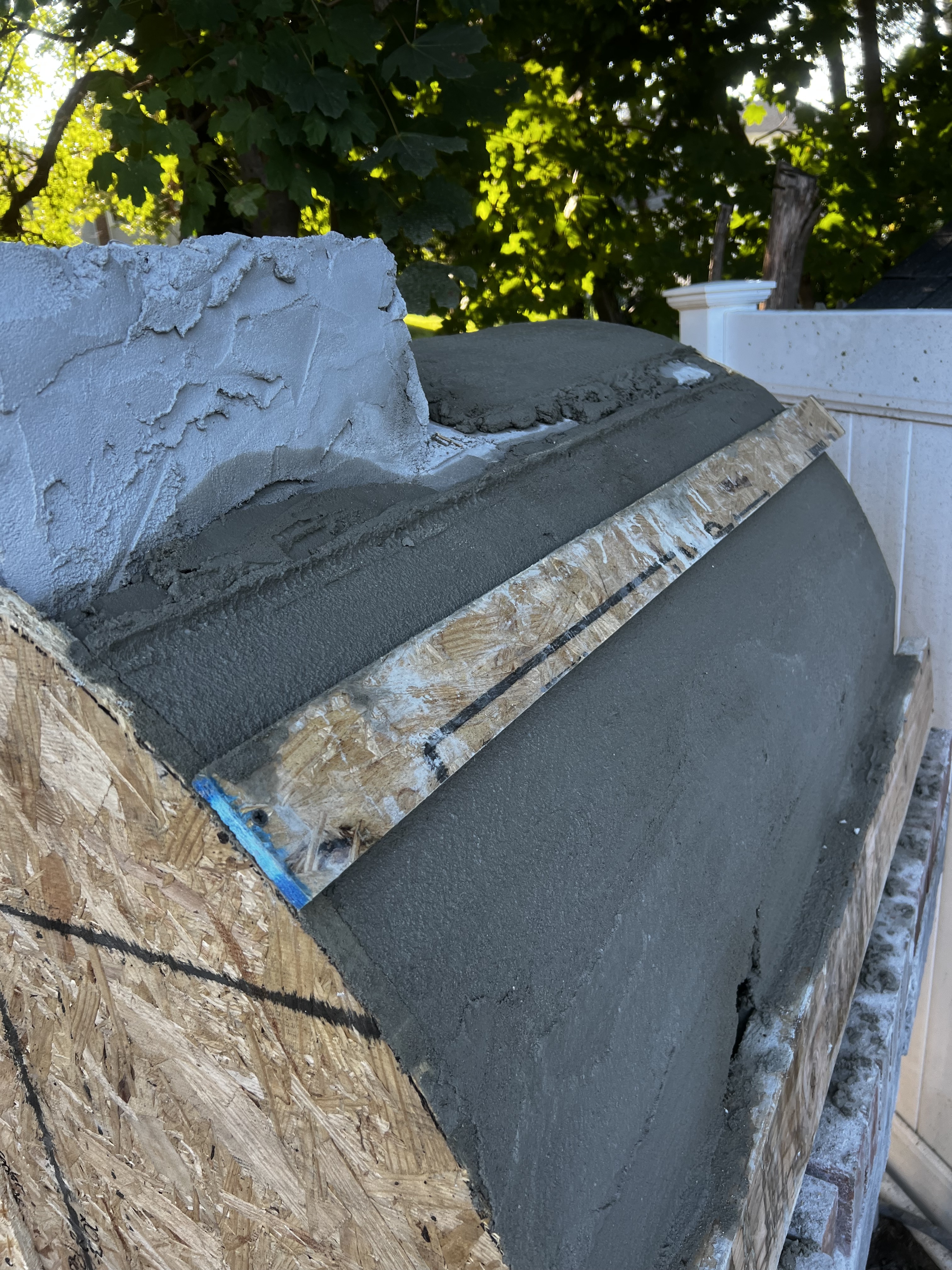

First calculated radius of circle needed then cut a board to match the shape. Connected front and back by thin strips of wood. Used 2x4 of appropriate length to level the mortar on the oven.
Once dried I replaced the wood forms with a second set that was 1 inch larger radius. This would add exactly one inch to the mortar thickness on the chicken wire. The first layer flattened the surface. The second layer made it exactly the shape I’d planned. I moved the supports to a different location and filled the areas blocked by the previous supports.

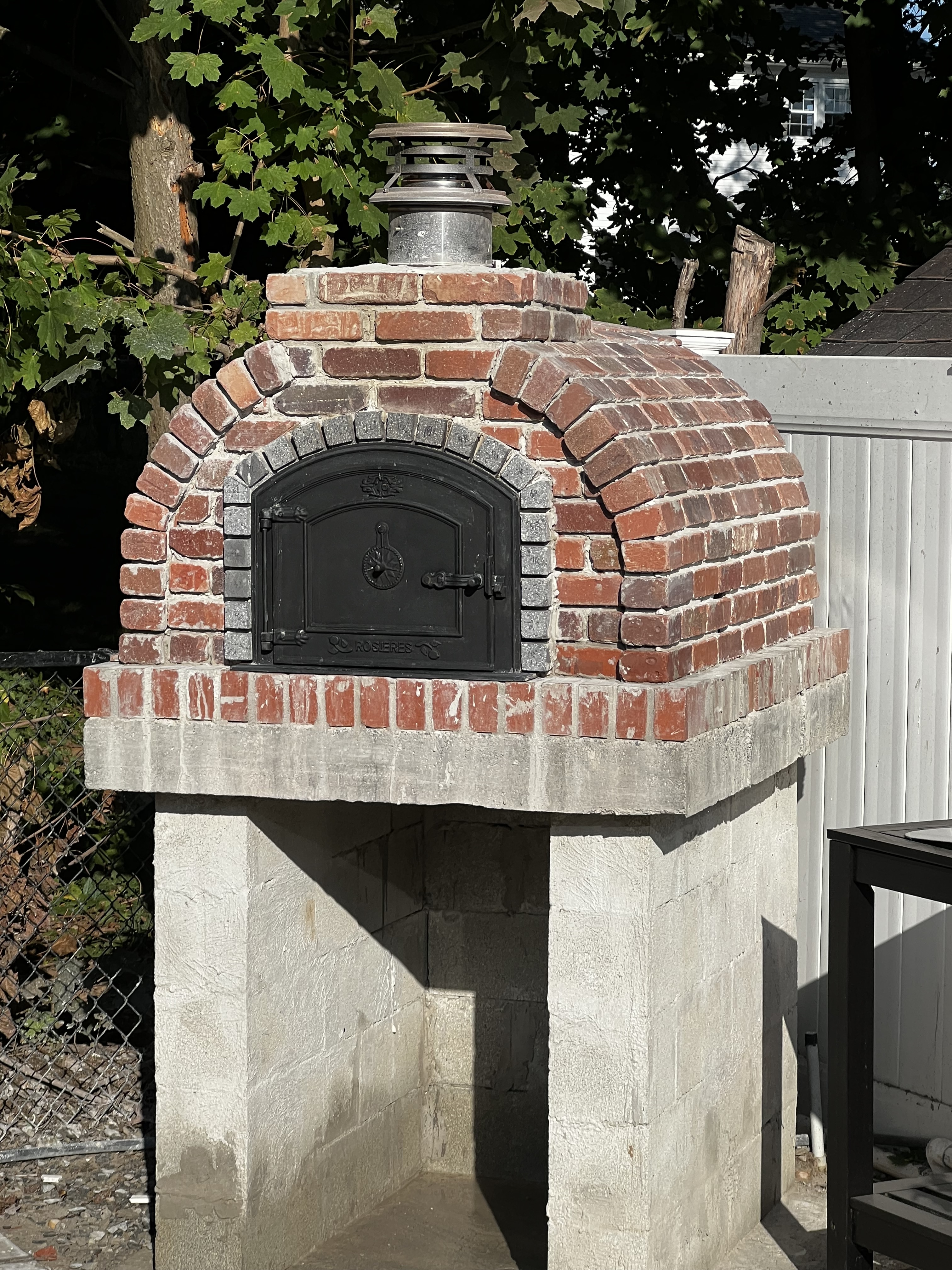

After drying the remaining surface blocked by the 4 inch supports was filled and leveled by hand. Now that I had my perfect shape, I chose to use thin brick veneer.
