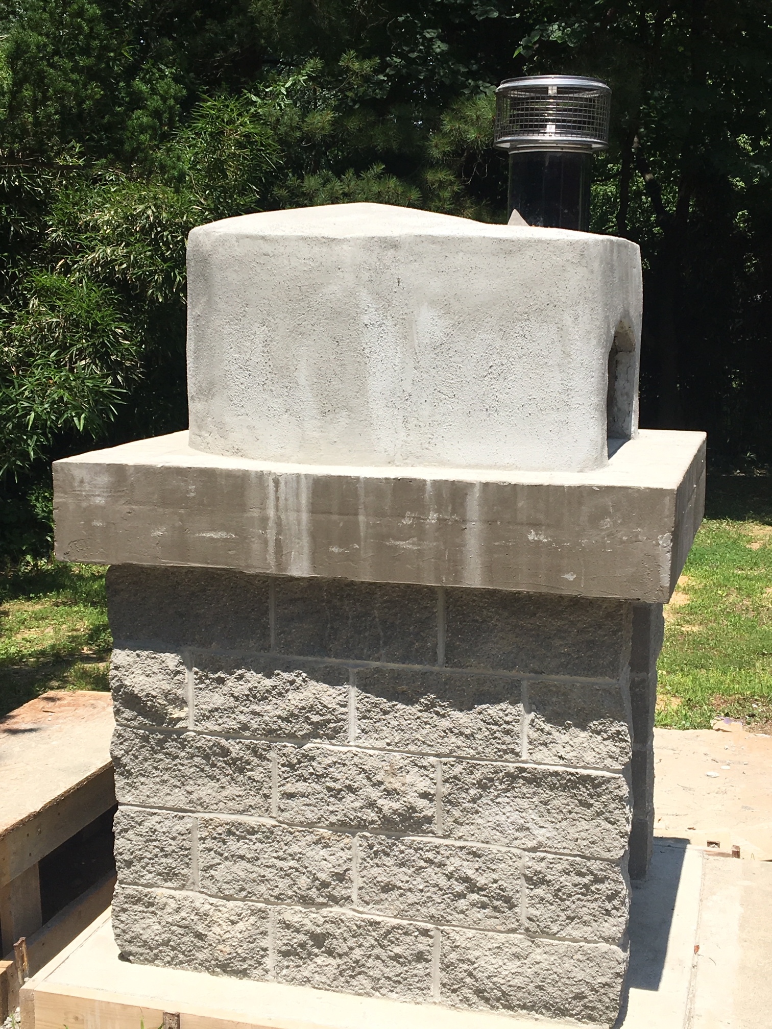

Beautiful job on your 28" Mattone Cupola pizza oven! You are just about to wrap up what looks to be an AWESOME oven! Nicely done w/ the stucco work and LOVE the split face block on your oven base!
And BikerBudMatt is correct - So all we can add from our end is:
The hottest part of the oven that concerns me is the chimney / exhaust area… and the oven opening area. They are both subjected to an intense amount of heat and this might affect standard tile mortar. I don’t know if they make a high-temp mortar for tile - I’ve never seen it, but I would suspect that you could use standard high-temp mortar / pre-mix like Ovenzz Mortar (15lb pail) on the tile (but keep the joints thin).
Make sure ANY mortar or adhesive you use is NON-WATER soluble. If you get water soluble mortar, it will crumble when it gets wet. Guaranteed.
Heat may affect the glaze on the tile or glass. I don’t believe glossy / glazed finishes fair very-well in high-heat environments.
That’s 3 points to consider from our end…
