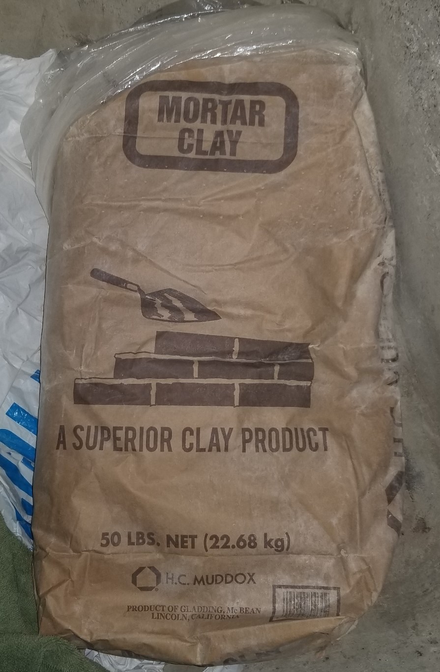

I want to make the high temp mortar mix 3:1:1:1.
This is what the masonry store stated will work as fire clay. Is this ok to use?
From what I’ve read a lot of people have used the H.C. Muddox clay successfully. It’s even shown on the Brickwood materials picture gallery elsewhere on this site so I think you’re all set.
I’ve read on some sites that they suggest you can go outside and dig your own clay if you know what you’re looking for. I’d stick with the bags though…
BTW. Welcome to the forum.
-K
Thanks for your response. The bag of HC Muddox I saw on the picture gallery had (ceramic material) written on it but can’t find anyone who sales it. I will take your advise and use the one in the above picture. Thanks for your help.
