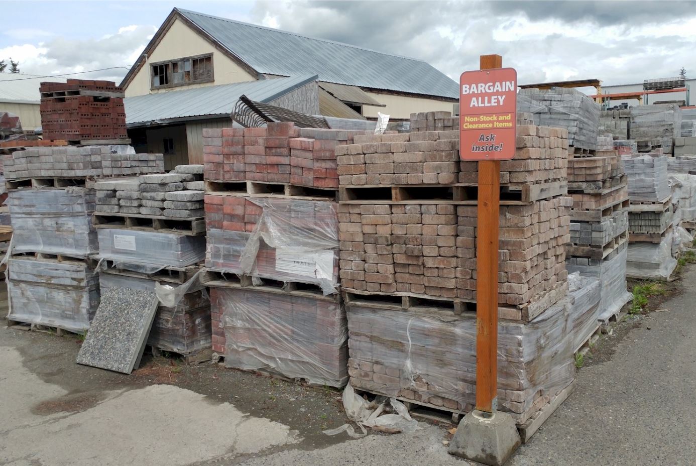

True Story – I took my wife veneer shopping at our local masonry supply and asked her to pick the veneer for a BrickWood Box that I was building at our new home. After searching and searching through a large number of styles and colors of veneer, she just couldn’t find what she was looking for. She explained to the sales rep exactly what she wanted and he guided us to their “Bargain Alley” – a place where unwanted brick and block are placed on clearance. After climbing over several pallets of brick, my wife found her gem… a single pallet of dirty, filthy and muck covered black brick with a very unique texture. The only problem, these were not veneer – they were full size brick.

This pallet of beautiful black “Clicker” brick was hidden by other pallets of brick on clearance. After a little scrubbing, the brick showed its true beauty – a deep semi-gloss Black with touches of Silver.

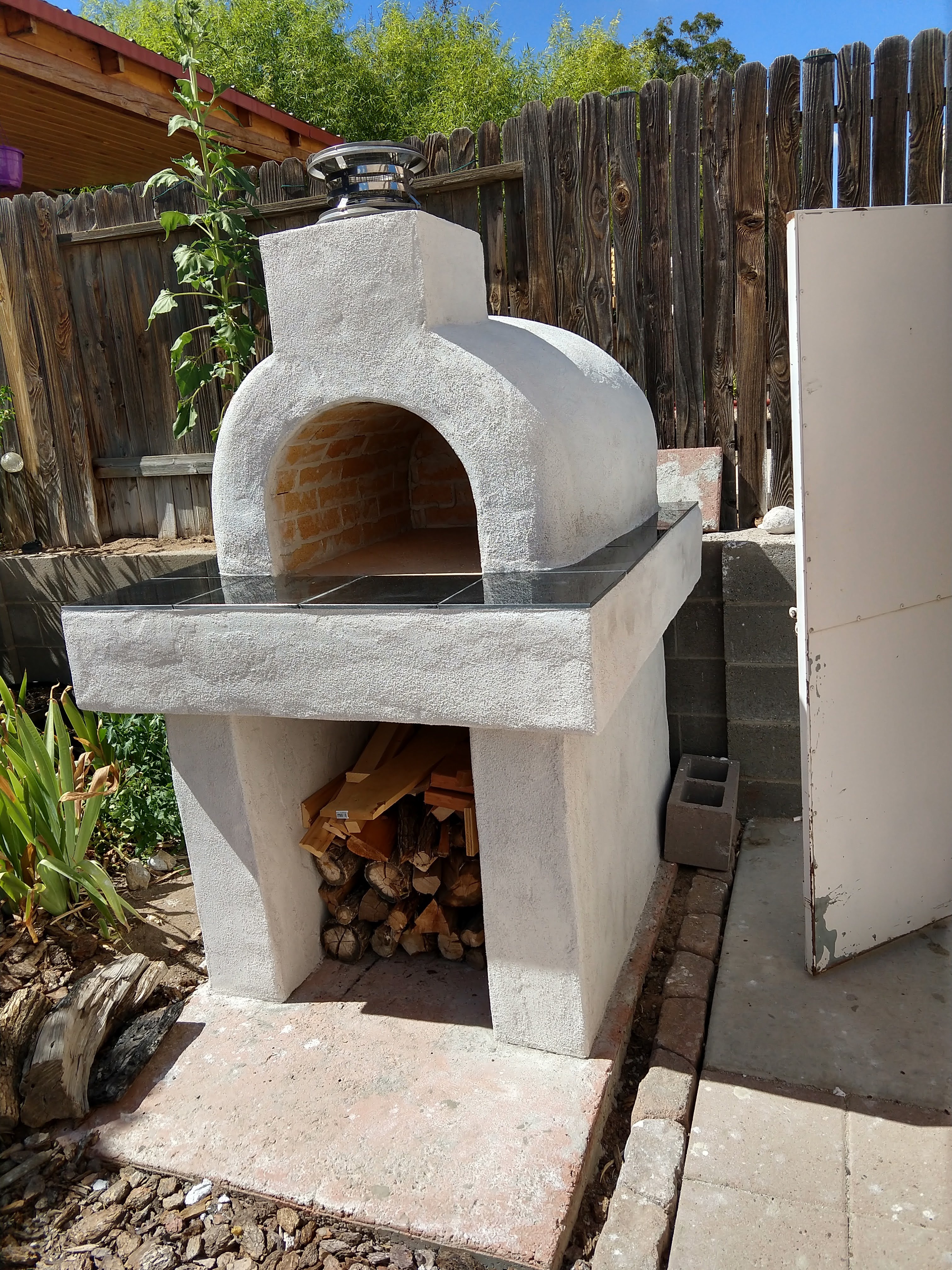

I used a nice worm-drive circular saw with a masonry blade for most straight cuts, and a grinder with a masonry blade for the tough stuff and to clean up my bad cuts when halfing bricks. A grinder with the safety guard is amazing for sculpting and cleanup of bricks, tile, mortar, cement…whatever. Just make sure you get a couple of masonry or multi-purpose blades because once you dull one…it flat out doesn’t work, while a new one will but like butter. The grinder was REALLY helpful with chimney cuts, and granite cuts (counter-top).
WOW, Carlos! That structure is beautuful! Nice job!!
Knew you were bringing great skills, but that really does look beautiful. The granite is a gorgeous touch.
That’s the beauty of that tool, and thanks for mentioning the safety guard. I am concerned about folks who are tempted to work without it. One shard of stone or brick propelled by that blade would do a life-threatening number on your body if it lodged in the right place.
Thanks for sharing your photo!
