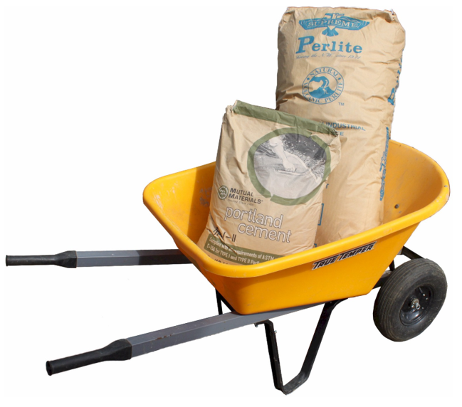

How to Mix the Vermiculite / Perlite and Portland Cement Insulation Blend -
VERMICULITE or PERLITE and PORTLAND CEMENT – Dry Mix 5 parts Vermiculite or Perlite - to - 1 part Portland Cement in a Mixing Tub or Wheelbarrow - (5 Gallons / Shovel - to - 1 Gallon / Shovel). Add just enough water to get the entire blend wet as you mix with a shovel or hoe (hoes are good for this process). DO NOT OVER WATER! There should be ZERO water puddling! Average drying time is about 5 - 6 days.
