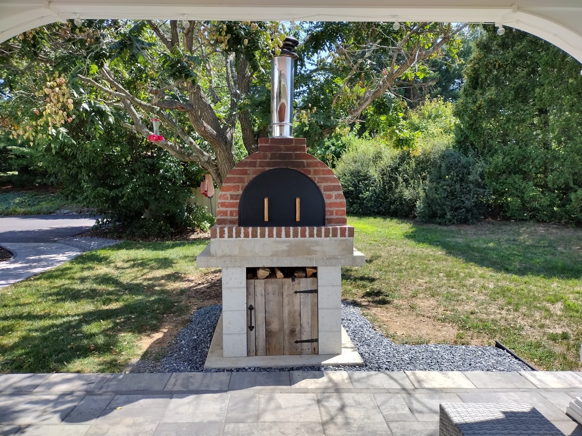

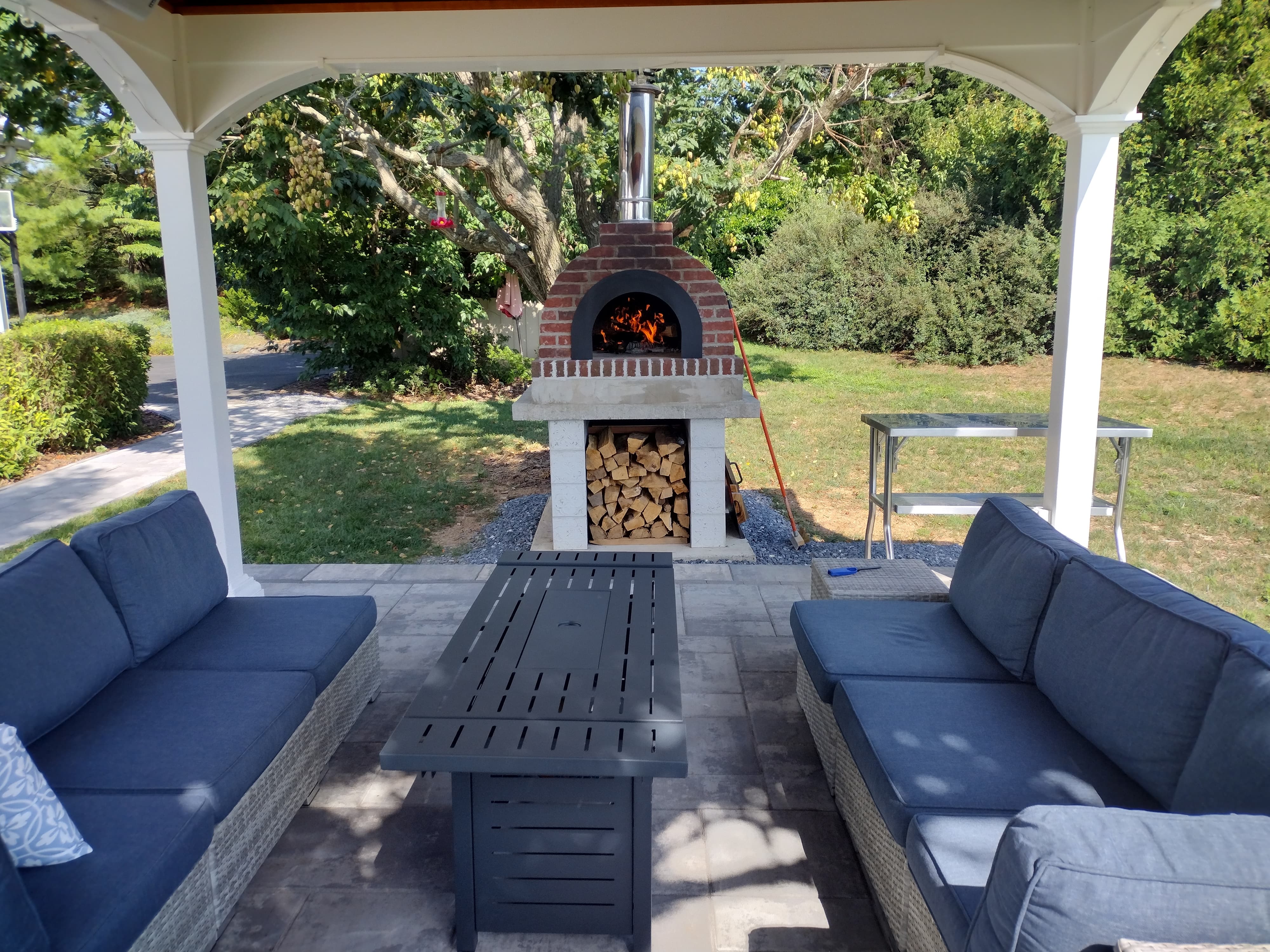

I think I am finally (really) done building my oven. My final tweak - I used wood from one of the pallets that was used to deliver the bricks for the oven to make a faux door. $5 fake hinges and door handle from Amazon. It keeps the wood dry but still lets me stow my peels on a shelf that I installed in the back of the pedestal.

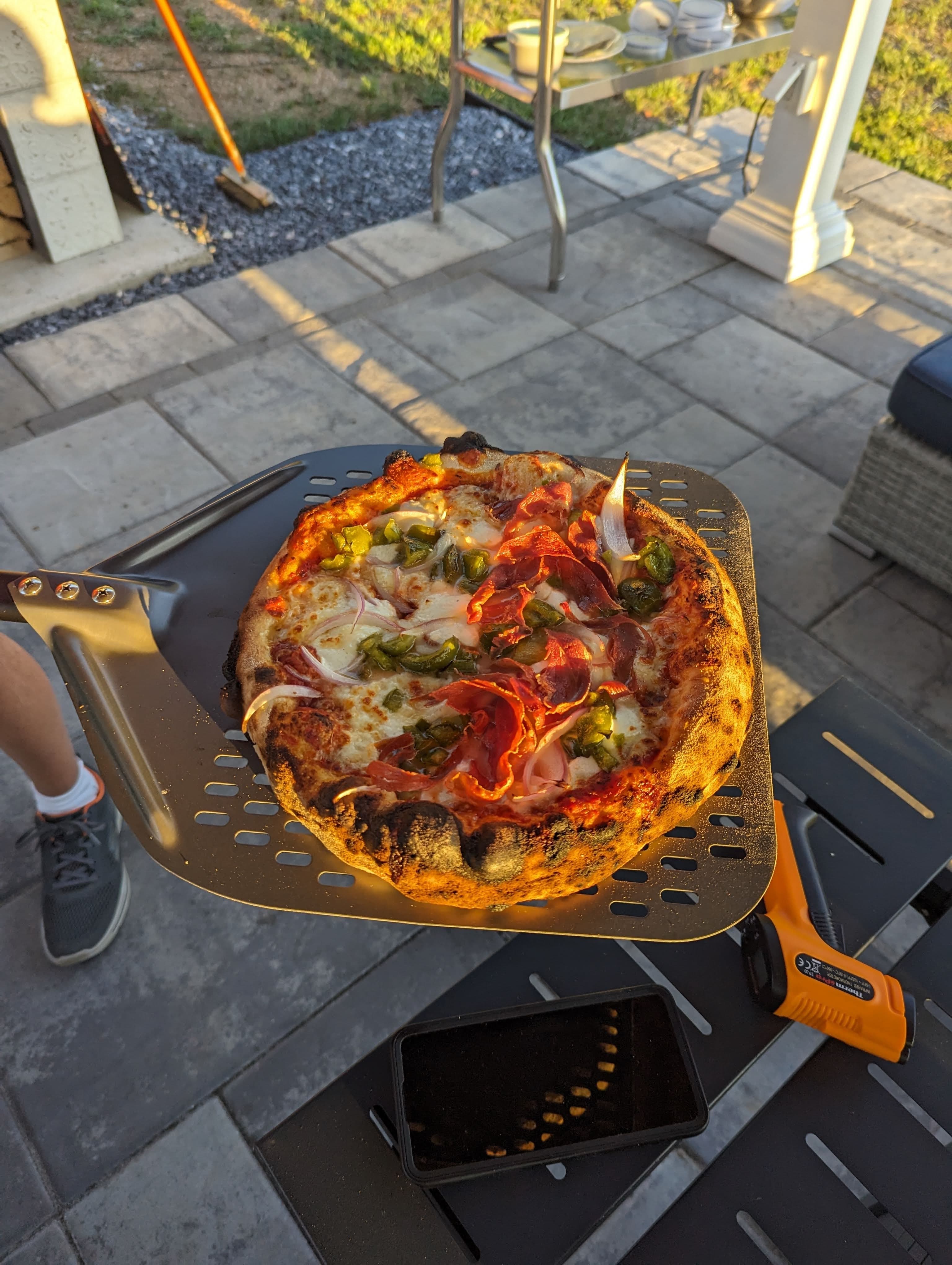

My pizza making skills are a WIP, still trying to get a consistent dough. I always seem to burn the initial launch side facing the fire, maybe too close to the fire?

tip build the fire in the center then push it to the back, saturate the floor in the back half of the oven with the red hot coals, then push the fire to the left. At that point the roaring fire is flaming left to righ in the oven. Clean the floor and cook the pizza in the right back side of the oven
The deeper in the oven you can get it the better the pizza will be
That is my preference
Thanks very much for the tips. I have been making the fire in the middle, pushing it to the back then making the pizza in the middle. I find that it’s hard to see if the crust is burning since the fire is at the very back of the oven. I’ll try your method next.

You’ve got the basics down; now it’s a matter of timing and feel. Whether you continue to push the fire all the way to the back (my preference) or go with @Dinovmakingpizza ’s method of pushing it to the side, which I use for roasting but have also tried for pizza—the key is to get your hearth very, very hot.
With a properly fired oven, as you seem to have, the total baking time for a pie is under 5 minutes. That means your first turn is coming pretty quickly, about a minute or so into the bake, and you have to stay on it.

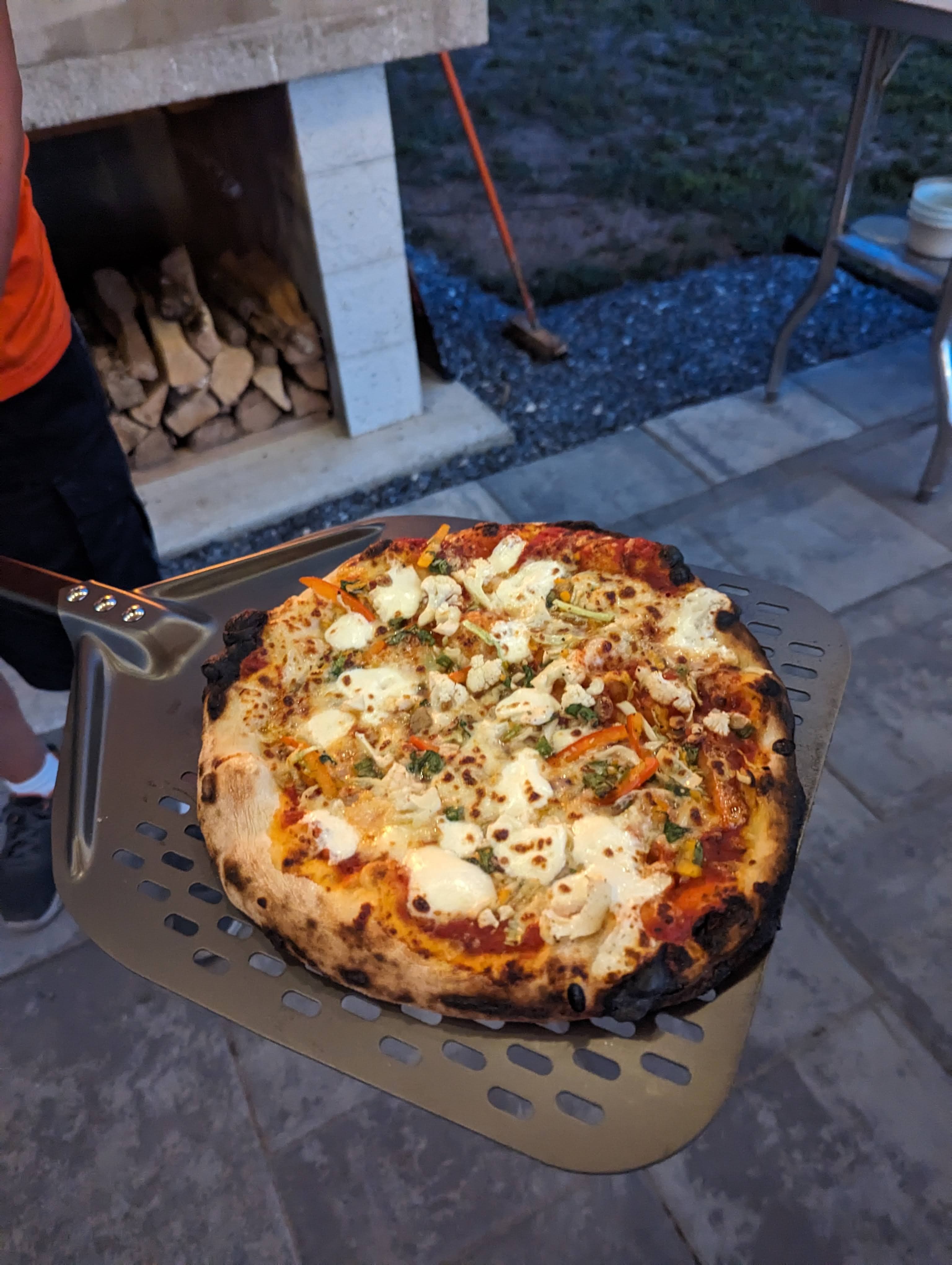

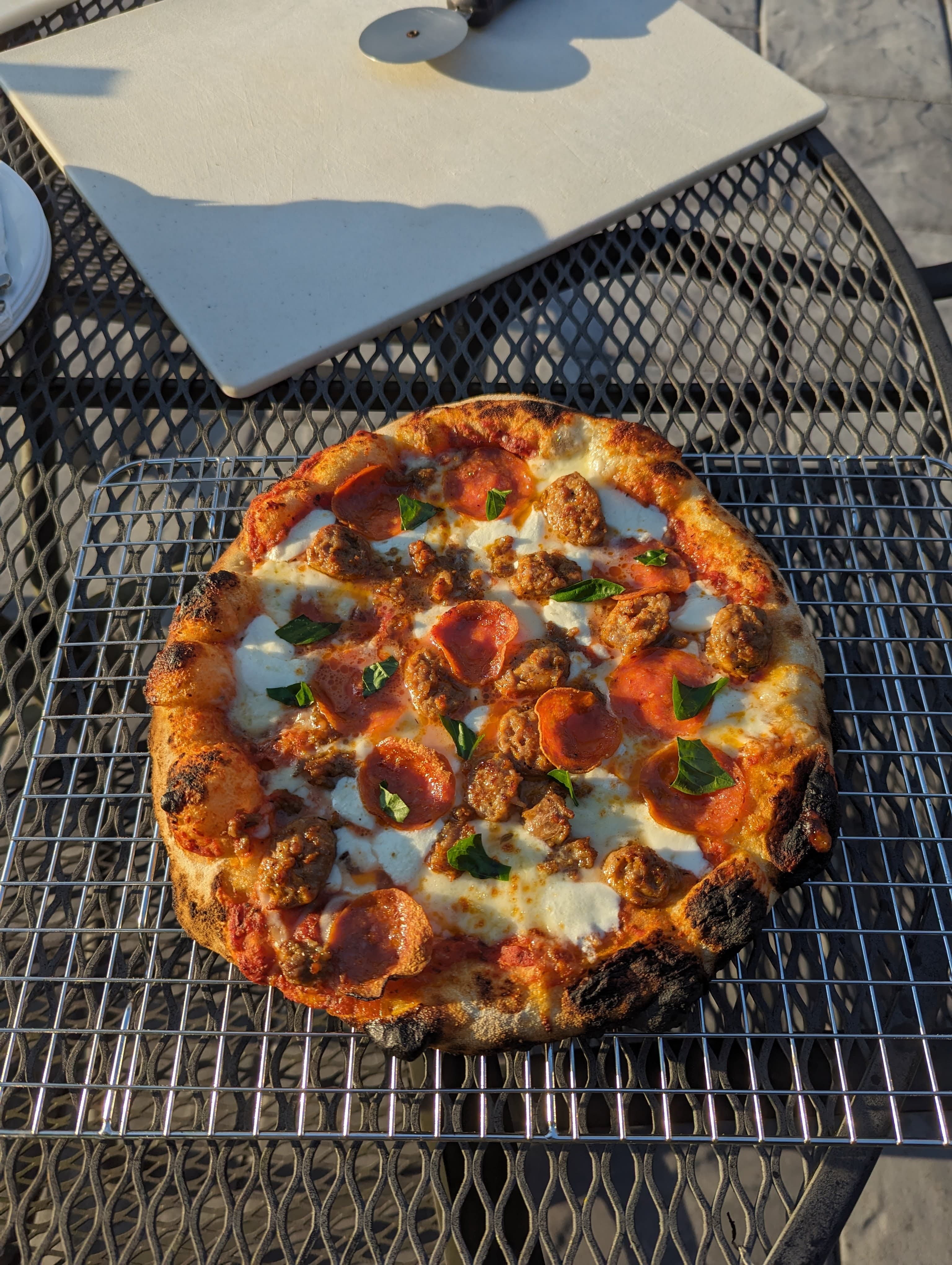

@bikerbudmatt @BrickWood @Bill Thank you all for the kind feedback and very helpful tips! I used a dough recipe that is made with poolish and did a 24 cold ferment. It made a huge difference in the airiness of the dough and its flavor. We did a pizza night last night and this was my best pizza to date, plus they were round this time too! :slightly_smiling_face:
Regarding placement of the fire, I did a hybrid. The burning wood was at the back and I also piled hot embers along one side. It seemed to result in a better bake for me. I definitely agree the best results are when the bricks are really hot, above 700 degrees F.
