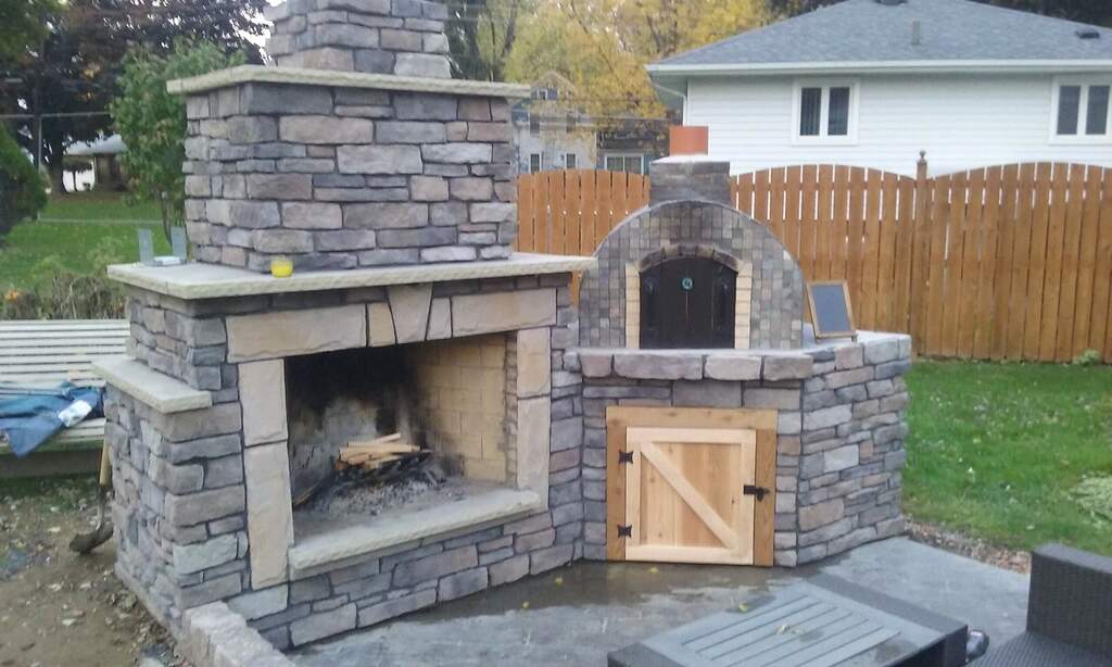

Of course, the best thing would be if one of our intrepid BrickWood Box builders were to see this post and respond. As one example take a look at this:
(I know it’s a fireplace combined with an oven, but the photos will give you an idea of the kind of support that’s needed.)
