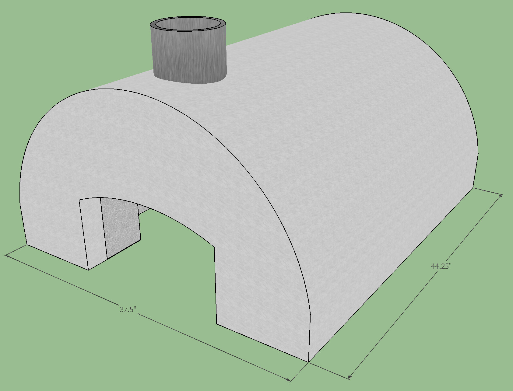

Hello -
I just opened the Cortile file - and here are the MINIMUM measurements of the oven. This is the oven itself, 2 layers of blanket and 2 layers of stucco…
