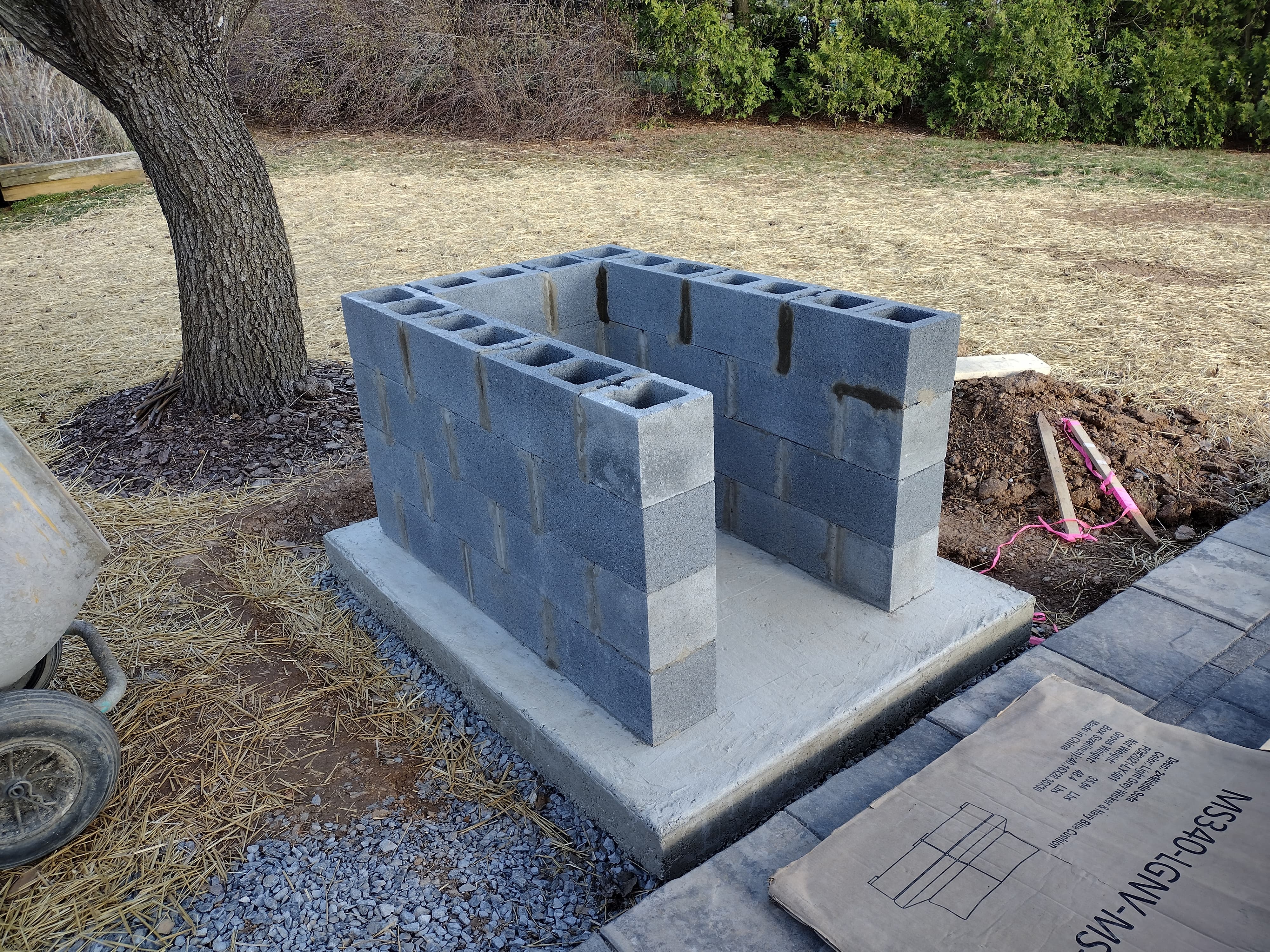

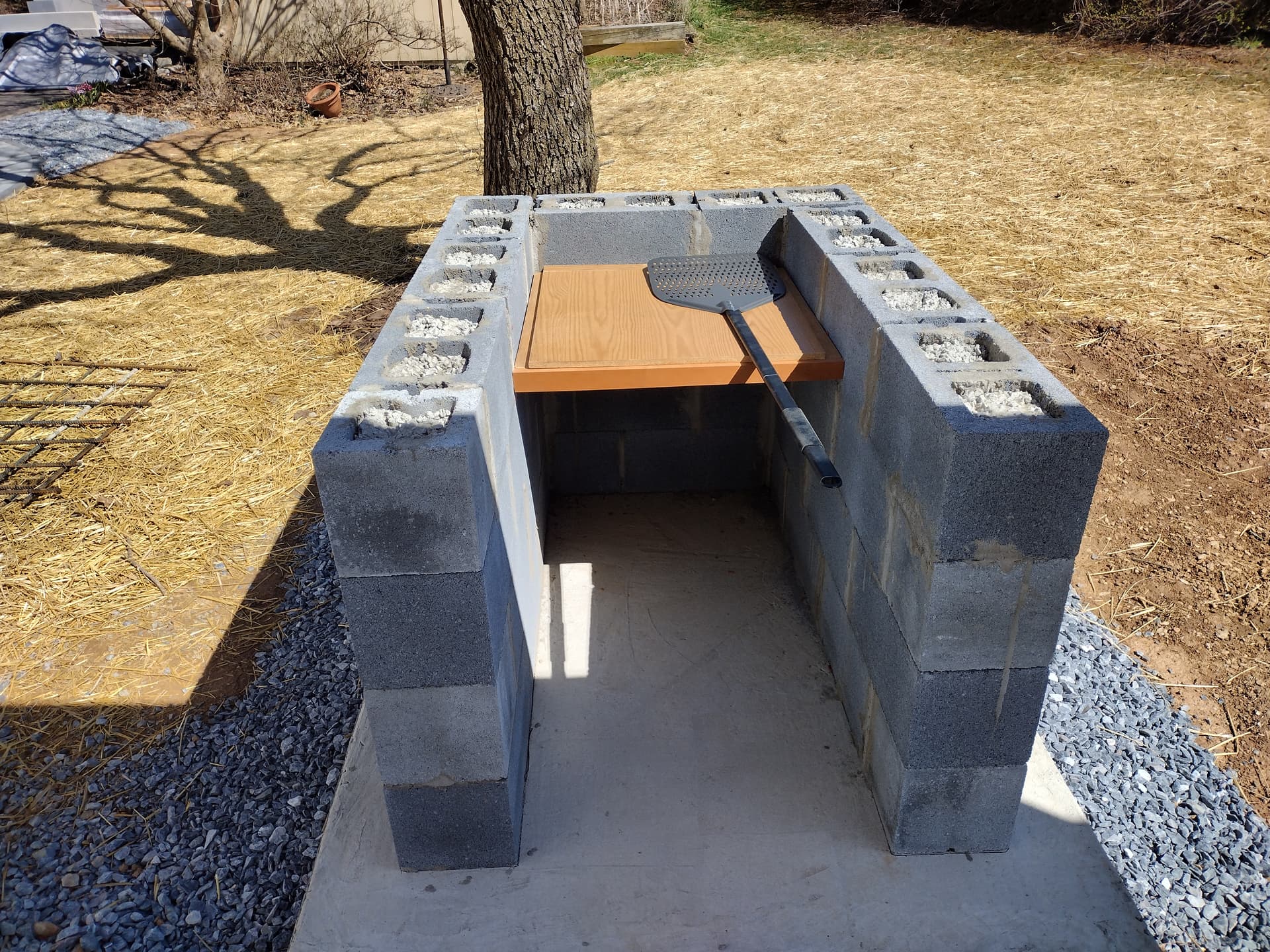

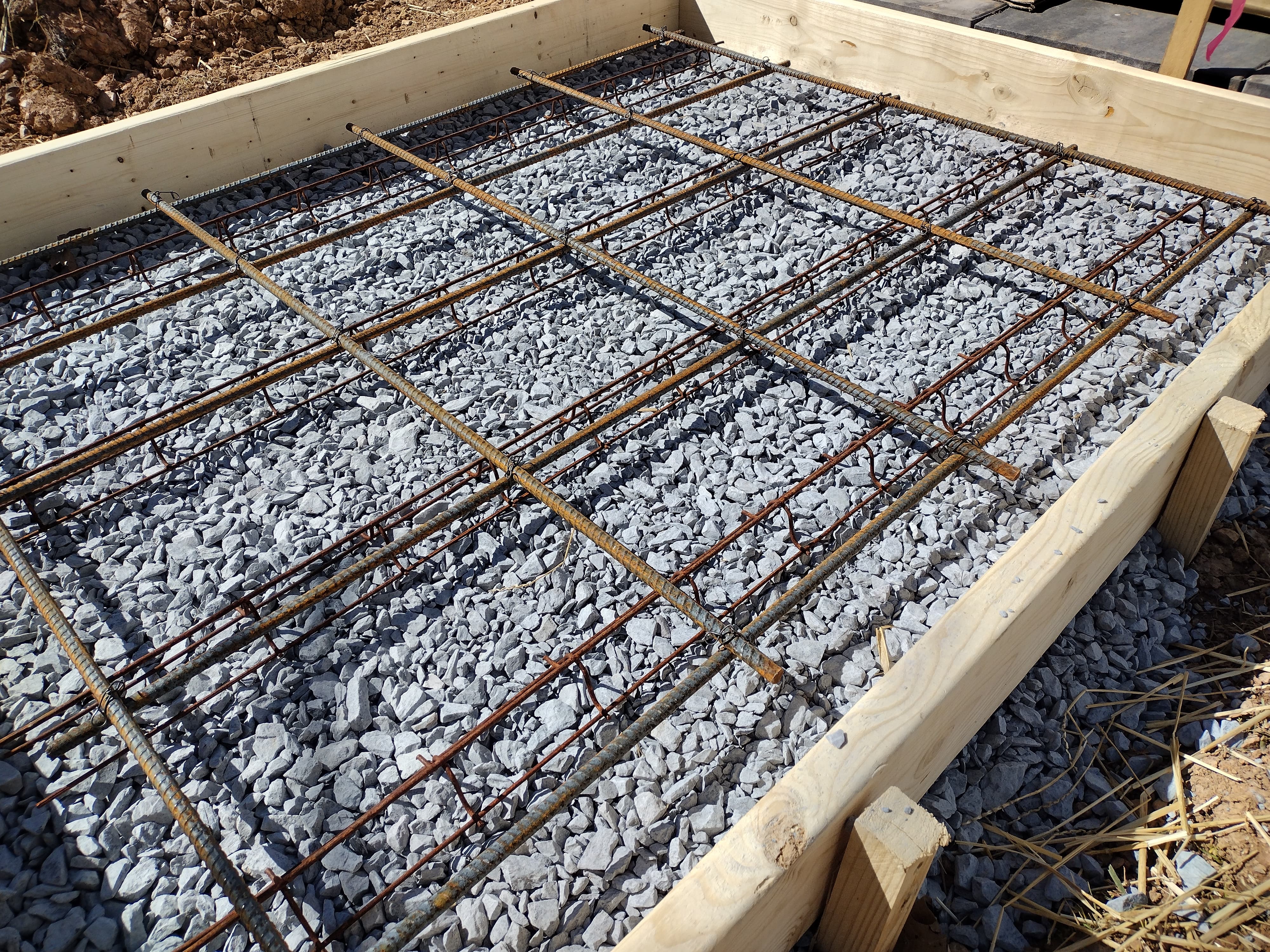

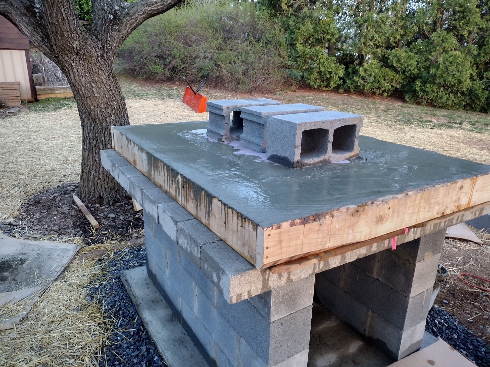

Just wanted to share some photos of my progress so far. I’ve been following the instructions with one major exception: the hearth was built in-place using a single pour. I didn’t have any way to lift the 3 hearth slabs, so I used eight 56x8x4 concrete lentils to build the hearth slab on. This allowed me to make a simple rectangular form for the hearth slab (See pictures).
