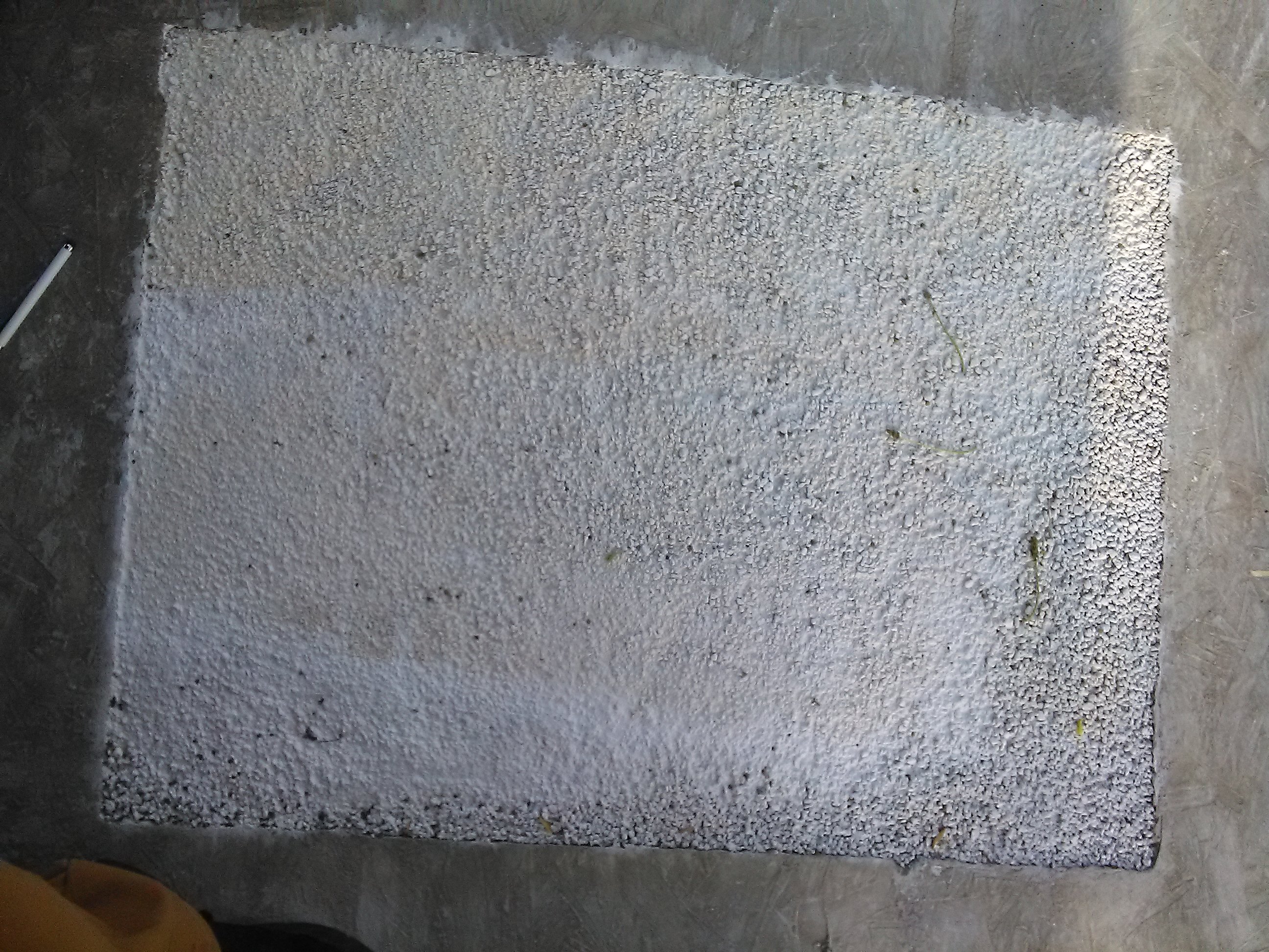

If you used Perlite I think you’ll be okay. The Portland cement is in the mix to bind the Perlite insulating material and give the insulated slab some form, but it’s not make-or-break structural. Just leave it alone for a couple of days, and perhaps gently soak up the excess water or use your masons brush to whisk it off the slab.
Two days from now, if you have a hard surface (hard enough so you don’t leave an impression if you press with your thumb), you’re fine. If it’s still soft, then you’ll have a head start on scooping it out and trying again.
Note that I’m talking about Perlite. For those of you who opt for Vermiculite, you’re unlikely to see water puddles but it takes 5-6 days to cure, and that’s normal.
