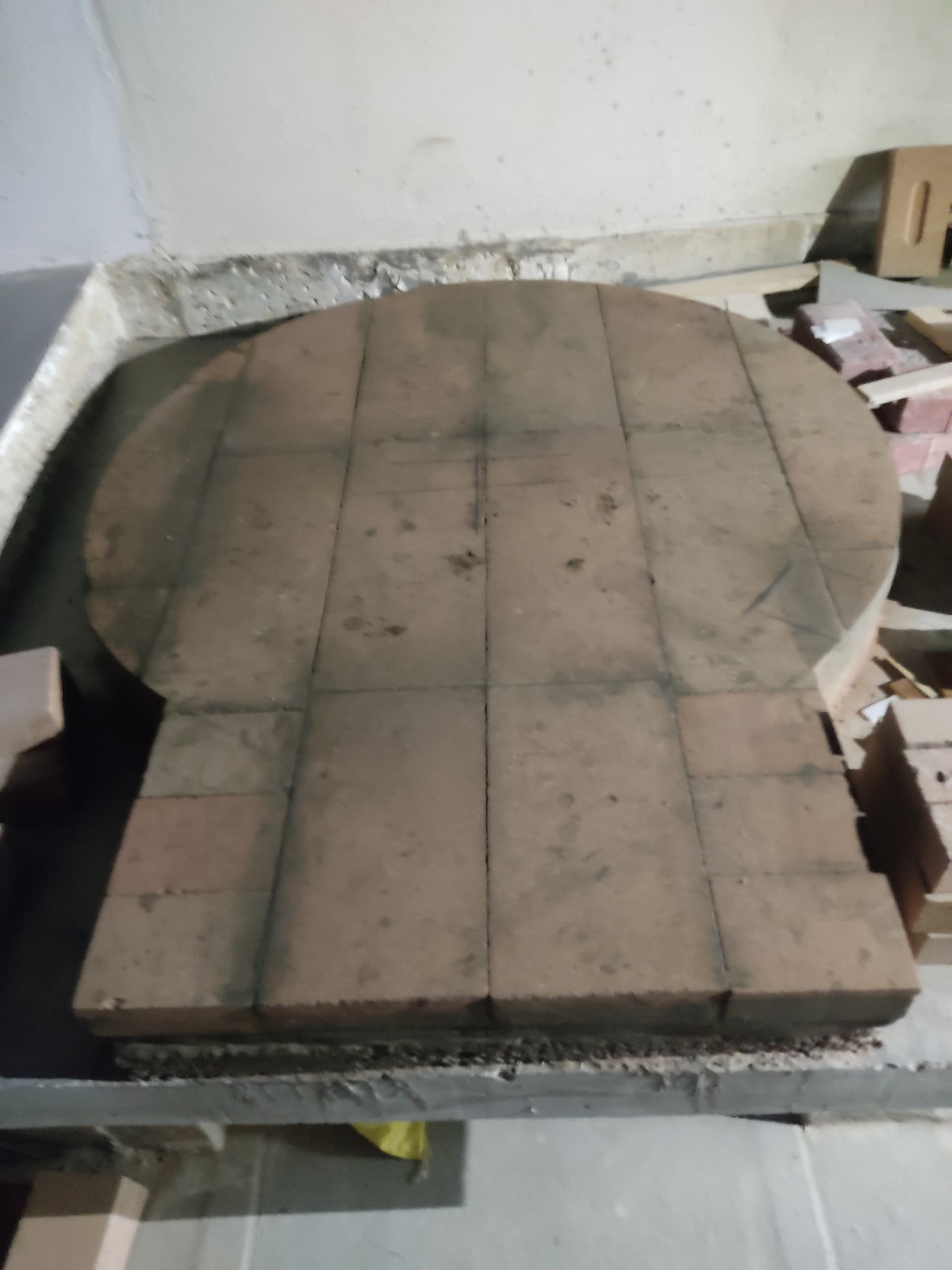

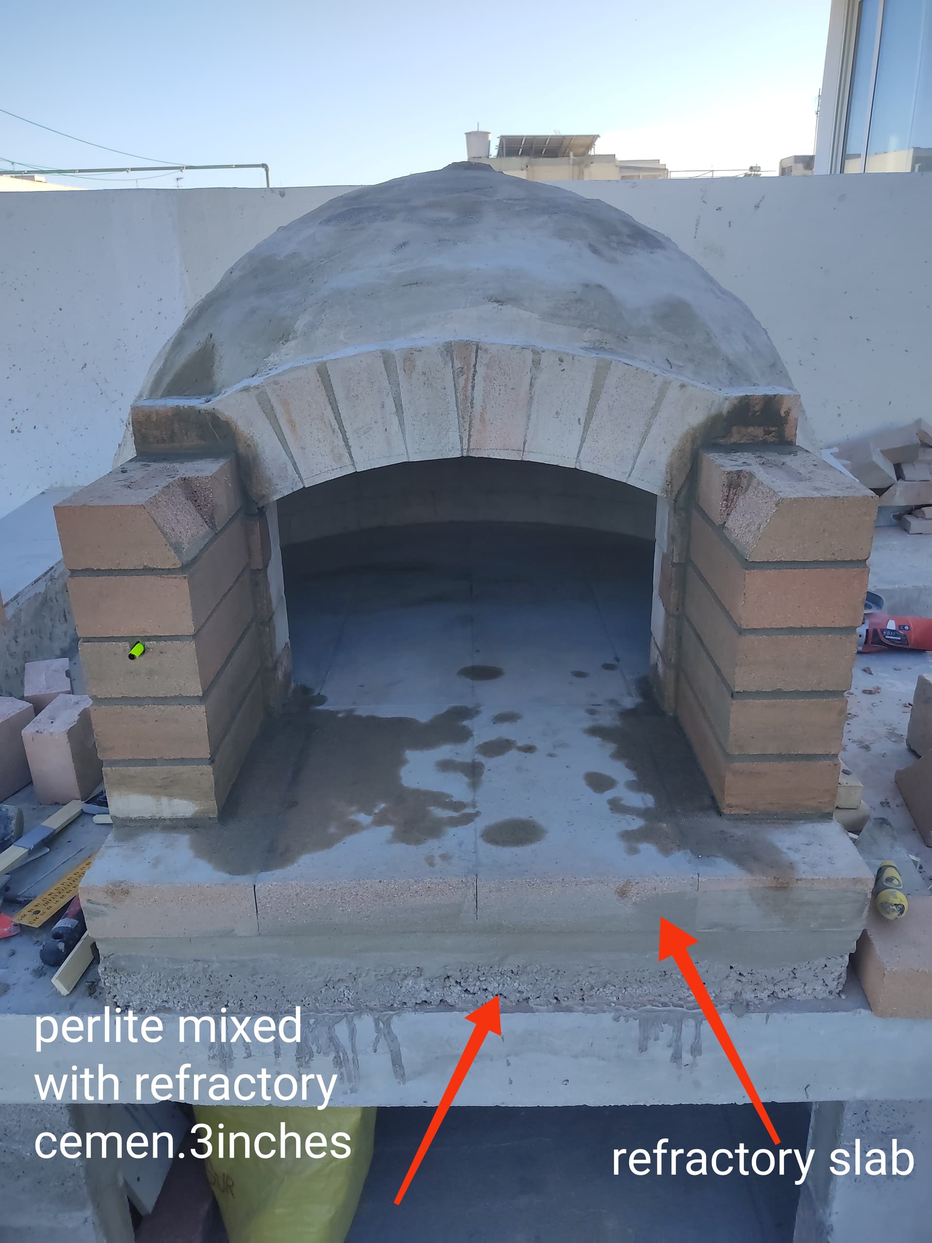

Sorry if i posted the images in the wrong place i am not a technology guru.
Your photos and construction plan look great! Thank you for these.
Looking at your build, I would just say again that you should not add a Perlite/Portland cement layer on top of the mineral fiber blanket. Feel free to look at our advice for adding the blanket, covering it with a “chicken wire” matrix (critical step!), and then sealing it with at least two layers of mortar. This will provide an insulated shell that will give your dome all the thermal insulation and protection it needs.
