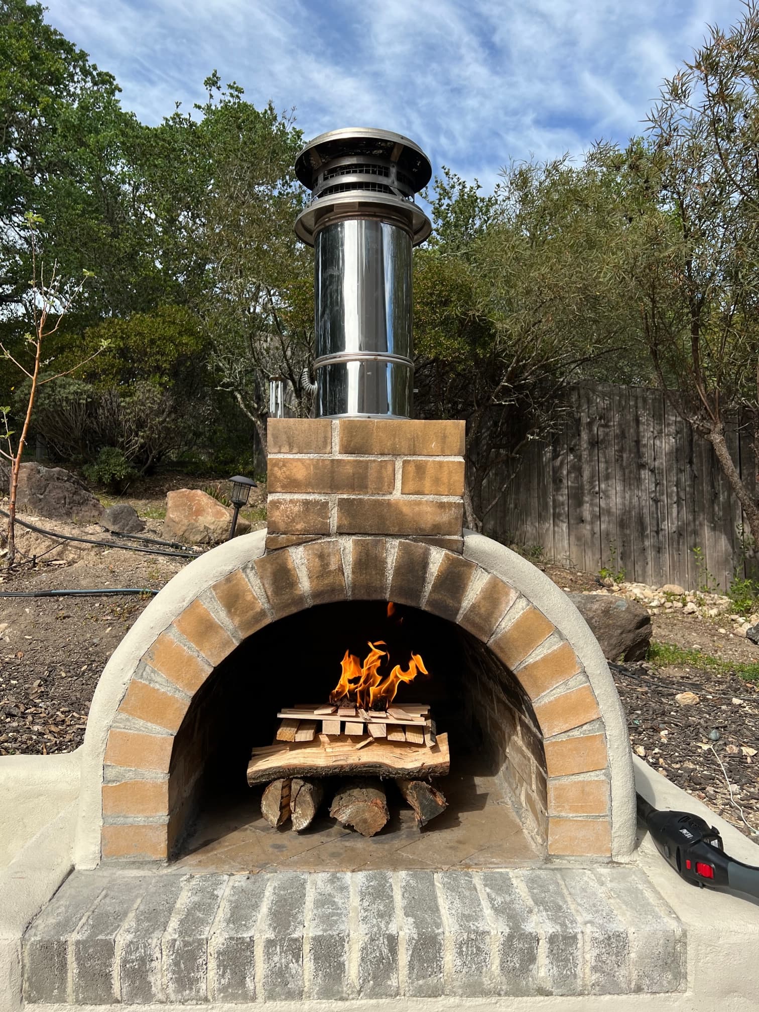

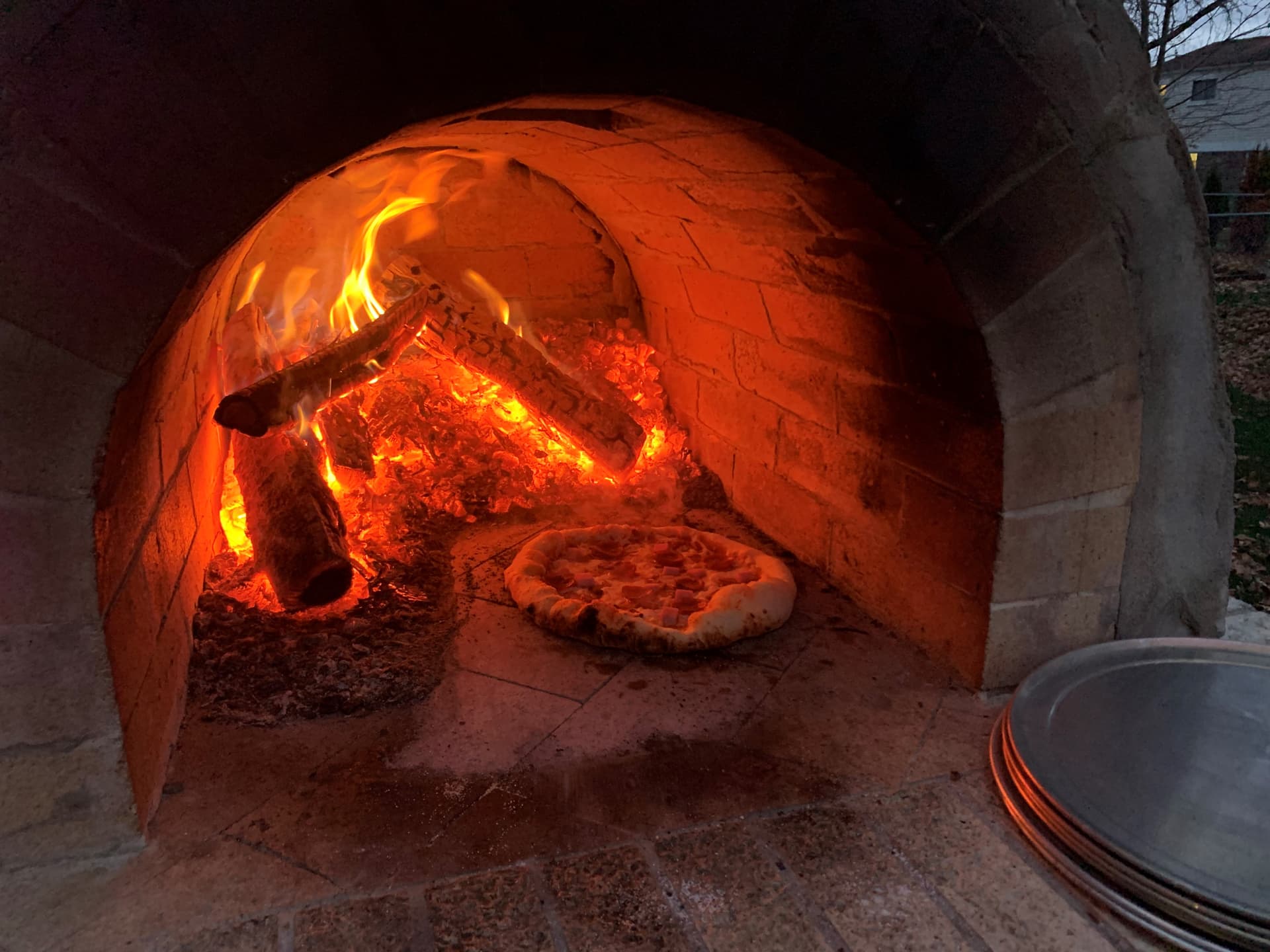

I built the Mattone Barile over a year ago. Although I’ve enjoyed the project immensely, the performance of the oven, or possibly my techniques, have been very underwhelming. Since curing the oven I’ve made pizzas on 6 occasions and the main problem I have is that the oven won’t get past 400 degrees or so and when I try to close or partially close the front with the door the fire immediately starts smoking heavily, and I’ve had a neighbor who has threatened to call the fire department. Last Saturday I had 12 hungry people over for a pizza party. I spent 1.5 hours tending to the fire, using a blower at times to feed it oxygen so the smoke would be minimal, finally got some decent ashes, and the oven wasn’t hot enough to cook the pizzas. I would try to close the door off some to heat it up and the smoke would immediately start getting heavy. I ended up cooking the pizzas in my gas grill, so sad. I don’t know if I’m doing something wrong or if my oven has a major problem, although I followed the plans exactly. I’ve been using dry almond wood and even got a taller chimney but nothing is helping. Any help would be so appreciated!
I’ve attached a picture of the outside and an inside picture of the one time I did successfully cook two pizzas inside but even then it wasn’t more that 550 degrees.

From your pics I can say you probably just need to work on your fire building technique. In your bottom picture you can see the black soot on the dome which means your fire is not hot enough and you have very little hot coals in the back with no flame… Compare to these pictures.
Hints:
Start your fire from the bottom of the wood pile. Remove that center piece of wood and stuff that cavity with your small pieces of wood and light those. Start with the smaller pieces of wood and pile the larger pieces on top of those. As I think about it, your fire is just built upside down. Leave the two big pieces on the bottom (left and right) and just invert everything else.
The initial fire has to be big enough and burn long enough to create a nice layer of coals in direct contact with the floor AND burn the soot off the top of the dome near the back of the chimney. Then I push the fire around front to back and add more wood so that the whole oven is getting fired at the same time. Remember to keep some fire and coals up front because those bricks need to absorb a lot of heat. When the soot on the dome in back burns off you are pretty much ready to go though I always confirm the dome temp with the thermometer.
Also you need to have flame while cooking in order to maintain the temp. What you show in your picture would be good for baking bread but not making pizzas. But do not add or adjust wood while there’s pizza in the oven unless you like ash covered pizzas.

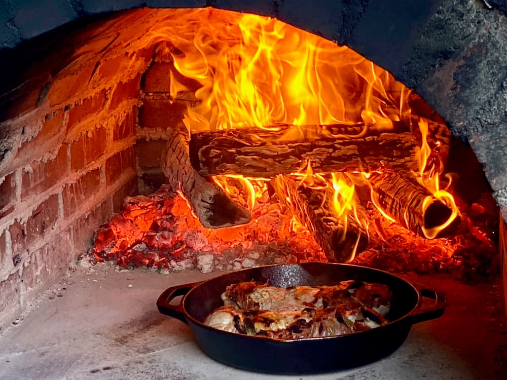

check out the photo of Kgondoly that dude has it right huge flame

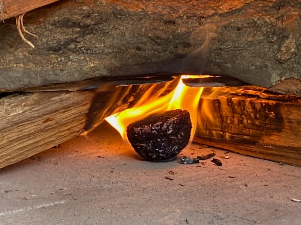

The other key to Step 1 is a steady and sustained ignition source. No newspaper or similar waste materials, and almost none of the various firestarter products on the market—most of them contain petroleum based binders that will contaminate your hearth. I swear by Lightning Nuggets because they are inexpensive, made of sawdust and food-grade wax, and they burn long enough to start hardwood splits without a need for kindling. I put a single nugget at the point of the “V” to get it going. There will be some smoke at this stage, but you shouldn’t see thick white curling streams of smoke and certainly not any black sooty streams.
A Lightning Nugget doing its thing
