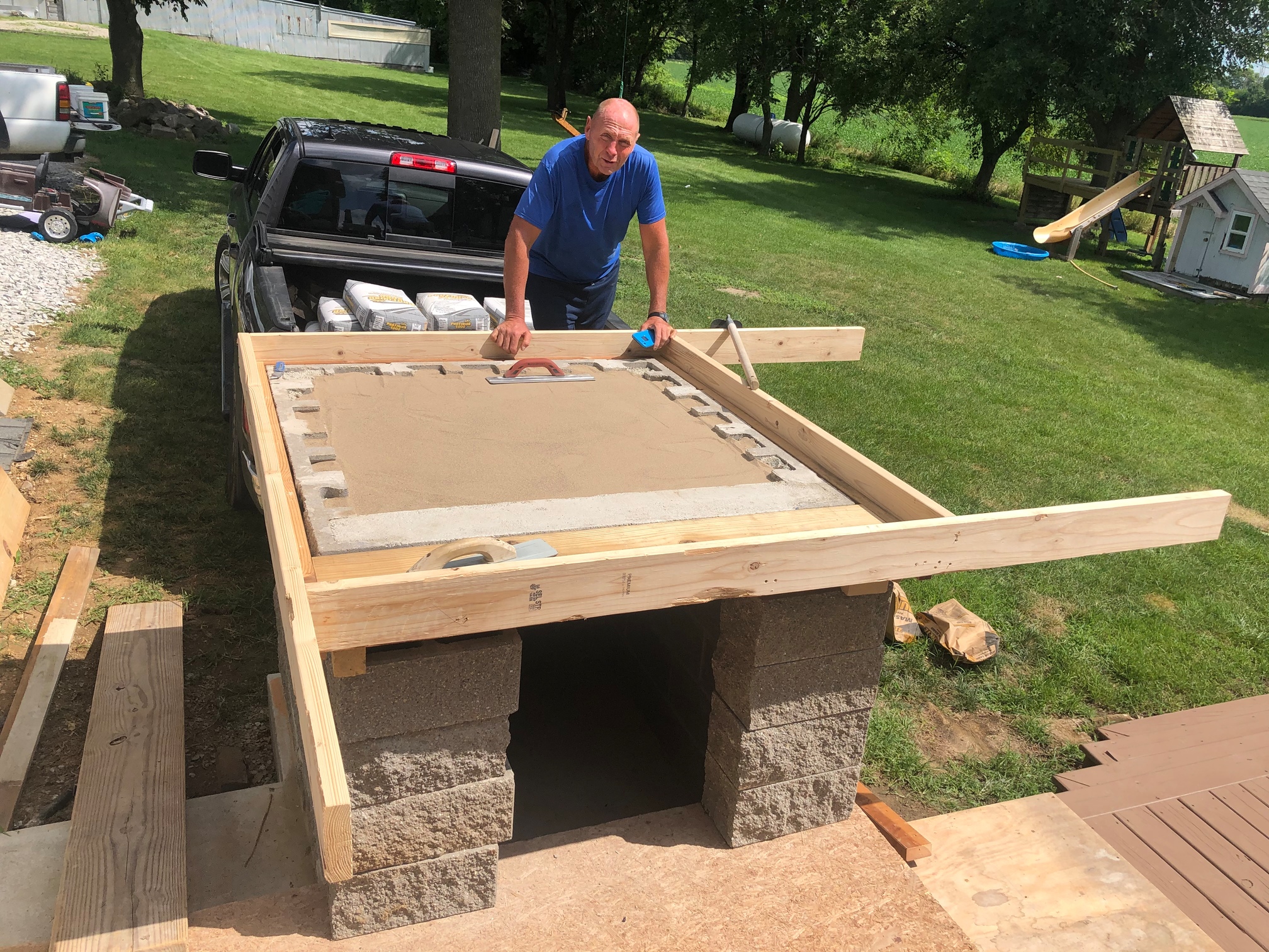

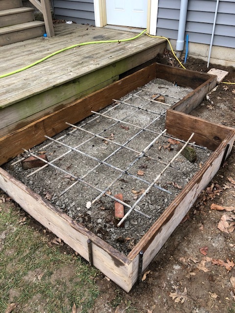

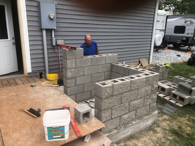

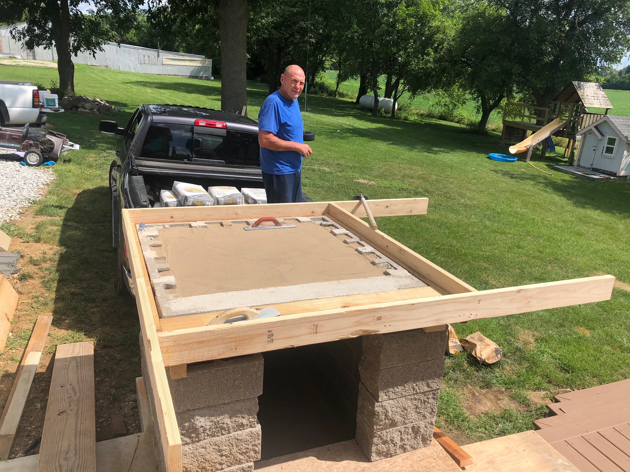

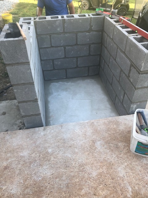

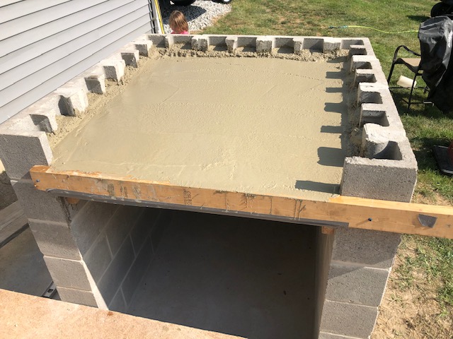

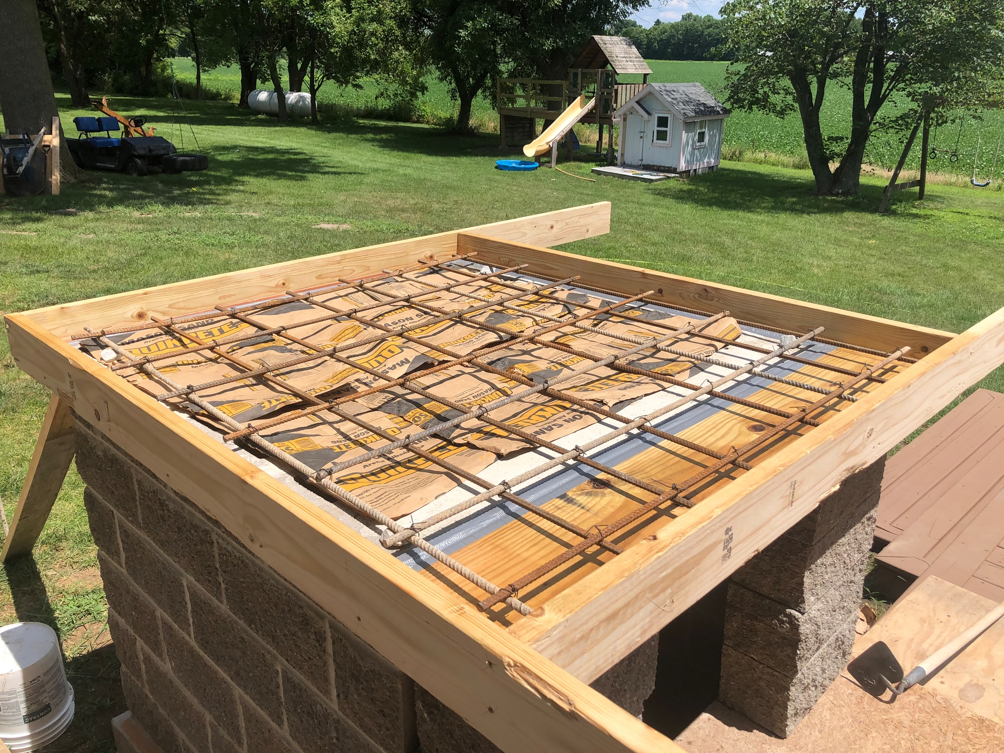

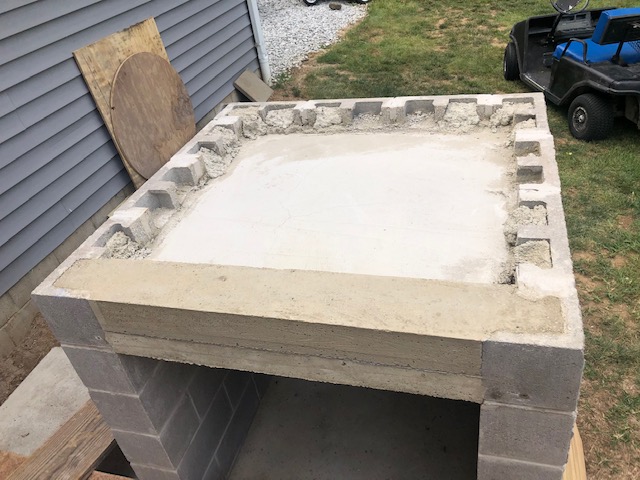

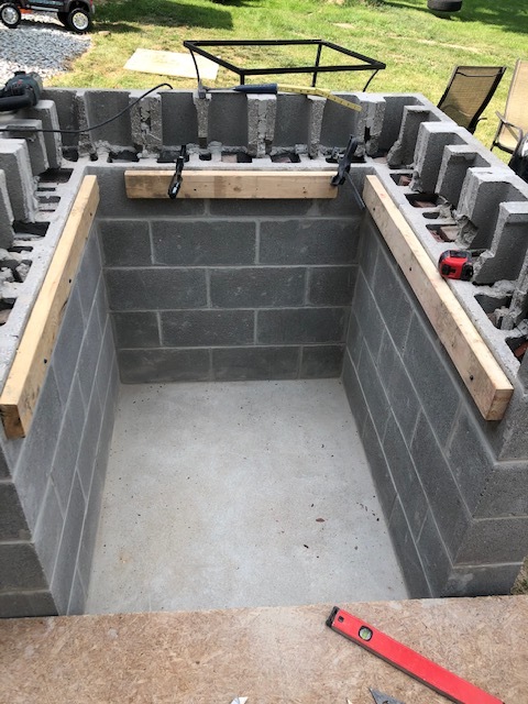

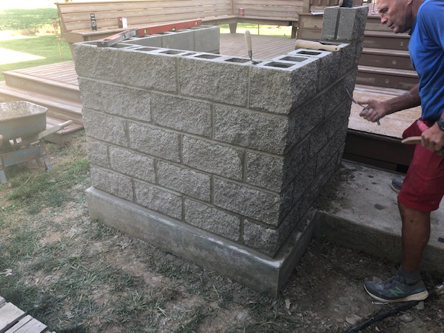

I have an 8-12 inch slab (it varies in different areas) reinforced with rebar. We have built up a base with split face concrete blocks. That last block was cut to create a form for a 3.5" slab. Once the slab cures, we will put 4" block across the front that will be level with the top of the block. I will then fill that area with sand and build a form for another slab.

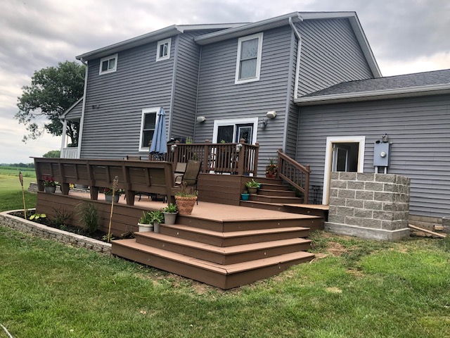

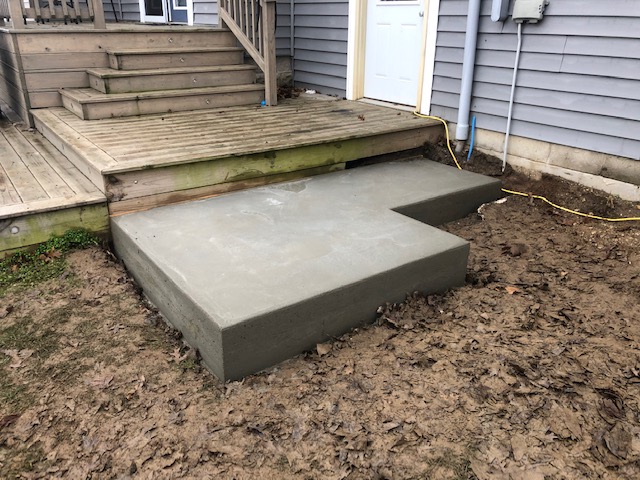

An overview of my backyard scene for context.

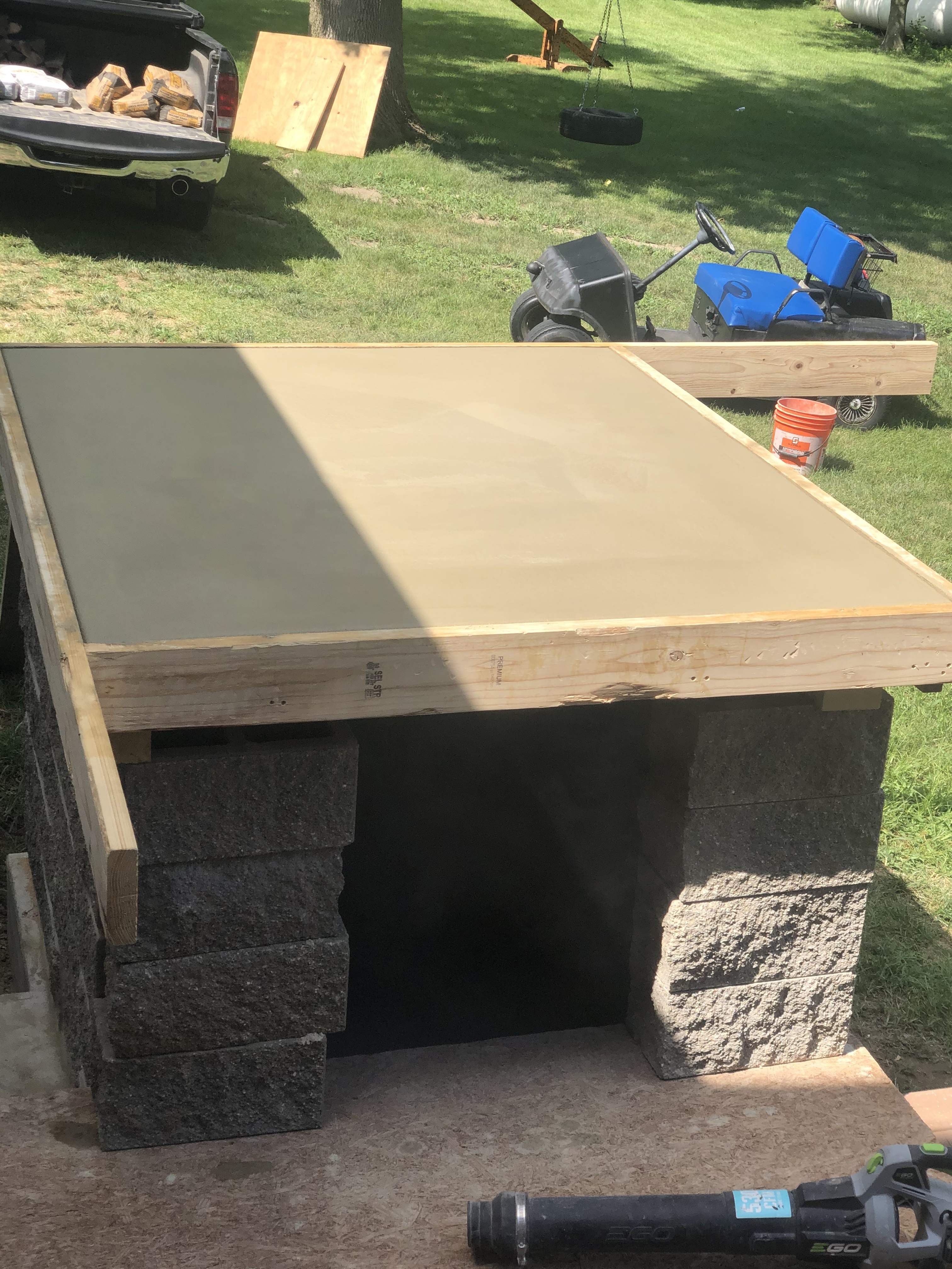

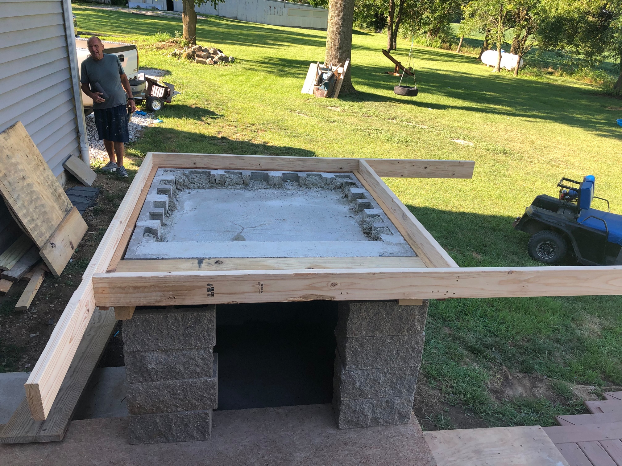

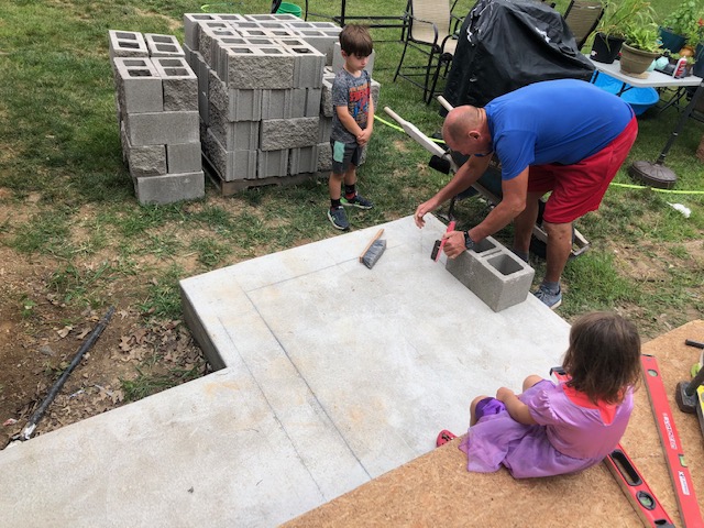

This is the bottom layer of the base with the forms off. Noticed I had to add another layer of concrete on top of the base layer. I hadn’t thought about how I was going to keep the sand in. This seemed like the most reasonable solution.
I plan on putting a skim coat of stucco across the front, when I stucco the dome, in an effort to cover the unfinished look of the poured concrete.
