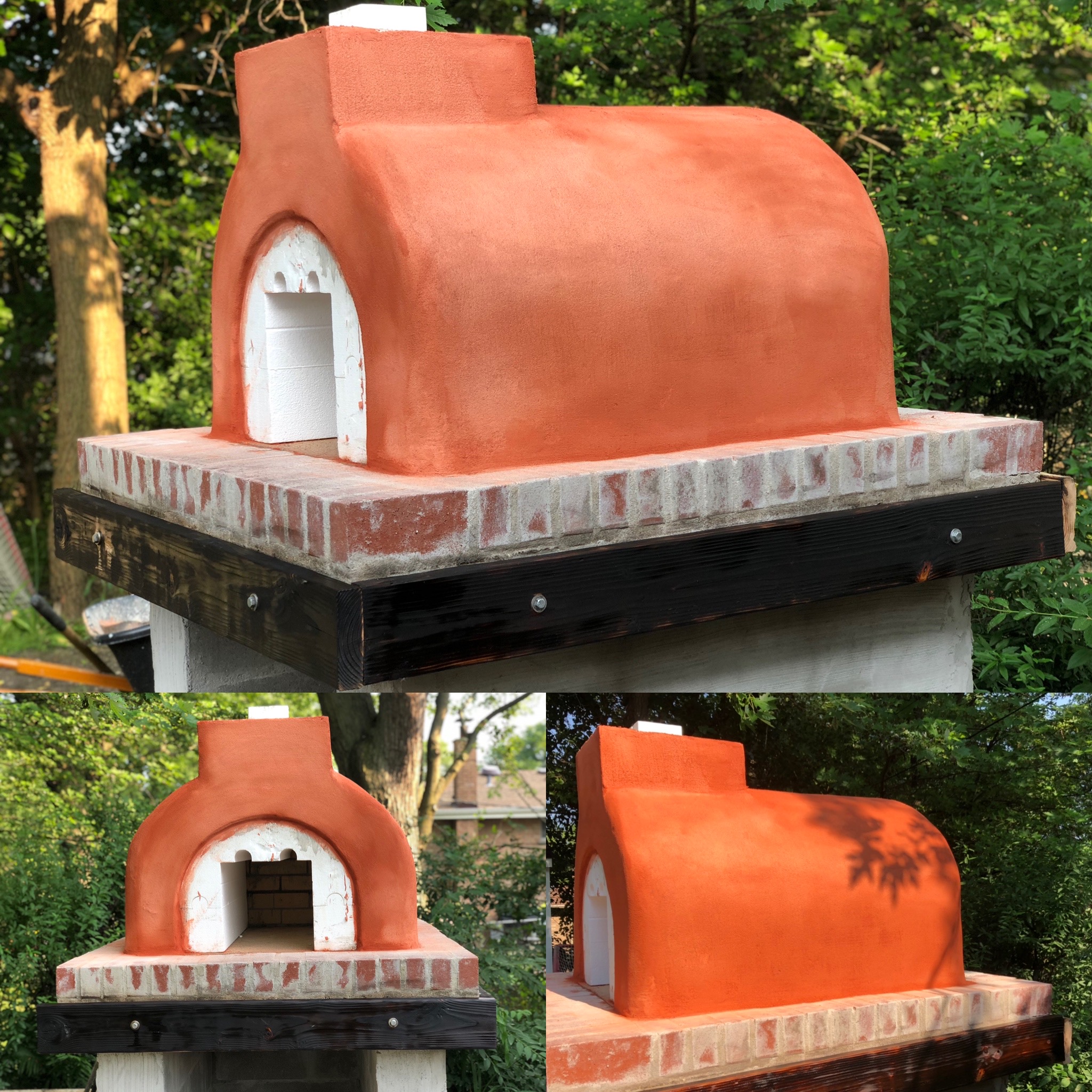

Hey i have to say that is totally AWESOME!!! I love that look and your finish!
Can you explain what you used and your process? Really looks good!! You have made me rethink my finish now!

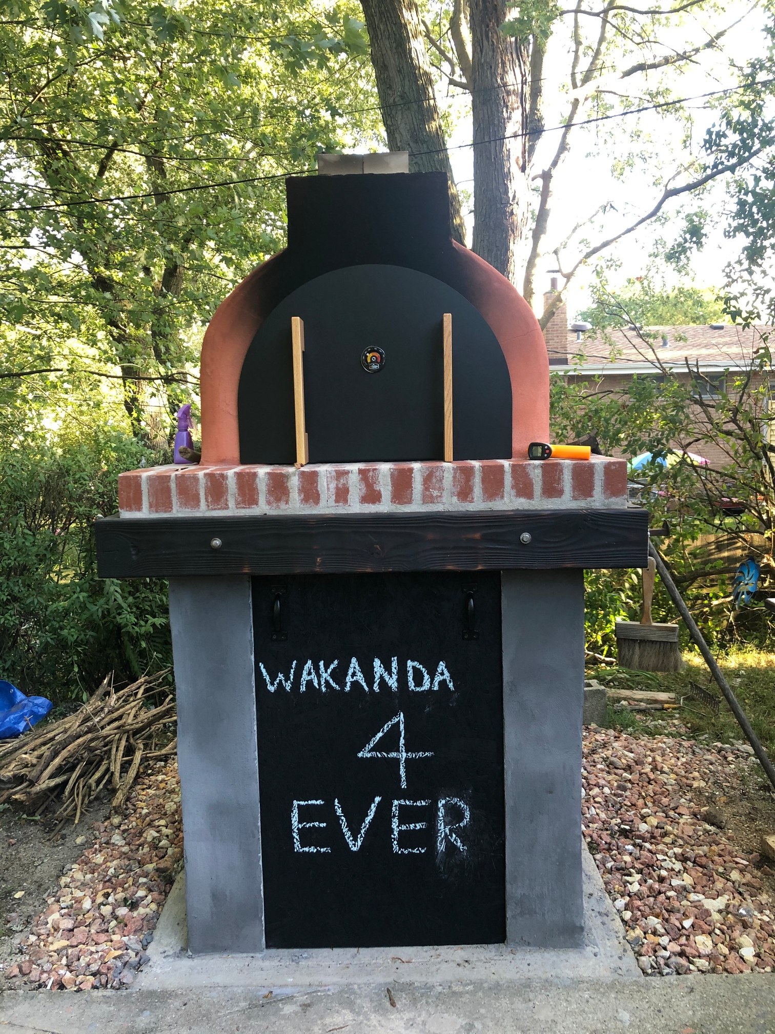

Thanks so much! The oven is just two coats of stucco and then a top coat of stucco using quikcrete terra-cotta cement coloring. I went with this vs. paint because down the line if I wanted to put brick veneer over it I wouldn’t need to strip the paint. The wood was done with a shou sugi ban treatment (basically torching the wood, removing the carbon with a wire brush and then sanding with 220grit and then linseed oil. I am debating tiling over the brick with some turquoise calavera tile.

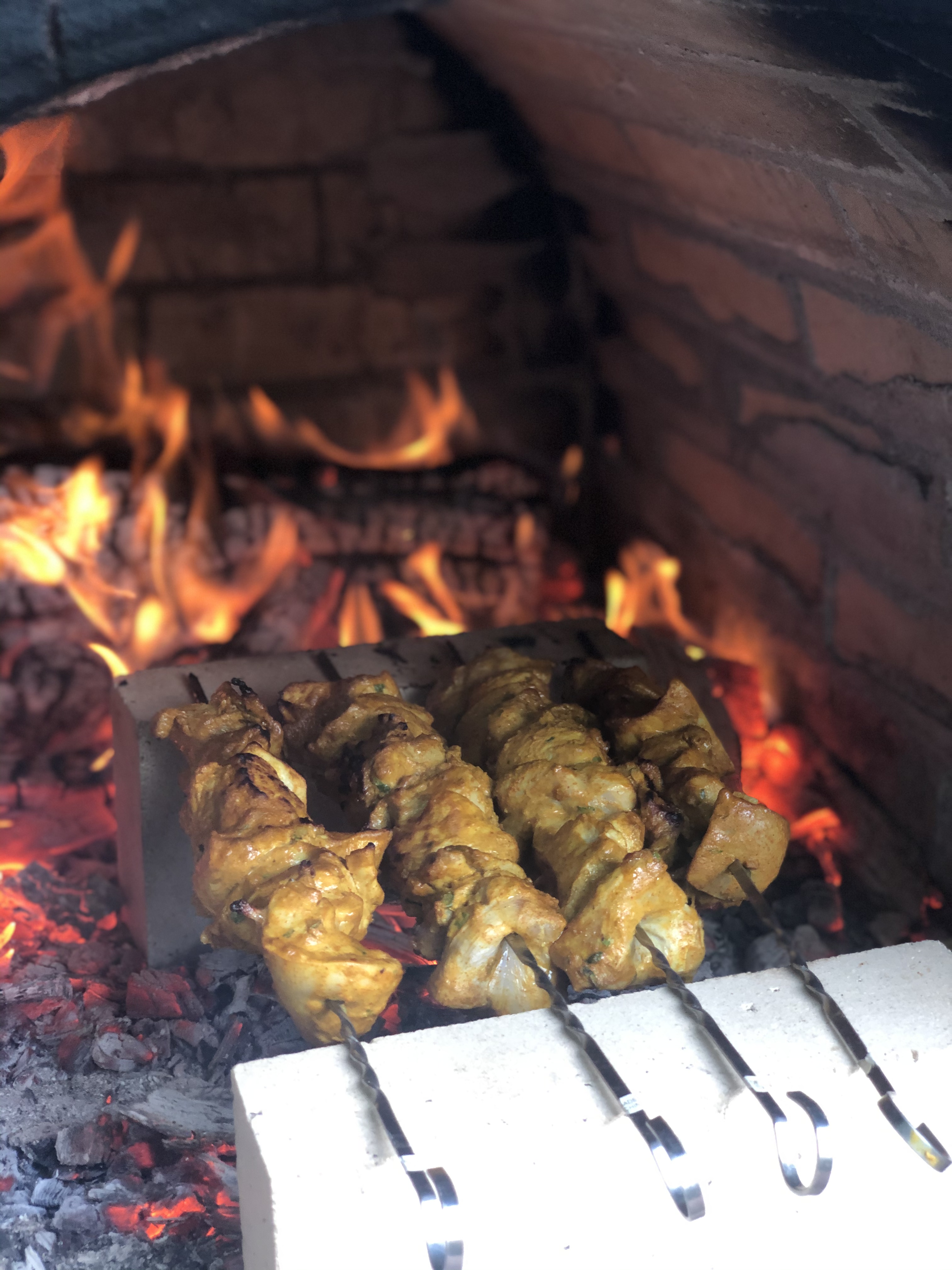

Genius idea for the kebabs.
Congratulations and thanks for sharing those photos Jay! Wondering if your wood compartment door is a “floater” or a slider?

It’s a floater. Painted it with chalkboard paint and let the kids go nuts with it.
Thanks for sharing some of your foods beside pizza. The misses and i are always looking for news ideas!

I love this look and I think I am going to do this or the charcoal coloring for my oven. Hopefully getting to the ceramic blanket this weekend. Does this help with the sealing at all or would you still need to seal to weatherproof?
