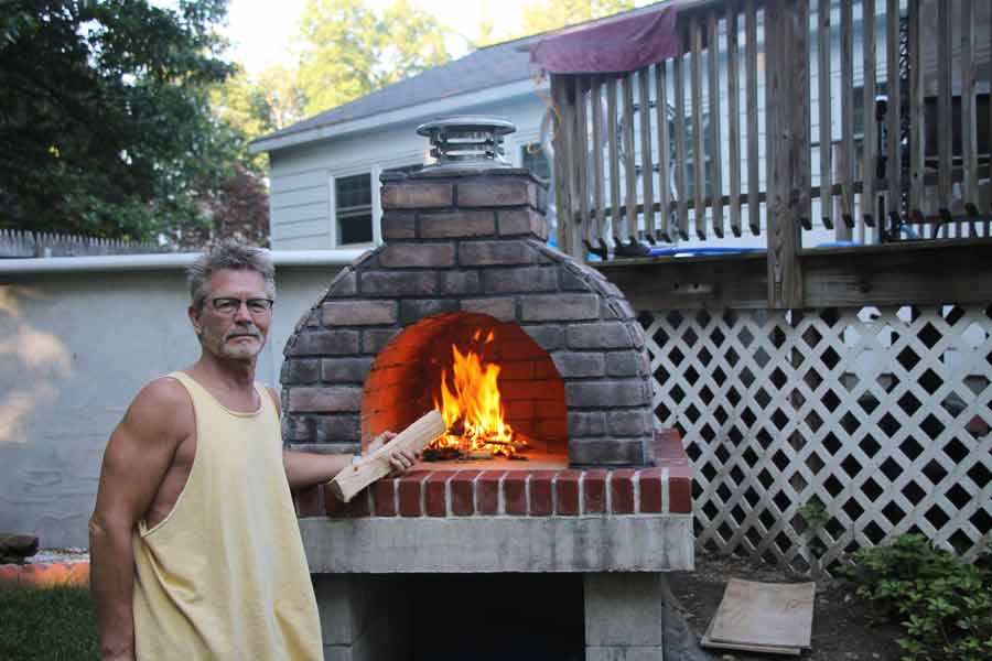

“I would like to say the BrickWood Ovens Mattone Barile brick pizza oven kit was a perfect Christmas gift from my sister and brother-in-law in Tulalip, WA. Thanks for letting us share our experience!”

I only have a picture of the finished move. My 13 year old son and I did it. The hoist was about 40 dollars to rent I think.
