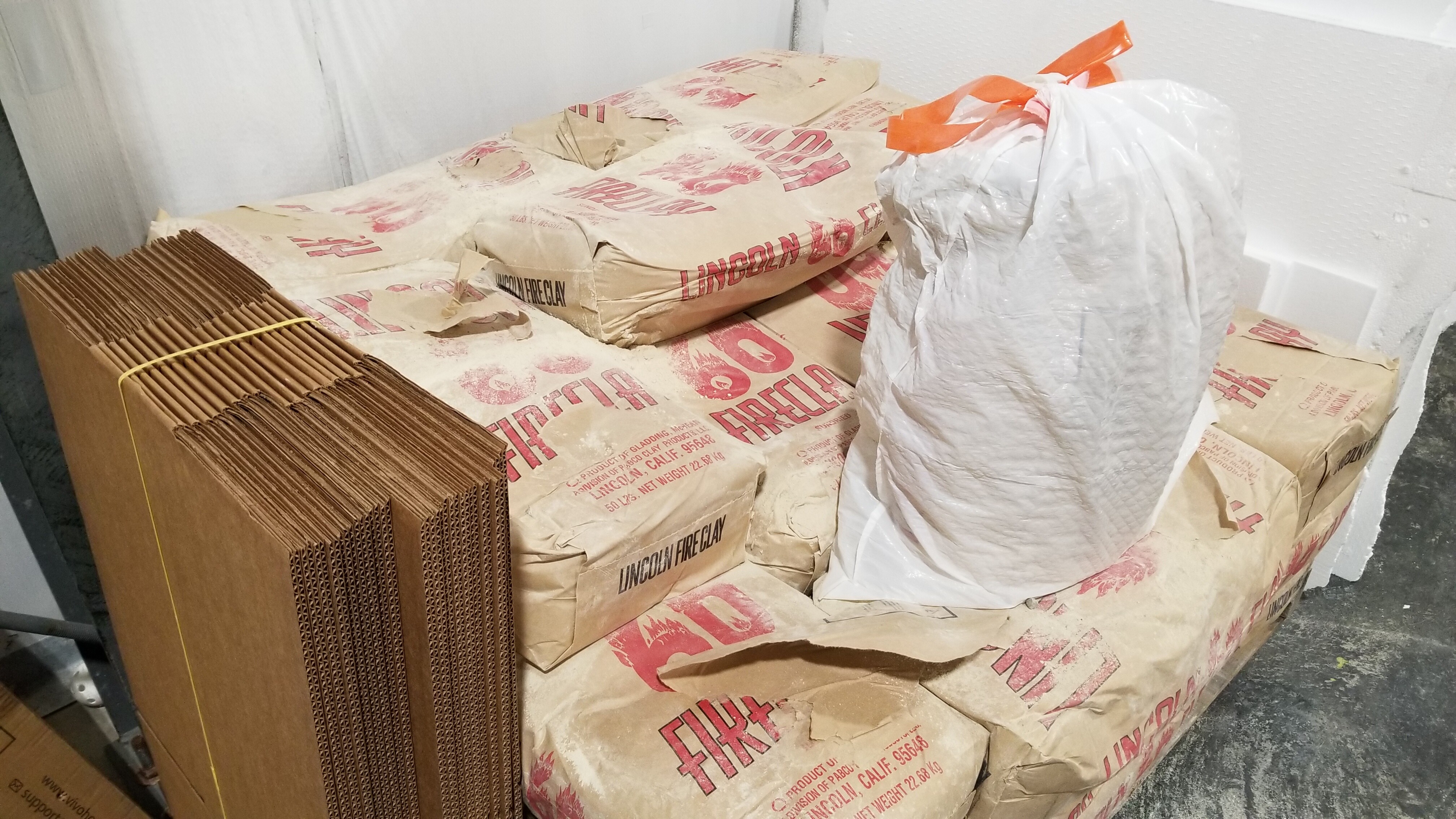

Since Saran Wrap is no match for wet cement with 1000’s of jagged stainless steel fibers… I would recommend using a Tall Kitchen Trashbag. The bags are super thin, super strong, and they are a lot more durable than plastic wrap. In fact, before we ship Fireclay or Lime, we always put the materials in a kitchen size trash bag before placing the material in a shipping box (see image below).
Simply cut a Tall Kitchen Trash Bag bag in half, then you will have a large single-sheet layer of plastic.
When you place the thin layer of plastic liner over the styrofoam panels (Front & Back ONLY - Not the Side & Top panel box), make sure there are no gaps between the underside of the plastic liner and the foam. There are a few 90° angles on the form, so you will need to keep the plastic liner loose… so it will naturally compress into those tight corners as you pack the refractory.
