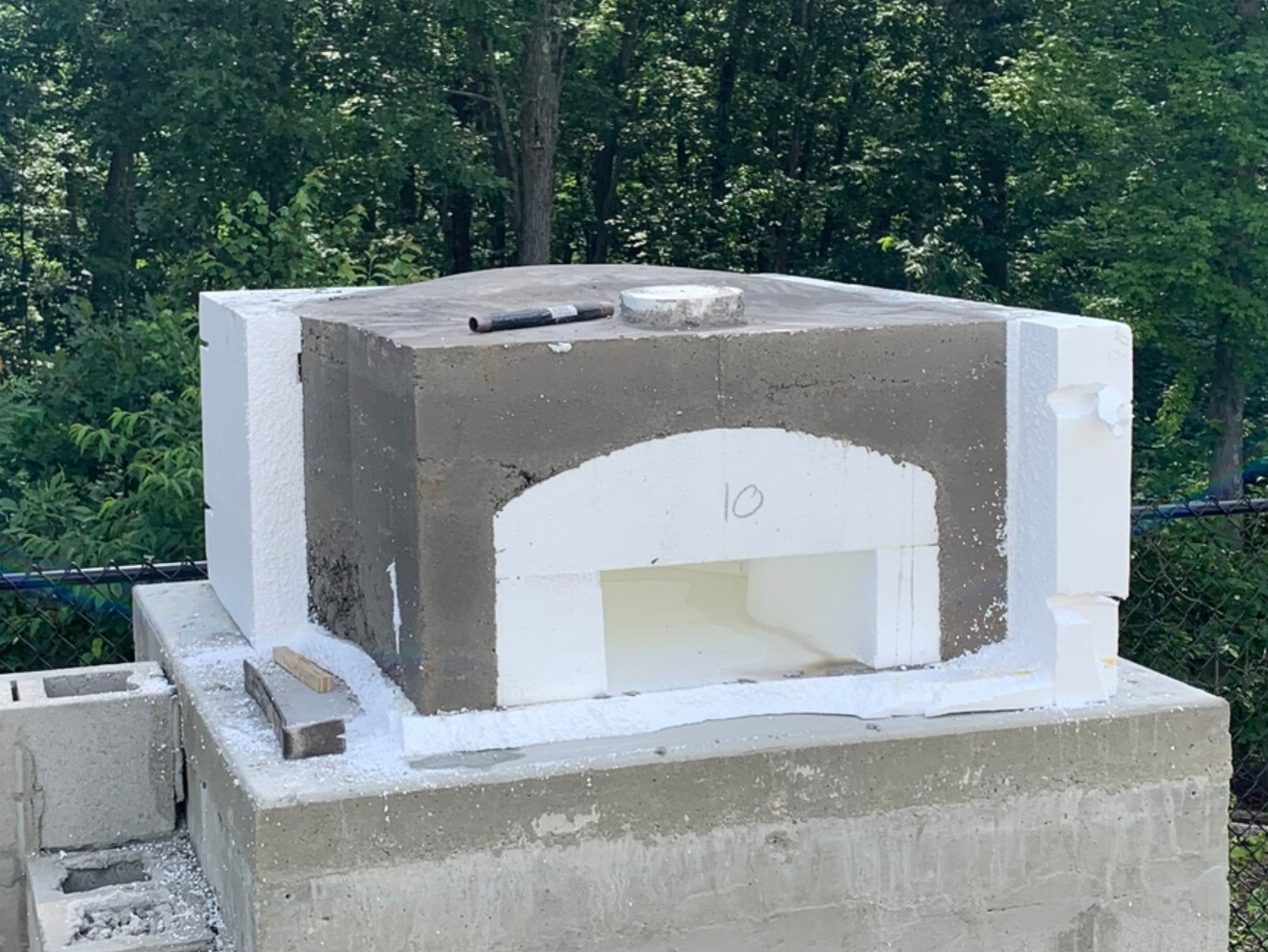

My wife and I poured the 28” cupola last weekend and I started taking down the foam form. Unfortunately I noticed on the outside an air pocket that formed and I could see through it. Can this be fixed by mixing more refractory cement and patching it? Can it be fixed by patching it with refractory mortar? Or do I junk it and start again?
The pic below doesn’t show the void but it’s further back on the left side. I failed to take pic at the time.

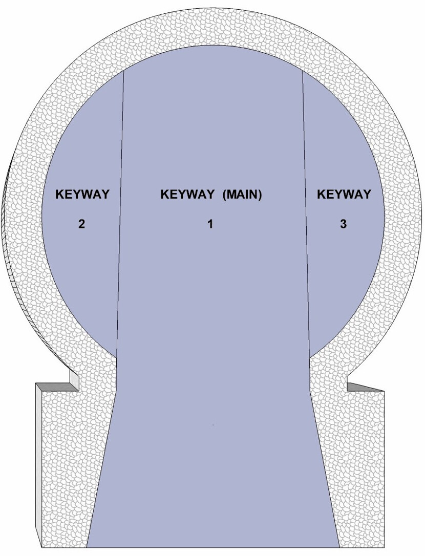

Next question for both of you… How well did the large foam wedges come out of the inside of the Mattone Cupola’s? I recently did a small design change on the Cupola’s so it would be MUCH easier to remove the inside foam. Instead of one solid chunk of foam, we are now building the form w/ foam sections so they SHOULD slide out with a little elbow grease. And according to CAD, the foam wedges remove 50% of the internal foam.
Can you let me know your thoughts?

The foam wedges were a challenge, but once I saw that they were is sections, that seemed to make it a bit easier. Looking back on it, I should have made some sort of a hook, maybe from a wire hanger and shoved it into the wedge and slide it out? Maybe that would have been easier?
