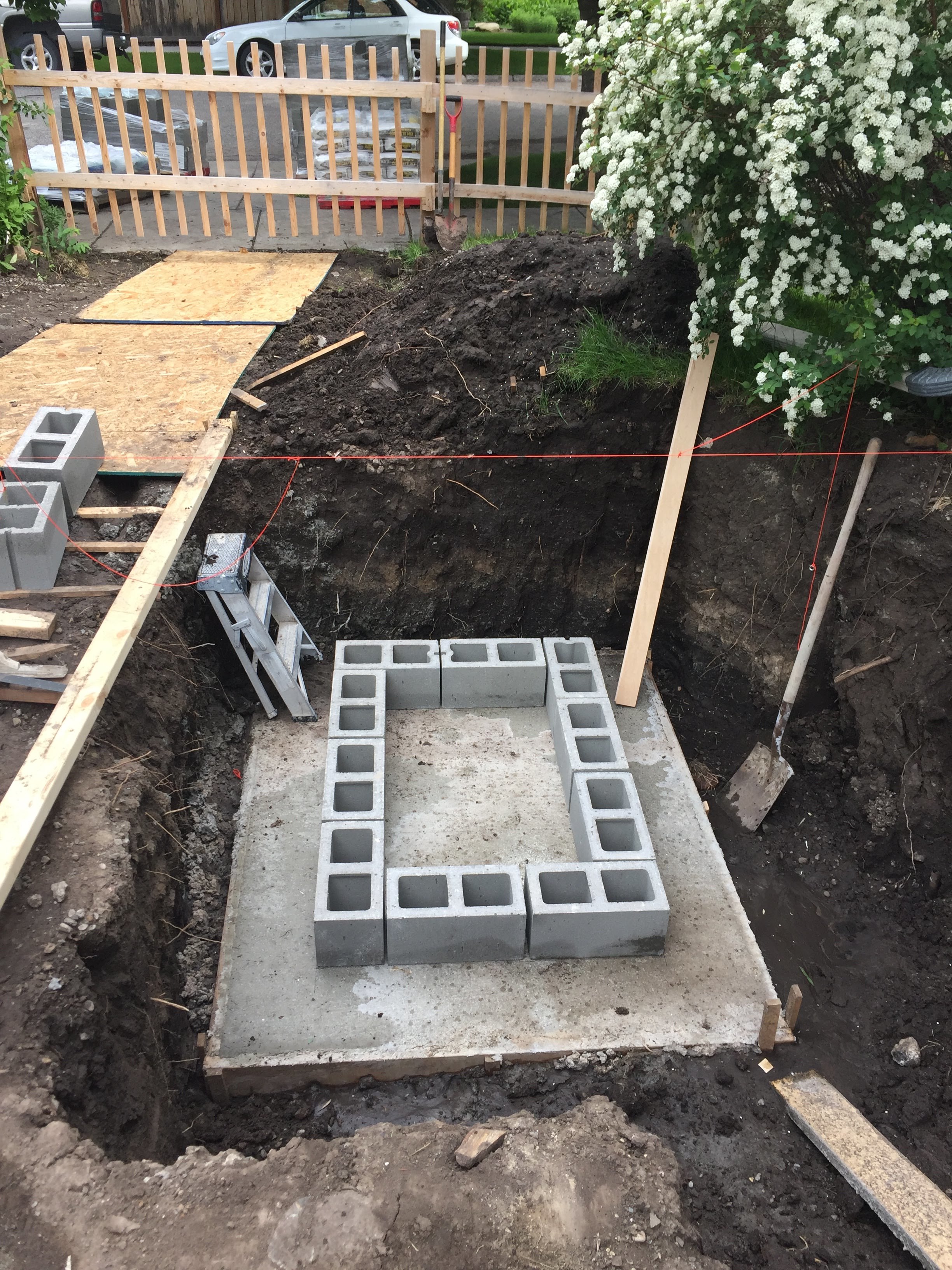

Just saw your post. I am in the process of building an oven integrated into my deck. I had a GC doing some renovations which was helpful in a couple ways. Here is what I did.
- With the help of the GC and a backhoe, dug to the frost line. It was a long way down, I am in Montana.
- Compacted the ground with a jumping jack. Built a form that was larger than the specified base, added some gravel and rebar. Poured the slab. I can’t remember if the form was 6" or 8" high. See picture.
- Using the same dimensions as a normal “grande” base, built up to the deck level. Poured a “floor” in place. Picture attached.
- To make it bomb-proof, I core filled everything.
- Attached is a picture of the above-ground portion of the oven for scale. Probably about 7 feet above ground and 2.5 feet below. So much taller than a normal oven.
Let me know if that helps.
