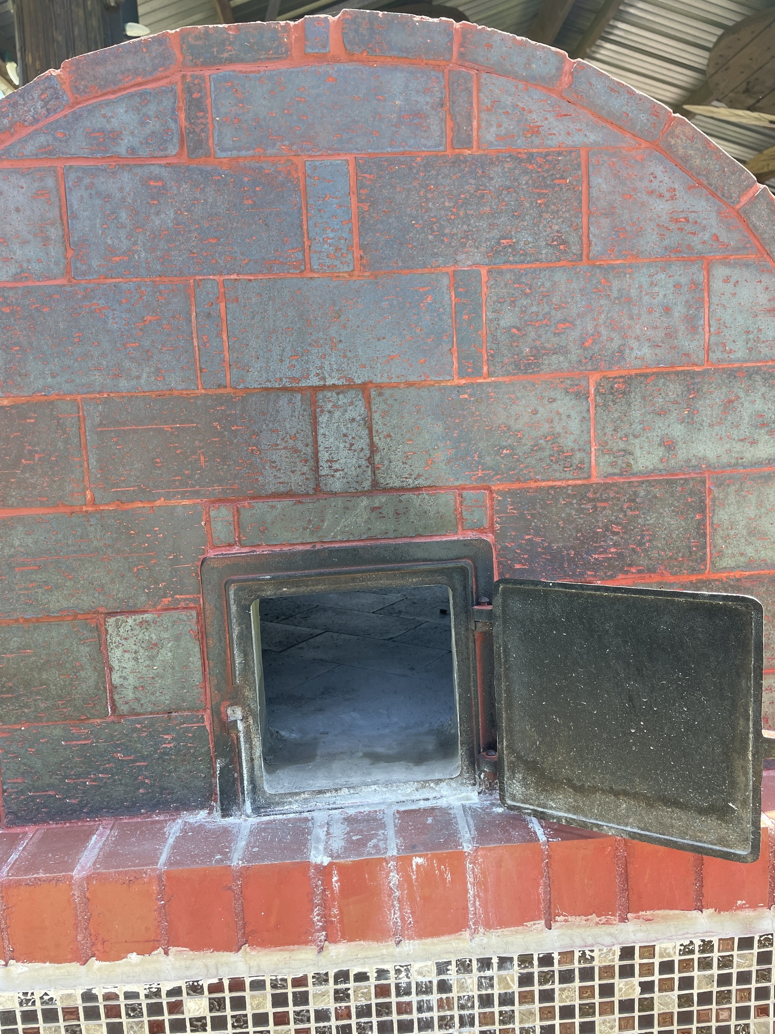

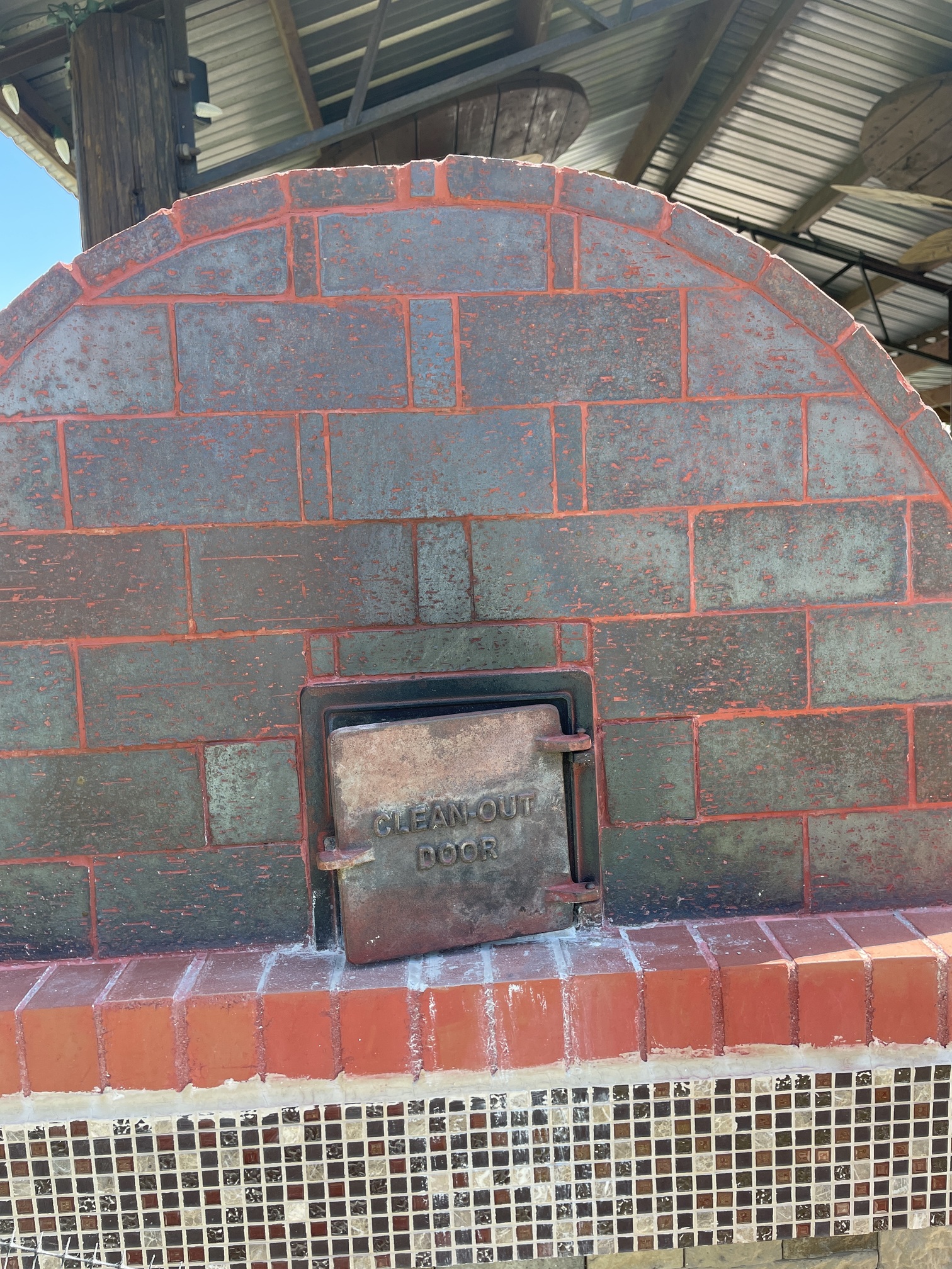

The gas modification looks great. I did a modification by putting a fireplace clean out door in the rear. When I have extended cook time, I can add wood from the rear. The door is small and I do not lose any heat. It also makes it easy to sweep out ashes to the back of oven.

The door is from Amazon. 40 bucks. I took the standard 4” wide fire brick and cemented them to the door on sides and top. Then I cut a square in the back of oven with a diamond blade about 1/2 inch bigger than that he finished door I made. I used fire brick mortar to put it all together. Been cooking a lot lately and I love the way I can sweep it out and load wood while the oven is cooking without having to toss wood over cooking food. I can really regulate the temp easily. I normally run my oven at 575 deg. I can keep it there easily with no fluctuations.
