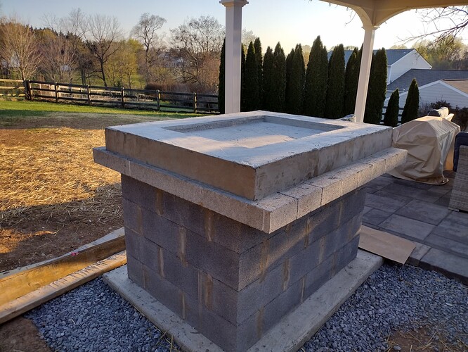

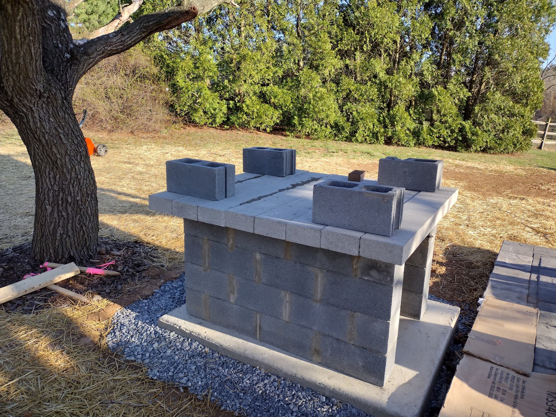

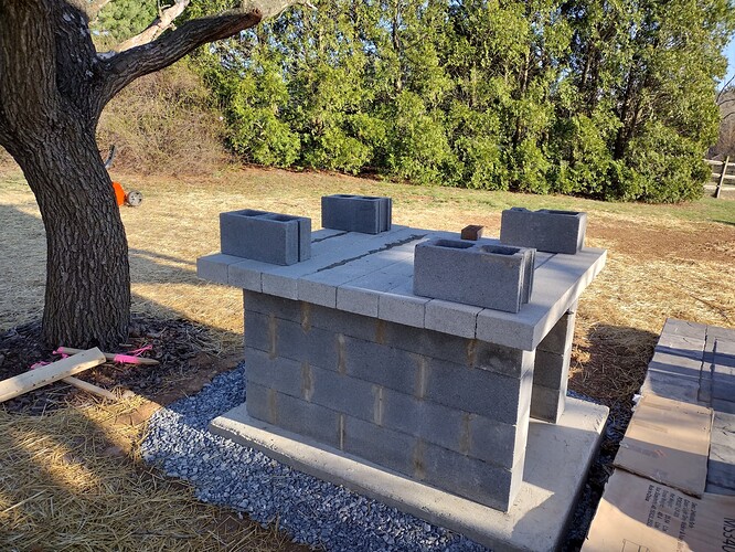

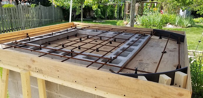

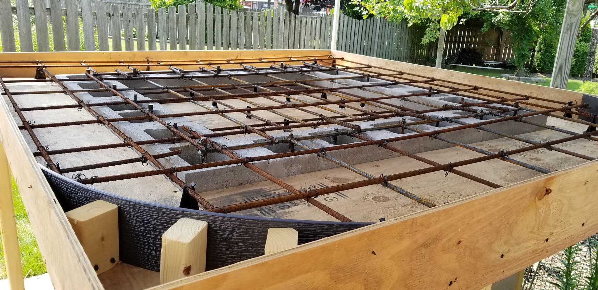

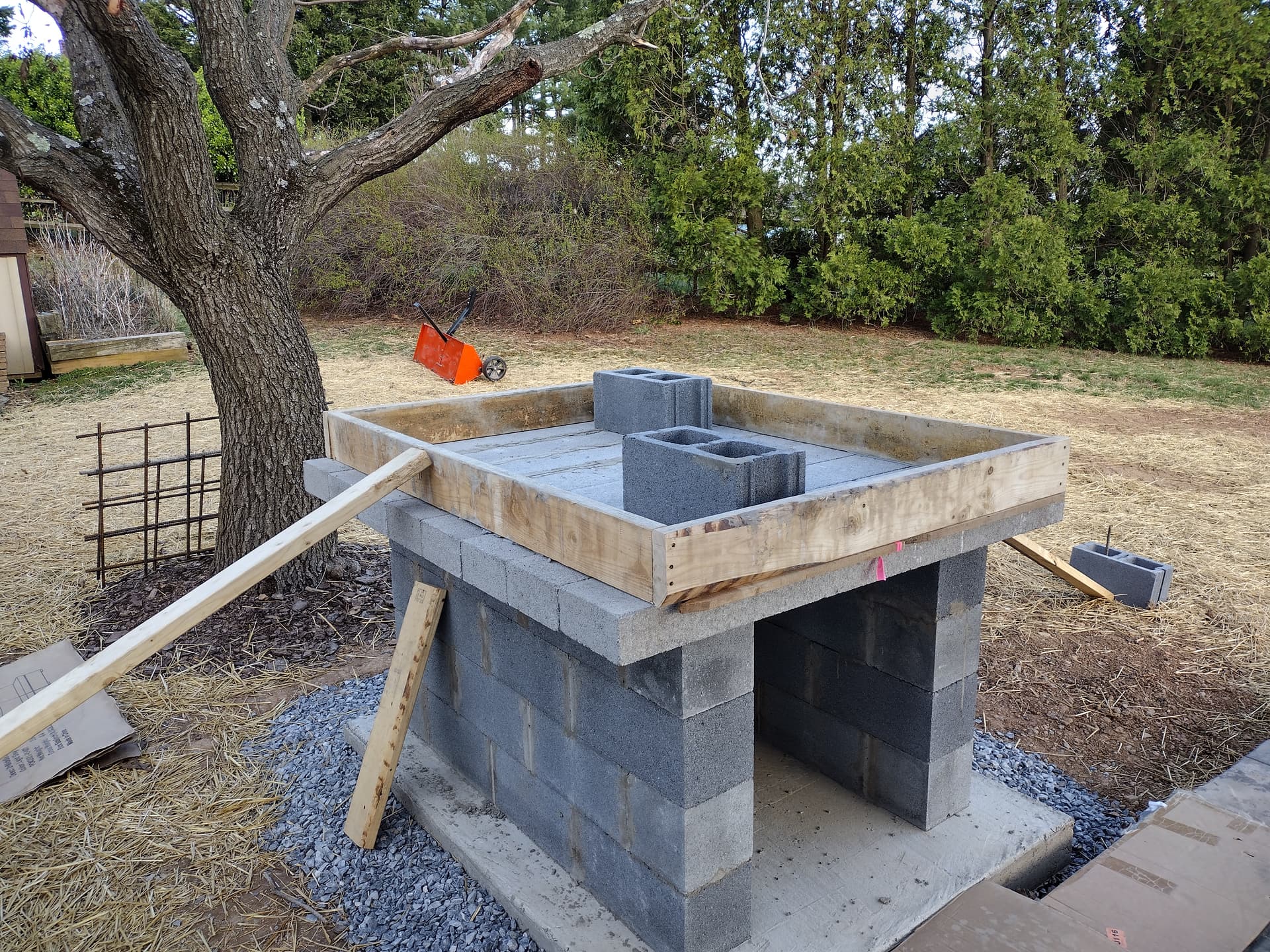

I think you will be fine. After all the plans are designed to hold the slabs weight. If you put half blocks in the middle it would not hurt but you will lose space for storing wood.Now because there was noway for me to lift the 3 slabs onto the base I too poured my top slab over the base.

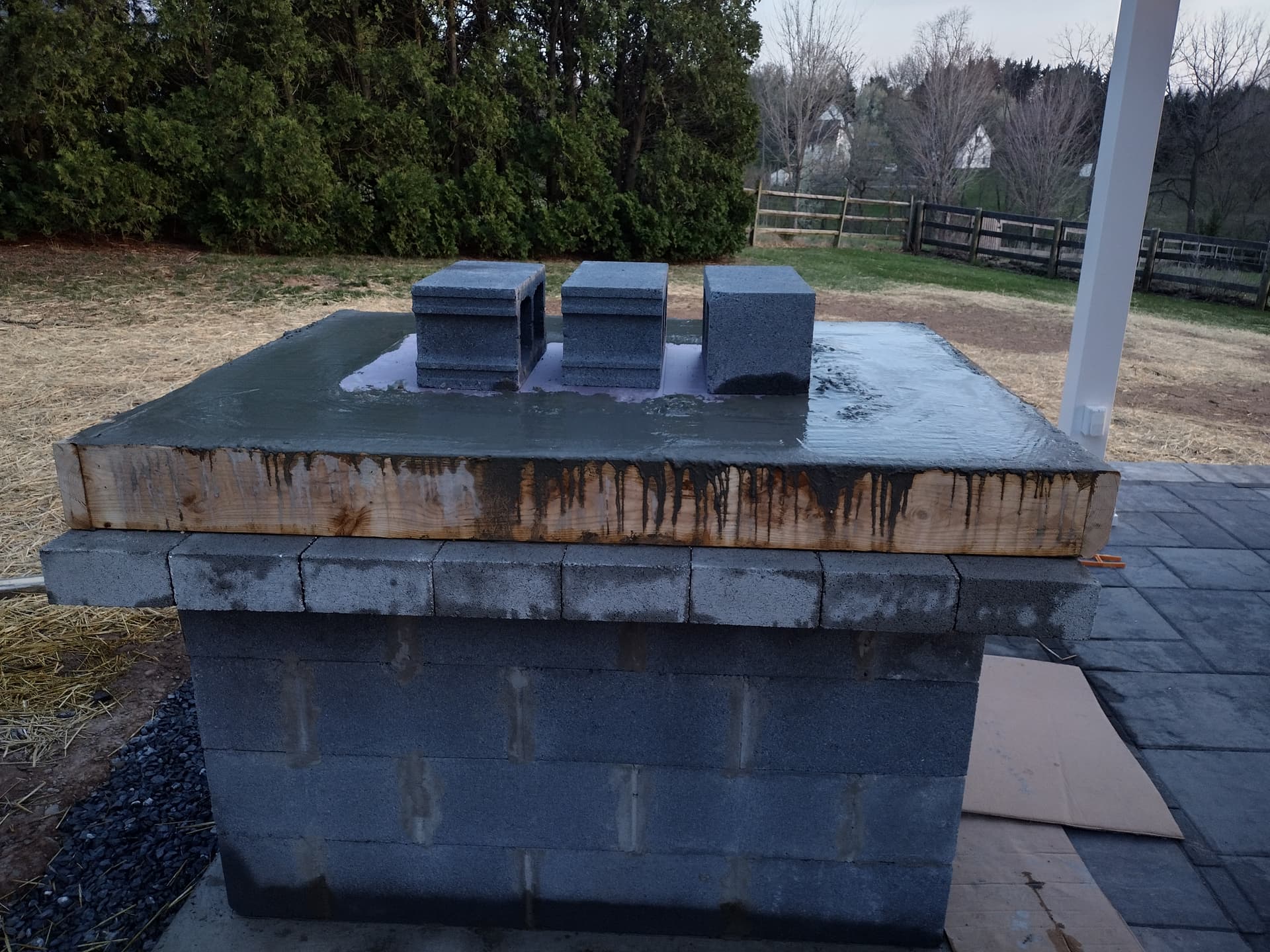

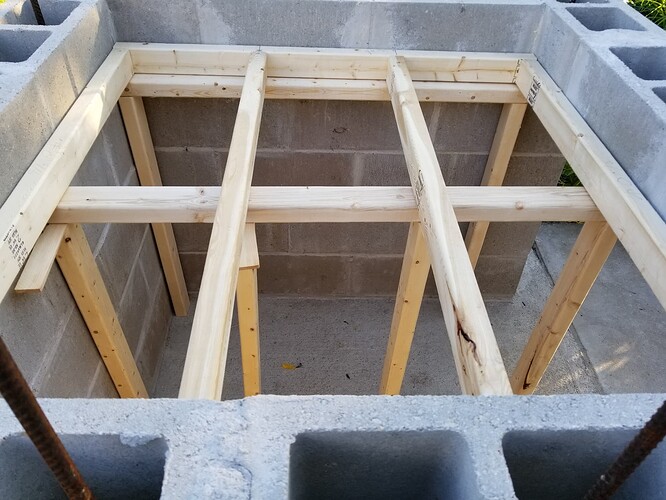

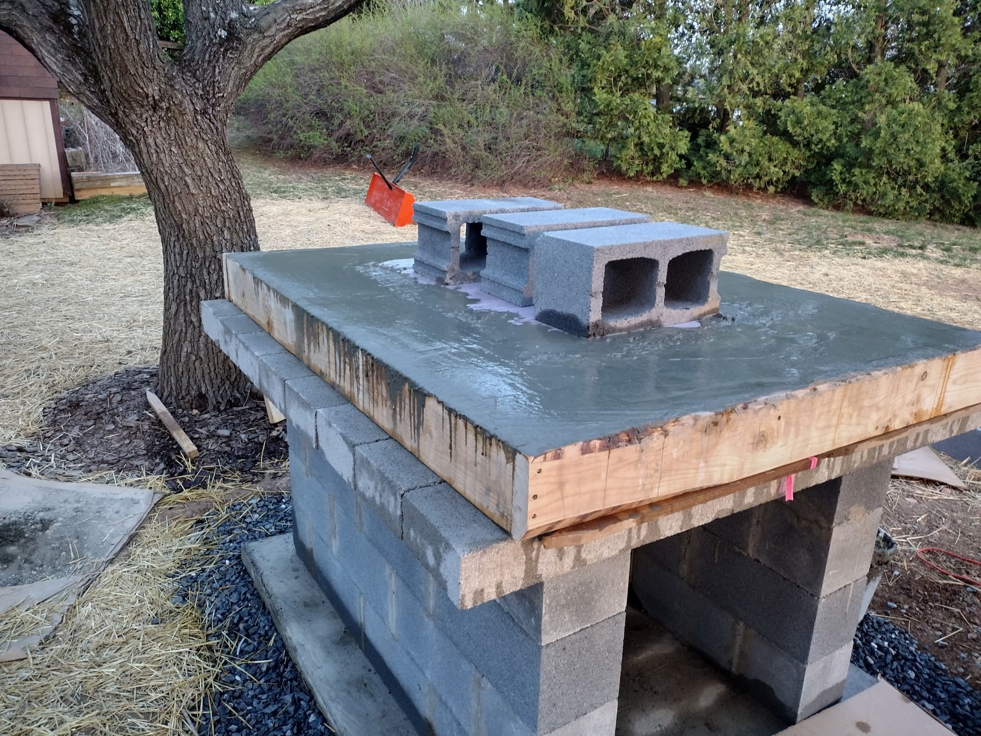

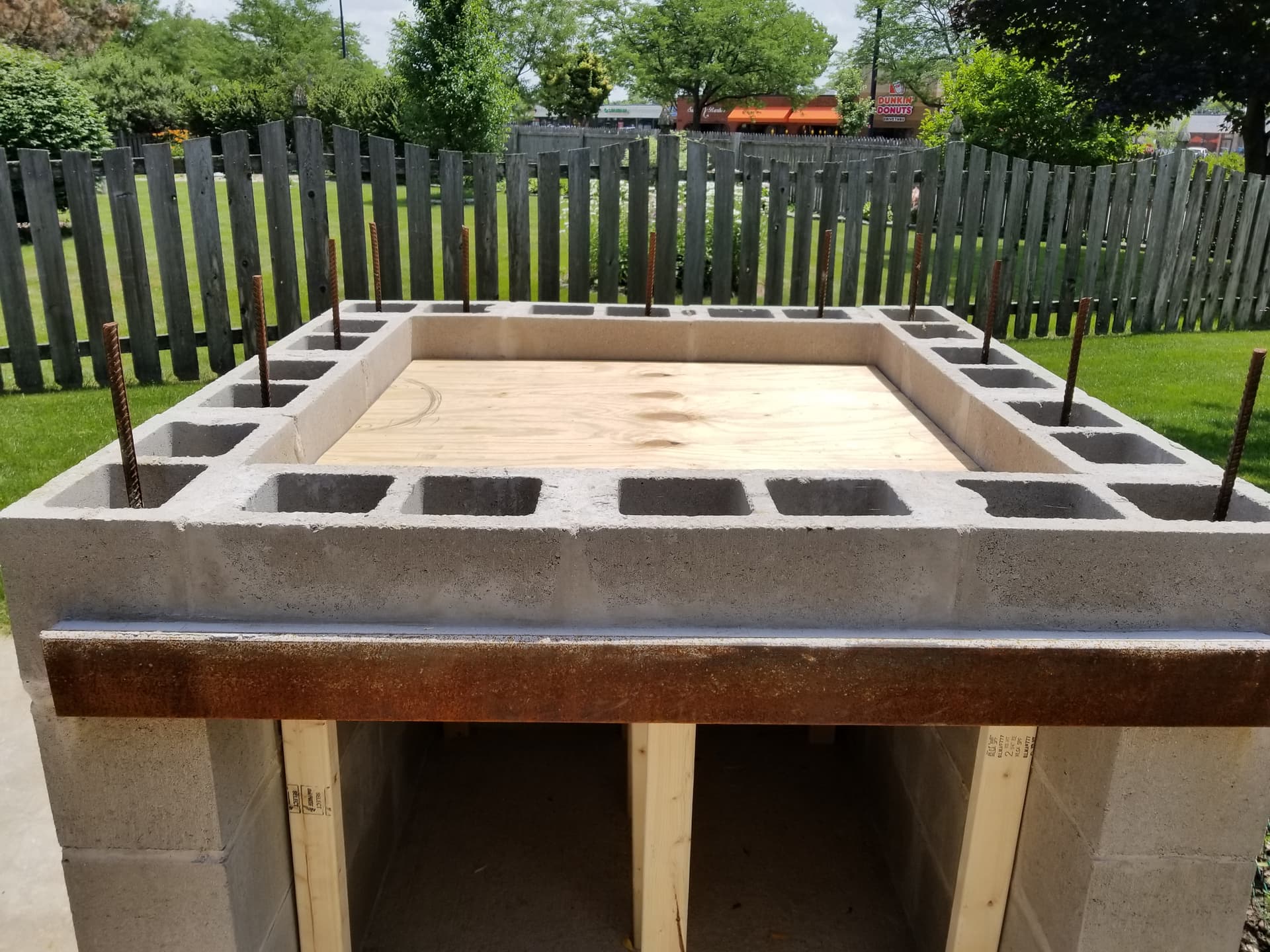

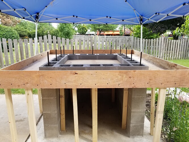

I have to first mention that I filled all of the cinder blocks with cement except forcthe last row. Then I build the framework for the slab then poured it. The idea was to not only for the slab to be supported by the base but also for the slab to physically set into the base. I’ll attach some pictures to help illustrate.
Hope this helps.
