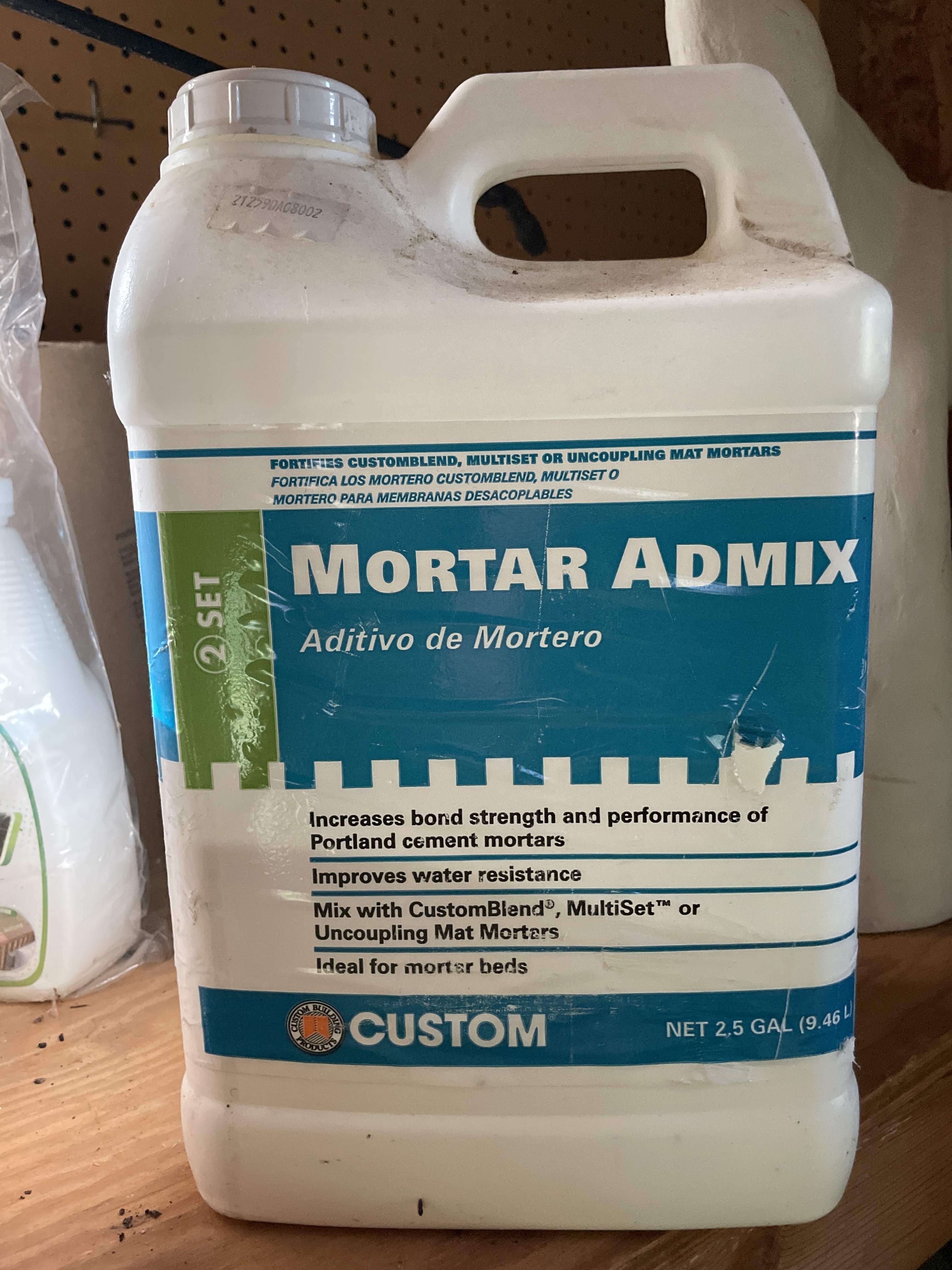

I set mine using the same S mortar but I added the bonding agent and acrylic fortifier to my mixes. I set my veneer in a small bed of mortar on the base to start my courses. I would also recommend a mortar bag to fill any gaps.
Thanks for sharing! Can you please elaborate more on what and how much bonding agent you added? I assume you added it to the dry mortar mix? Did you grout with the same mixture?
Sure, I used this with each bag I mixed vs straight water. I did use the mortar as my grout as well. That was where the mortar bag came in handy, just try and get a good consistency that isnt too thick but wont run out of the joints.
