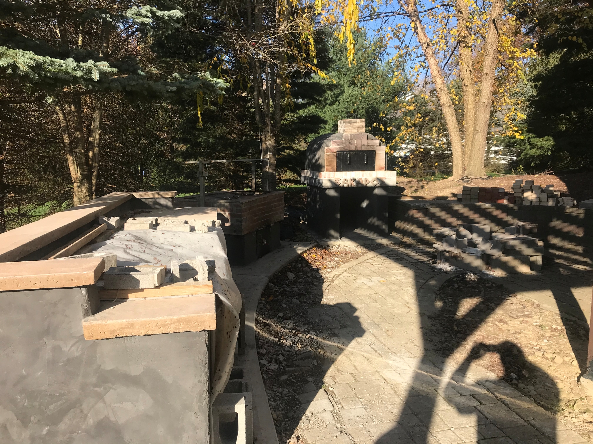

I still need to work on the pavers. I started with the pizza oven, then decided I could build the box and then kept it going with a kitchen (the plastic is where the built-in grill is going to go). I went with stucco for the base and used a charcoal color mixed in.

In addition to the cooking counter, it looks like there is more patio coming once you are done with your builds.
That’s how we started, too. Once I was done with our oven, my spouse and looked at each other and said, you know, that may have been a lot of hard work but it wasn’t that difficult!
And you were very smart to put the BrickWood Box between the pizza oven and the prep table. Many customers tell me that they love the fact that they can use the BrickWood Box as an elevated firepit / fireplace. Having a nice fire on the top section (upper oven) while prepping pizza on your prep table - and talking to friends while baking pizza… makes for a great night!
