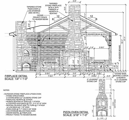

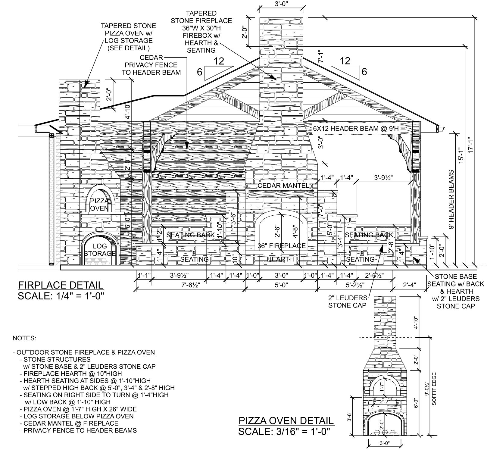

I have been contracted to build a covered extended patio with fireplace and pizza oven, the Barile Grande is the homeowners choice. After reading this thread, and others about the chimney height, I wonder if you have comments/suggestions of this modified design. I understand chimney will need to be moved to front of the structure.

First - Don’t worry about the chimney height. The taller the chimney, the better the draw (to a point), but many, many customers have built their chimneys this tall w/ no reported issues.
Make sure you close off the front of the oven a tad to ensure you force the smoke out the chimney vs. rolling out the front of the oven.
Don’t worry about trimming / cutting the bricks in the back of the oven as they will not be visible.
Wrap the oven w/ 2 layers of Ceramic Fiber Blanket and attach with Chicken Wire (NO STUCCO NEEDED). Then dump a couple of bags of VERMICULITE or PERLITE on top of the enclosed oven to insulate the oven.
