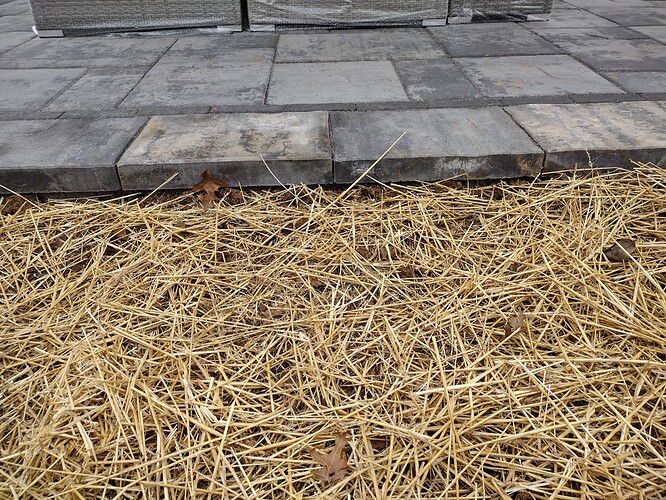

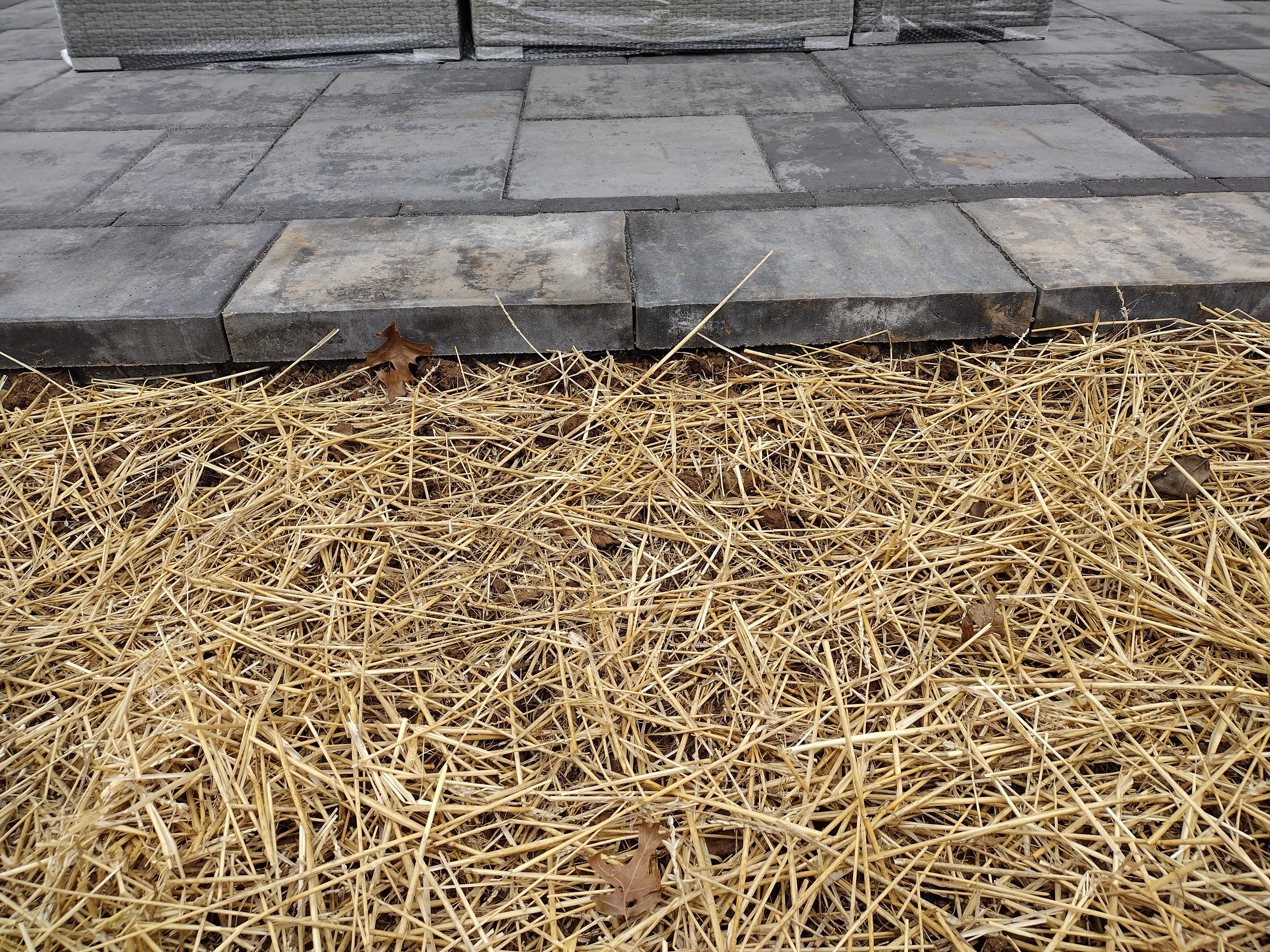

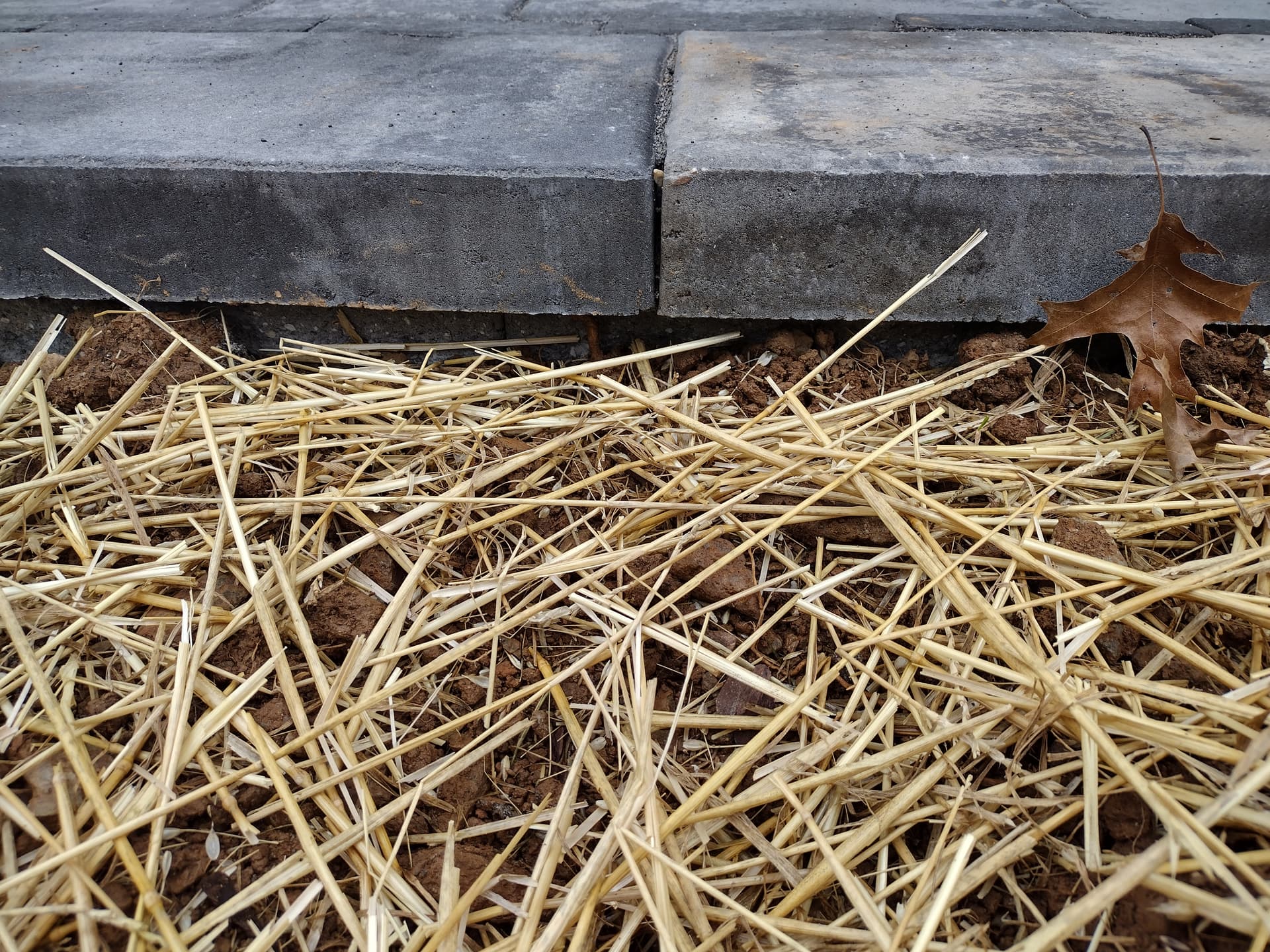

Our patio was just finished so I can start building my oven! I have a question about the base slab. My patio has a short retaining wall (about 8" above ground). Should I make a 3 sided form and use the retaining wall as the fourth side of the form? If I make a 4 sided form adjacent to the wall would I just leave the adjacent board in place after the base has set and remove the other 3 boards?
Here are a couple pictures. The stone you see is a cap stone on top of retaining wall block, the wall is almost completely buried at the point where I will build the oven. Thanks!

Thanks very much for responding. My description is not clear, sorry. The surface of the patio is at most 8 inches above the ground and I plan to build the base adjacent to it. So fortunately, there is no hillside to contend with.
My question: if I butt the base wooden form up against the short retaining wall and cap stones how can I remove it after the concrete has set? Alternatively should I make a 3 sided form with the 4th side being the retaining wall and caps? My sense is that I should leave a gap between the form and the wall, but it would have to be very small so I can step onto the base from the patio.

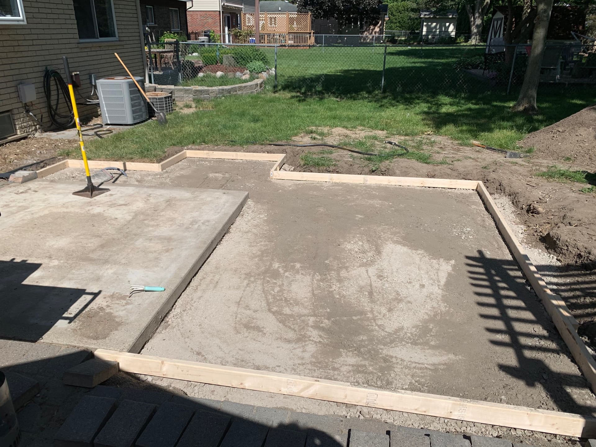

I think I understand what you’re asking. Here’s what I did. Hope it helps…
I had an existing 8’ x 8’ concrete slab that used to hold my hot tub. I just tied into the existing pad and
poured concrete right up to the existing edge. Not shown in the picture are some sections of rebar that I drilled and glued into the existing slab to provide more structure to where the new concrete met the old concrete. Seems to be holding up fine.

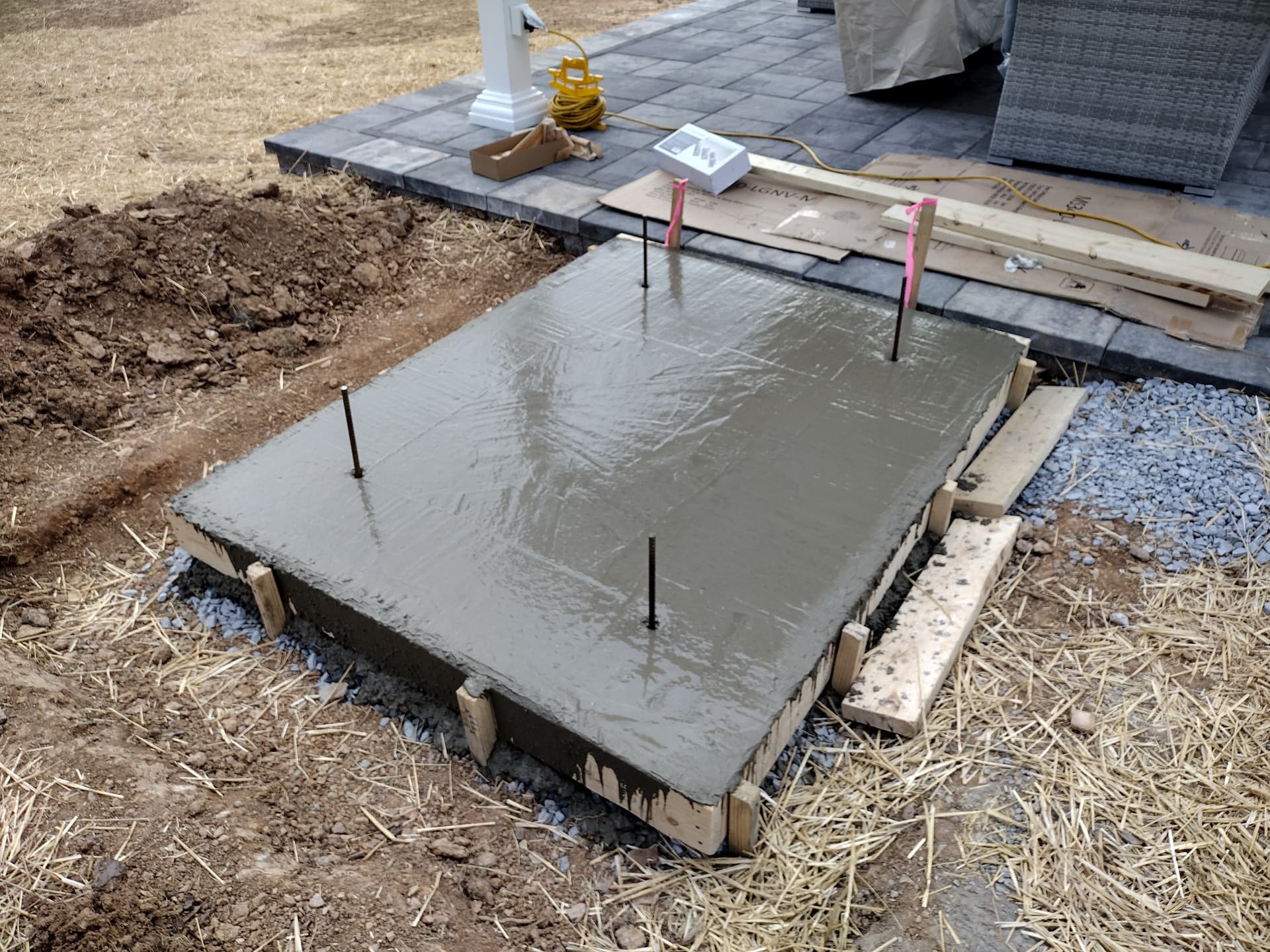

Thanks Ken, yes that answers my question thank you. After going back and forth, I decided to keep the base separate. I just completed it today. It’s a few inches from the patio, enough room to hopefully remove the form.
