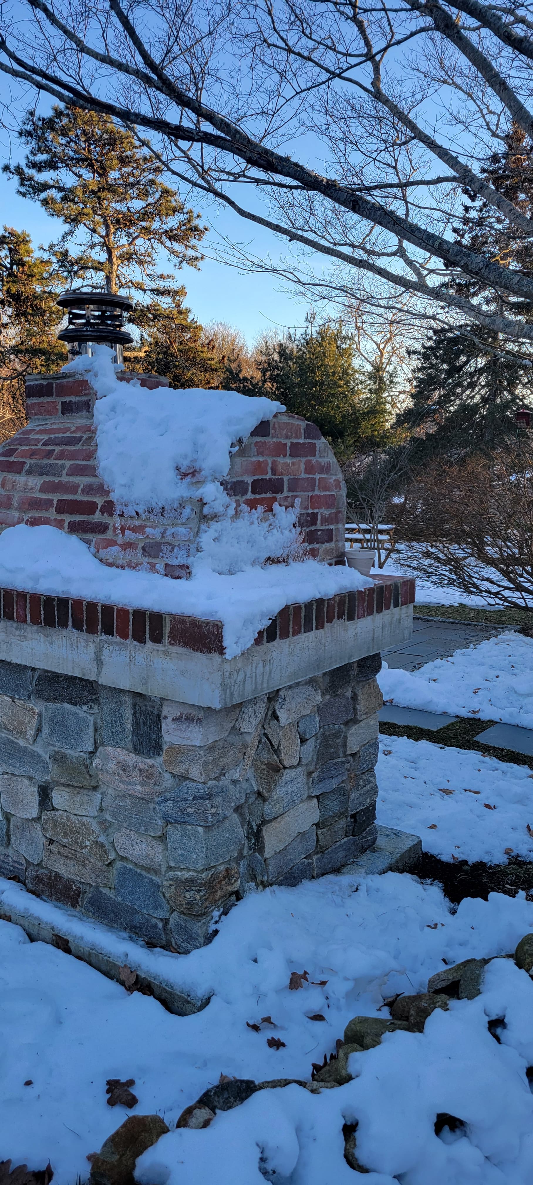

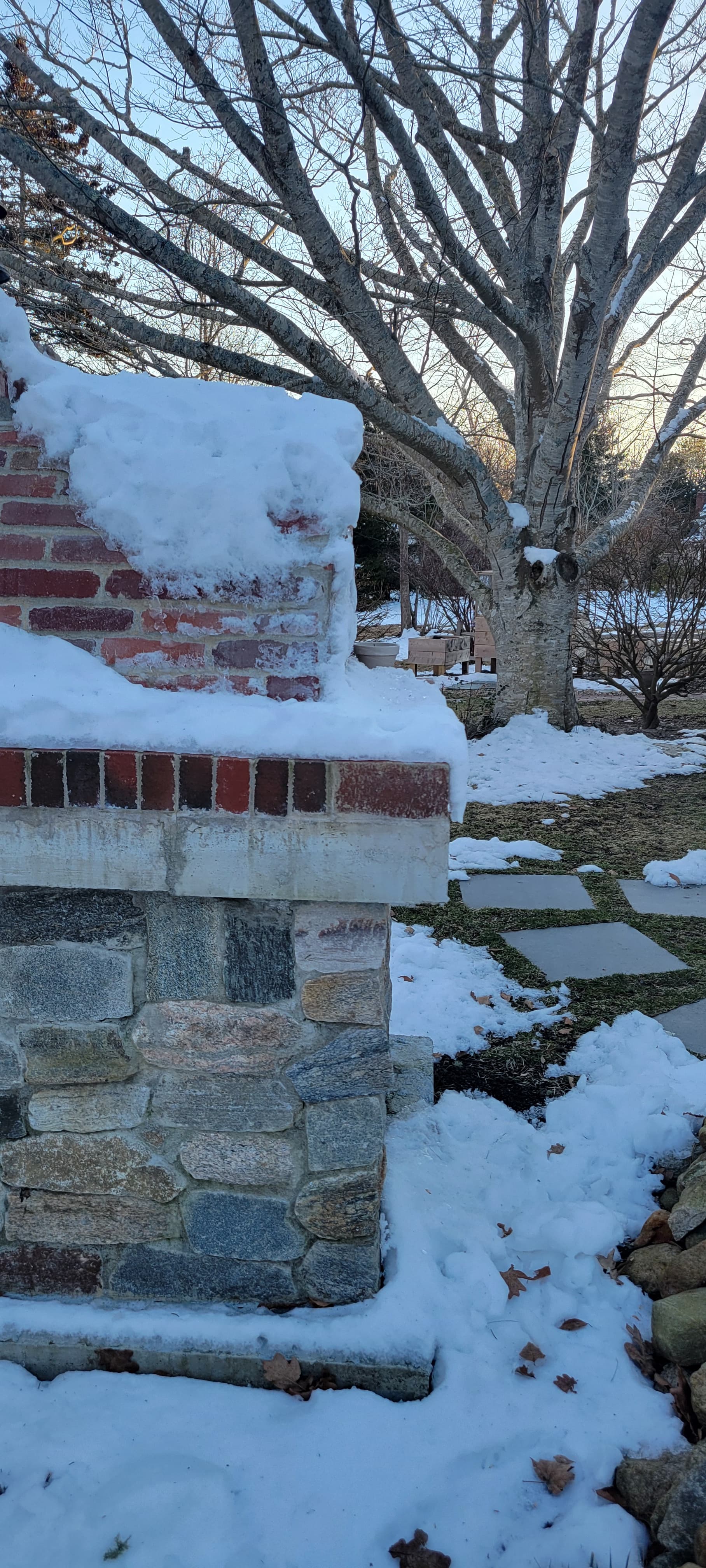

I could use some more heat retention in the back of the oven. Should I, could I put another reinforcing layer on the backside? i.e. either another set of bricks (which I have room for) or another insulation layer or a vermiculate/refractory layer? thank you Bill

Thank you for the initial response. I have found that the right side of the oven does not retain as much heat (slower to get the temp in the seven hundred degree range+) so that the pizzas cook quickly, thus, I have the left side pizza cooking faster than the right side. Not a huge deal but I thought reinforcing the back side of the oven would help? I have room for another row of brick / mortar/ insulation etc.
Also, can I fill in cracks/gaps in the ceiling fire brick?? Might that help as i have some of these…
Thank you very much. Bill

My opinion is that adding more insulation to the back wall of the oven won’t help with that issue, unless you are feeling heat (not just warm, hot) on the shell at the back, on the right side. Even if you have the room, it won’t do much for you.
Following is some general information and an order in which to proceed.
Your oven is designed to manage heat in a couple of ways:
- by absorbing heat into the firebrick and then radiating it back into the oven
- by keeping heat from getting past the outer surface of the firebrick
The arch or barrel shape convects heat and keeps it in the atmosphere, and the burning wood radiates infrared heat.
The barrel absorbs and radiates the bulk of that heat down, toward the floor, rather than through the front and back walls.
Unless you have spots in the rear wall that have no insulation whatsoever, you’re not going to gain a lot by adding more there.
Something you could try is to build your fire by cheating it toward the left side of your oven while it’s heating up. See if that heats your right side up more.
Many of us set up our fires by starting at the front, then pushing the entire fuel load by stages gradually toward the back (say, every 20 minutes or so). When it’s time to bake pizza, you should have a roaring flame along the back wall, with the flames licking up and maybe a third of the way into the top of the barrel. That should give you the even coverage you’re seeking.
If you experiment with things like this and are still convinced it’s a problem with the rear wall construction, then you can think about adding more brick back there. If you do, keep in mind that for it to be effective, you will in effect have to rebuild the back wall (carefully remove stucco, cut away chicken wire, and fold back any insulation) because your new materials will need to be in contact with the original construction to perform the insulating function you want.
You already know how to lay the brick for the curved back wall, insulate, and stucco (which will need to be sealed to the existing stucco along the barrel). And the bright side is that you’ll be able to see if something “went missing” (it happens!) when you were building that end the first time.
Hope this all helps, Bill. Let us know your progress here, and we love photos on this forum!
