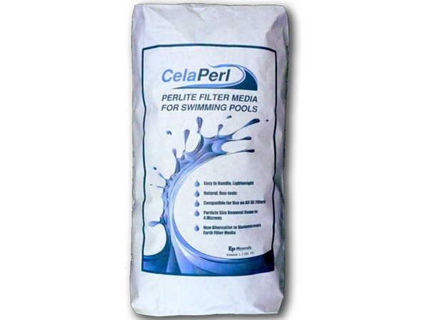

I’m having a hard time finding Vermiculite or Perlite or Insulating Castable due to COVID. I found a pool supply store where I will be buying my Silica Sand, they also have 25lbs bags of Perlite under the brand name CelaPerl. Does anyone know if I can use that?
Really? Nothing in your local Homedepot or Lowes? Check their garden section there are heaps of the stuff and very cheap. I don’t know Celaperl but reading the description it should work too.

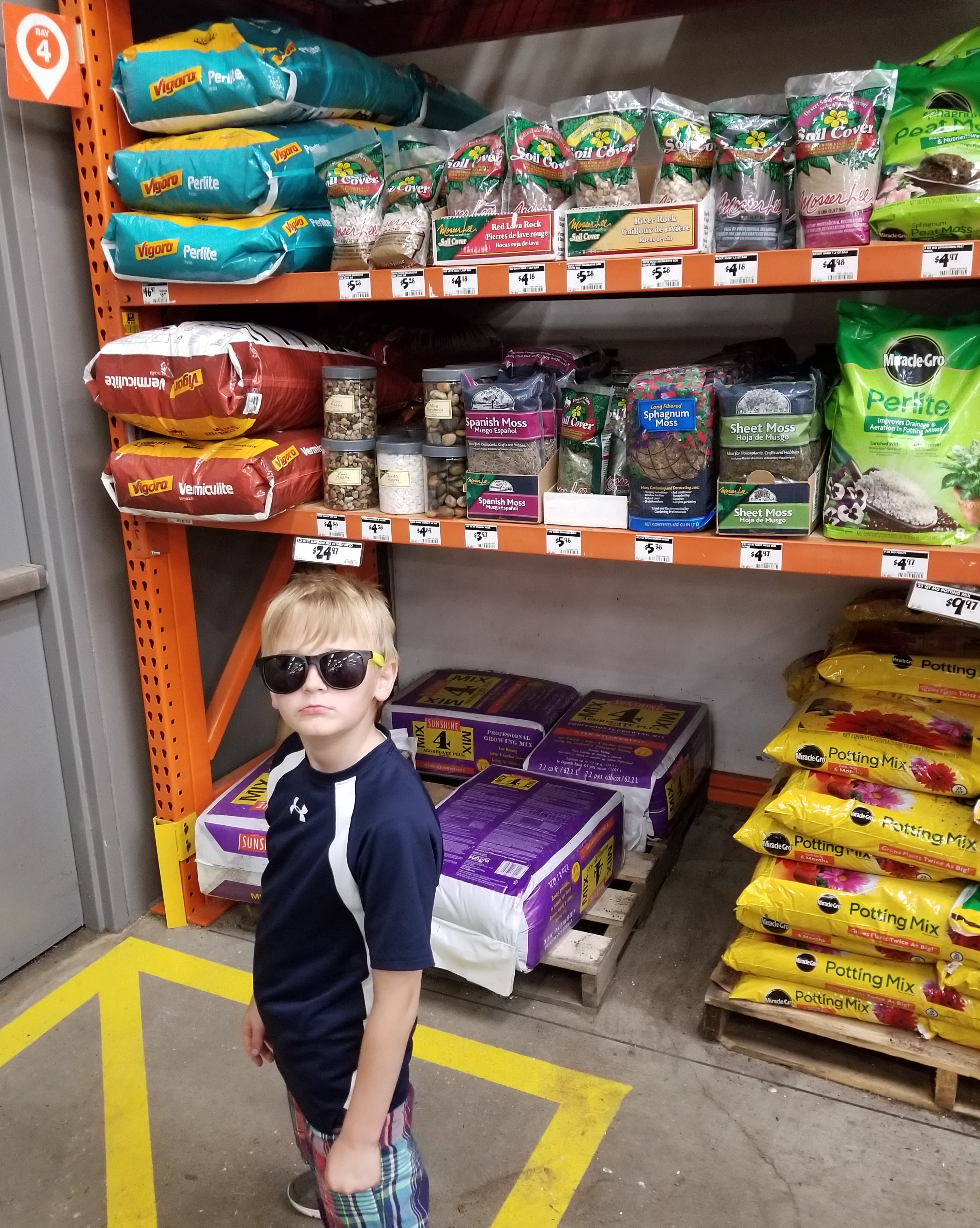

ALSO - Make sure you check the INDOOR PLANTS & Supplements section (see pic below). I was looking for some CoCo Liners the other day and found 3 different brands of Perlite / Vermiculite at HD… but they were located in the INDOOR PLANTS section.
