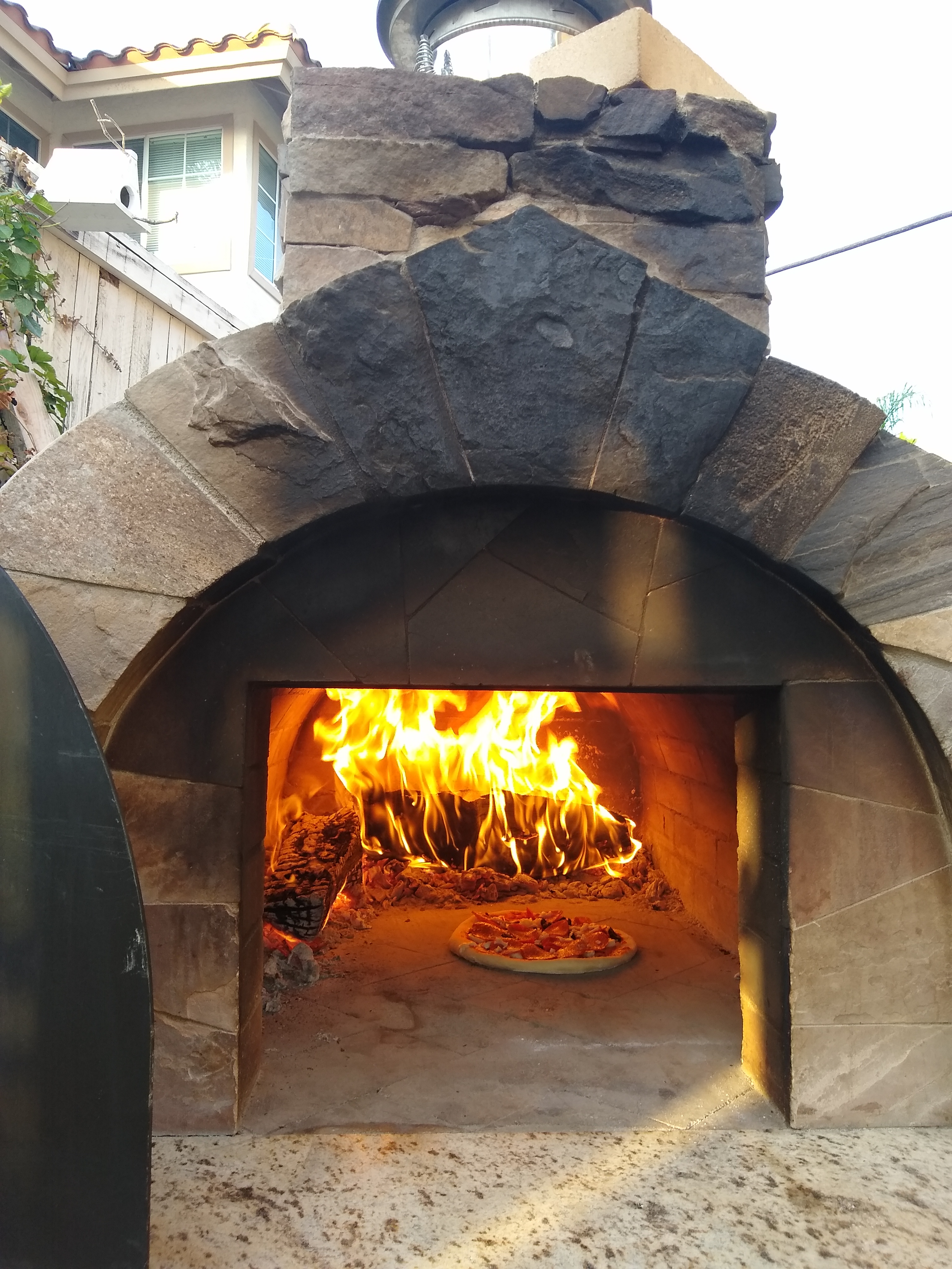

Hi Len, and thanks for posting the photo. I’ve put up the “Bat Signal” so that other eyes can take a look at it. It does look like you have a good fire there. I’m also presuming you’ve checked the questions in my previous reply, especially the one about the wood you’re burning.
I don’t want you to have to spend money on a chimney extension unless it’s truly needed. @BrickWood can tell you whether that’s true.

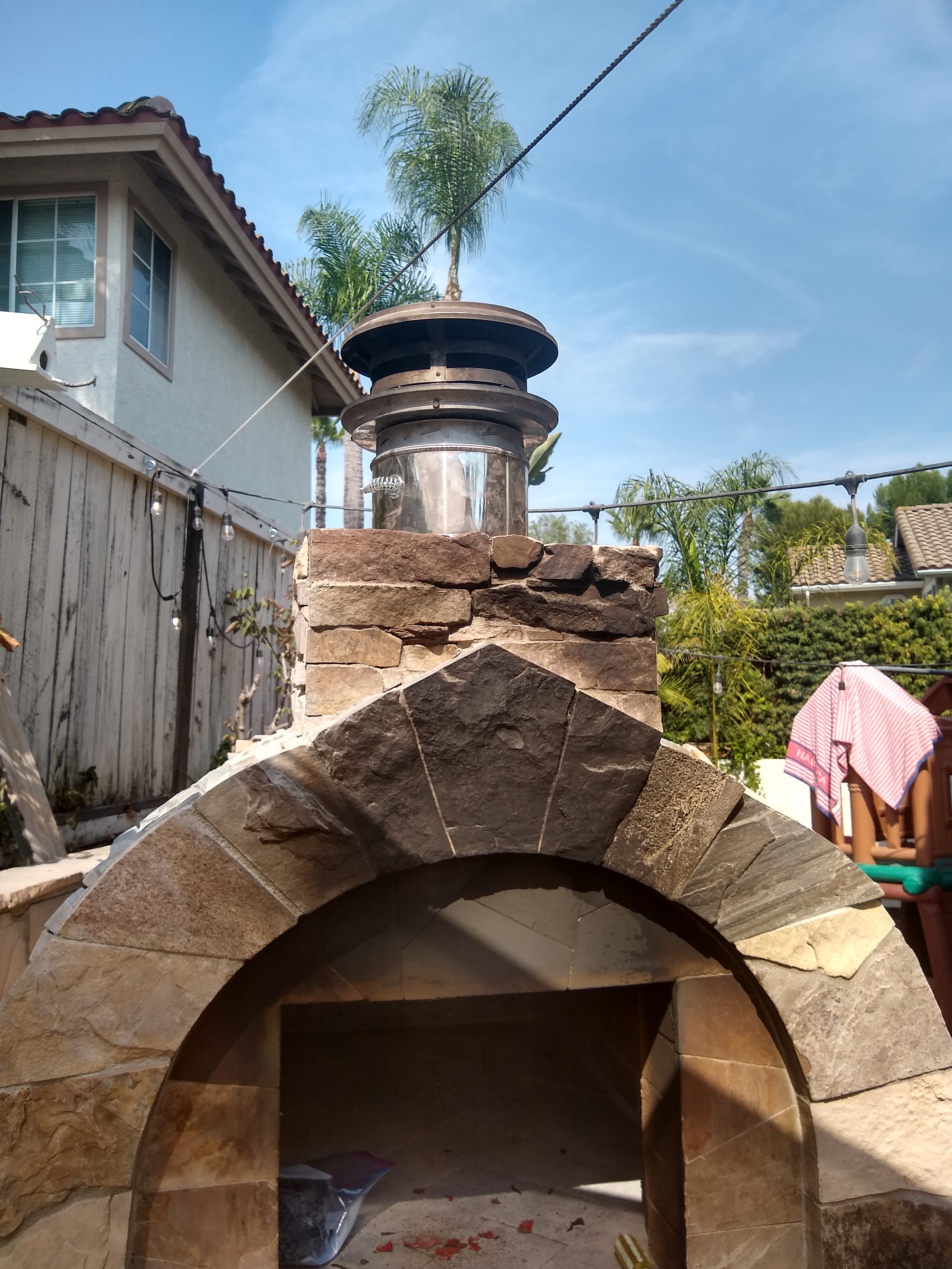

First glace… that chimney cap you have looks to be limiting airflow. It looks almost sealed vs. wide open. Can you send me the model / specs of that chimney cap plz?
Also - take the cap off and give her a run. I’m thinking that vent cap / chimney cap is blocking the airflow.

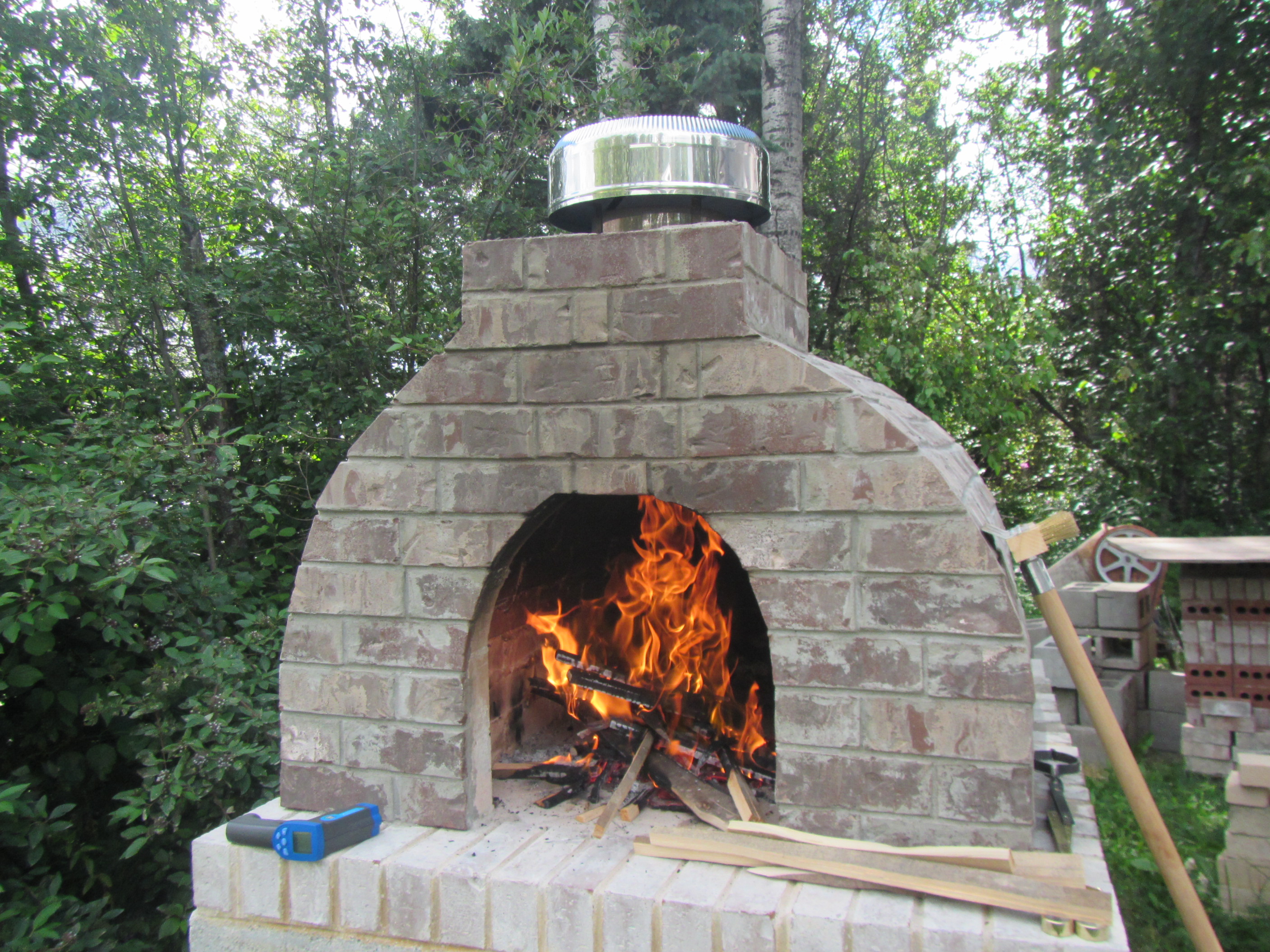

I payed two extra courses of fire brick in my chimney with damper and standard chimney that comes with the full grand kit. I have plenty of draw. The front of the oven still gets black. I even have an inset for the door. We make great pizza and bread, the dark color ads character.IMG_20200821_183626470|375x500
