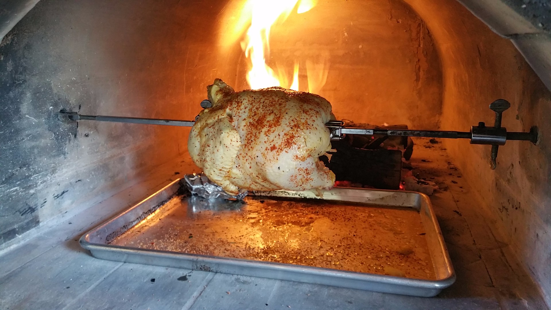

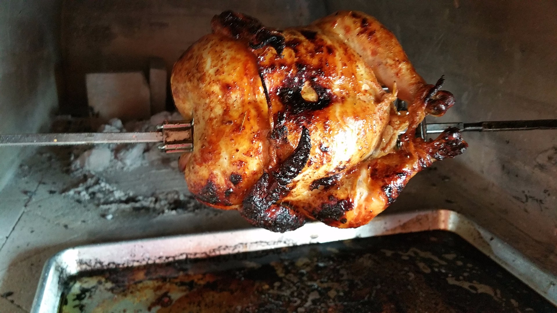

We don’t recommend a chimney pipe on the Mattone Barile series ovens as they are an open-faced oven. Meaning they aren’t closed off like other types of ovens (like our Cortile Barile & Mattone Cupola). The larger opening allows the oven owner to comfortably use their ovens for more than just pizza & bread. With the larger open face, you can use the oven as a wood-fired BBQ, smoker and a couple of customers have even created a homemade rotisserie (see pics below). This is something you can not do in a closed-front oven. So the Barile series is more than a pizza oven - it’s a UNIVERSAL oven!

Thanks again for the information. I think I’ll just go with the kit. Planning on working on the main oven this weekend.
But now after seeing those pictures you got me thinking a rotisserie. Lol!

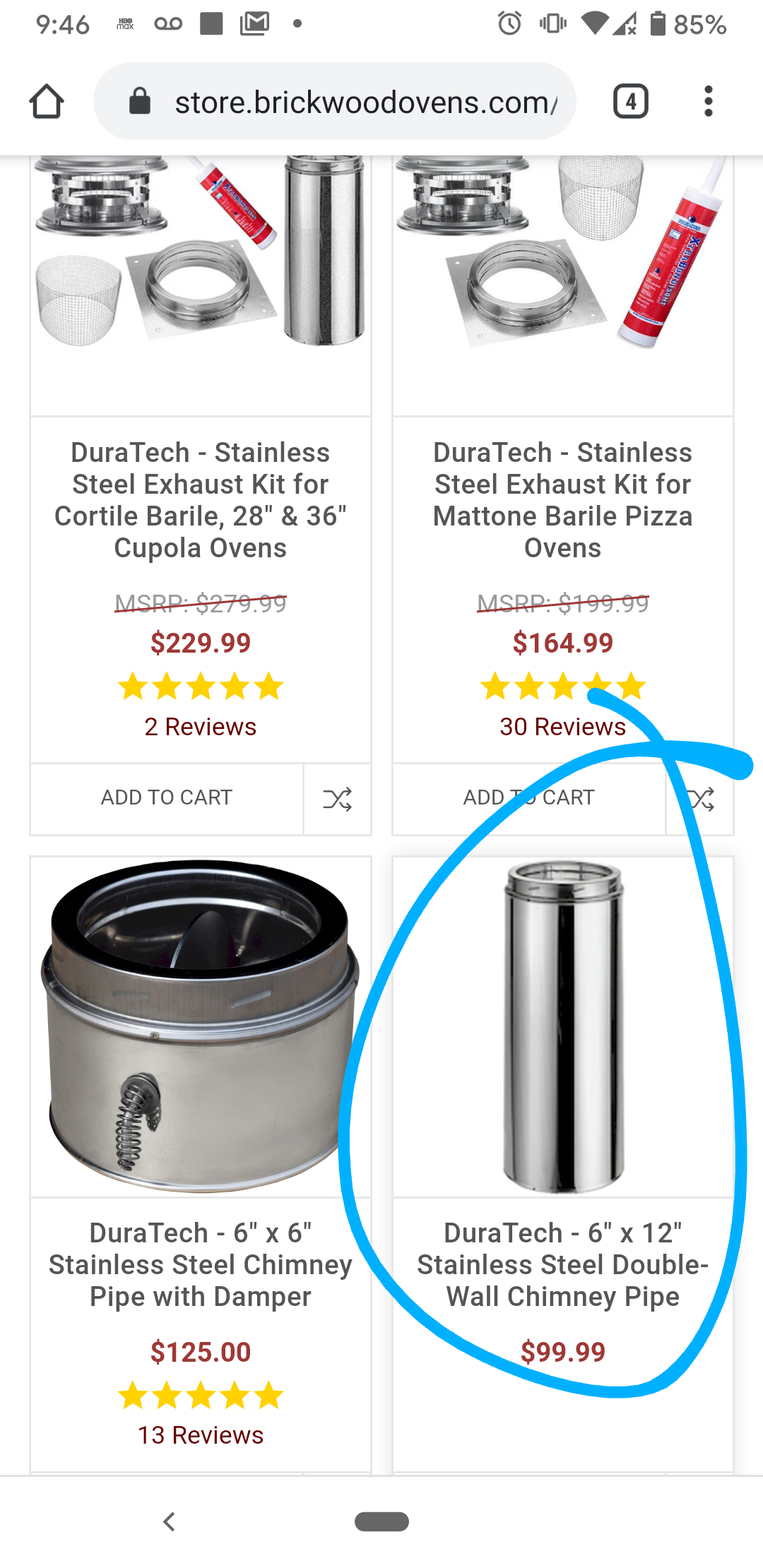

Bill, I think you are overthinking this a bit. Brickwoodovens sells a chimney pipe that goes between the anchor plate and chimney cap. I’ve attached a picture of the pipe. That item is not recommended for the mattone barile series. If you’re not sure about the damper, you can add it later. It just twists together.
As for the overthinking, I did the same thing. Part of the process.
