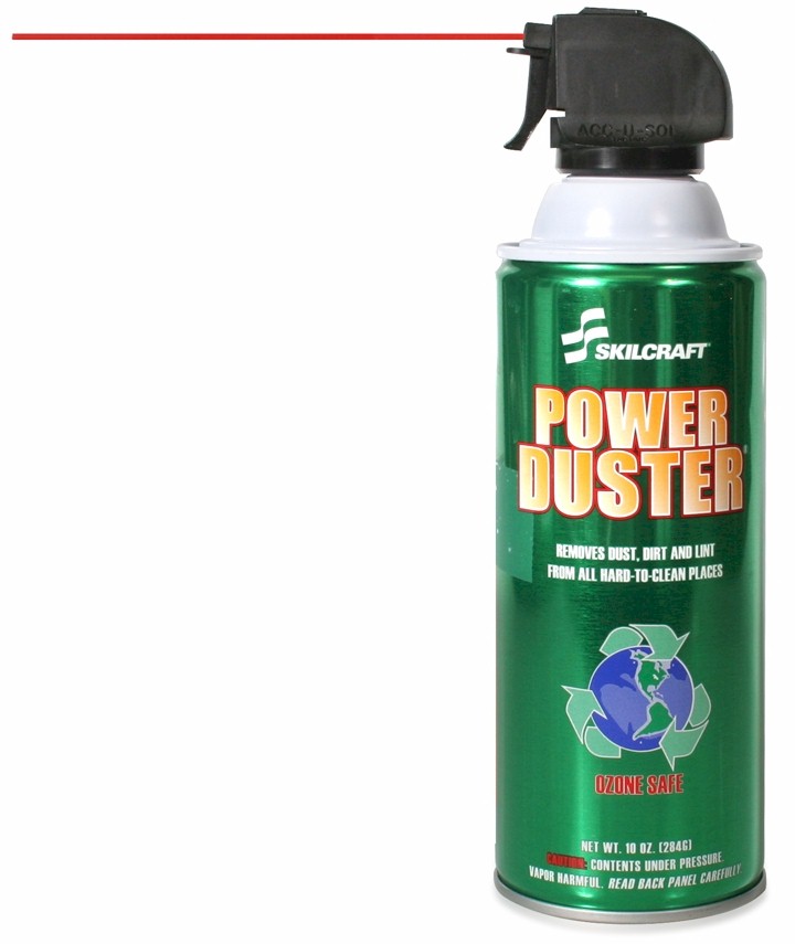

Once the surface is clean, blow on the surface w/ a few deep breaths to remove any remaining ash. If deep breaths are difficult - keep a can of compressed air nearby (but keep away from the fire). Blasting the surface with short bursts of compressed air will remove the surface of any lingering ash.
