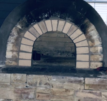

I closed off the front of my oven using an arch, but then after I did it, I went and used a calculator for an ellipsis. It is roughly half brick all around (some are shorter at top to line up). 13.5 inches vertical, and 17.5 inches horizontal. If I am using an ellipsis area calculator correctly, that would be 371.1 sq inches in a full ellipsis, but at half of that, we are looking at 185.55 sq inches opening in the front. So what happens if we fall below the 244 thumbs up mark? I can fix fix by removing some of the brick.
@BrickWood , @bikerbudmatt Incase this is in a place you all don’t see it, I thought I would tag you. I also figure with it being winter, up north, builds are slowing down. Thanks in advance for thoughts / opinions. I have the the oven covered for now and will brick veneer in the spring if it isn’t too rainy!

Ya I figured that may be the case, but was hoping the opening would be big enough. Think I need to grind some off? I followed the directions on width and height, but just laying in bed one night…the ellipsis, thought came into my head. I can widen with a 8 inch grinder.

I never encourage anyone to grind / remove if they don’t have to. Actually, grinding is the LAST resort… cuz it’s permanent!
PS - We have several oven pics from customers w/ smaller openings than what I see in your picture.

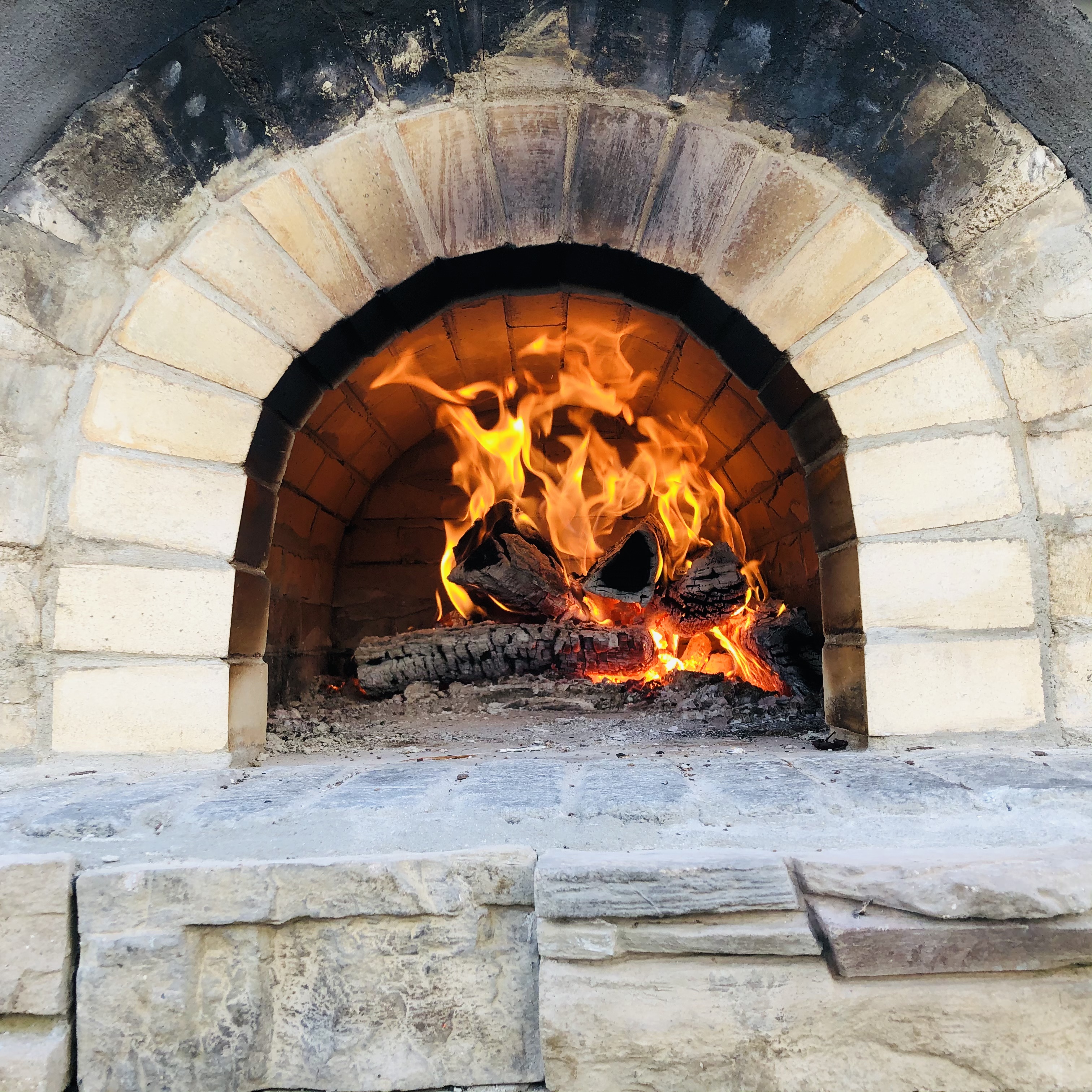

Performance has been spectacular. Oven in about 2 hours gets to over 1000 F, my laser thermometer cuts off at 1012 and reads high. Walls at 800 + and floor easily at 800 +. Raging fire as you can see with the smoke coming out. However, all of this was before I added the closure…I wanted to use the oven sooner than later and figured I would clean the brick (I did) and add the closure towards the end of the season (Winter is here in Ohio).

Just thought I would post an update… no problem getting a fire started. Ceiling above 1000 f oven floor at 750+/- and if you look closely at the bricks closing you can see they turned white on the inside and register about 630F. Happy with the modification, but am going to have to be careful putting in additional wood and make sure I don’t bump those bricks. I usually wear welding gloves anyway hehehe
