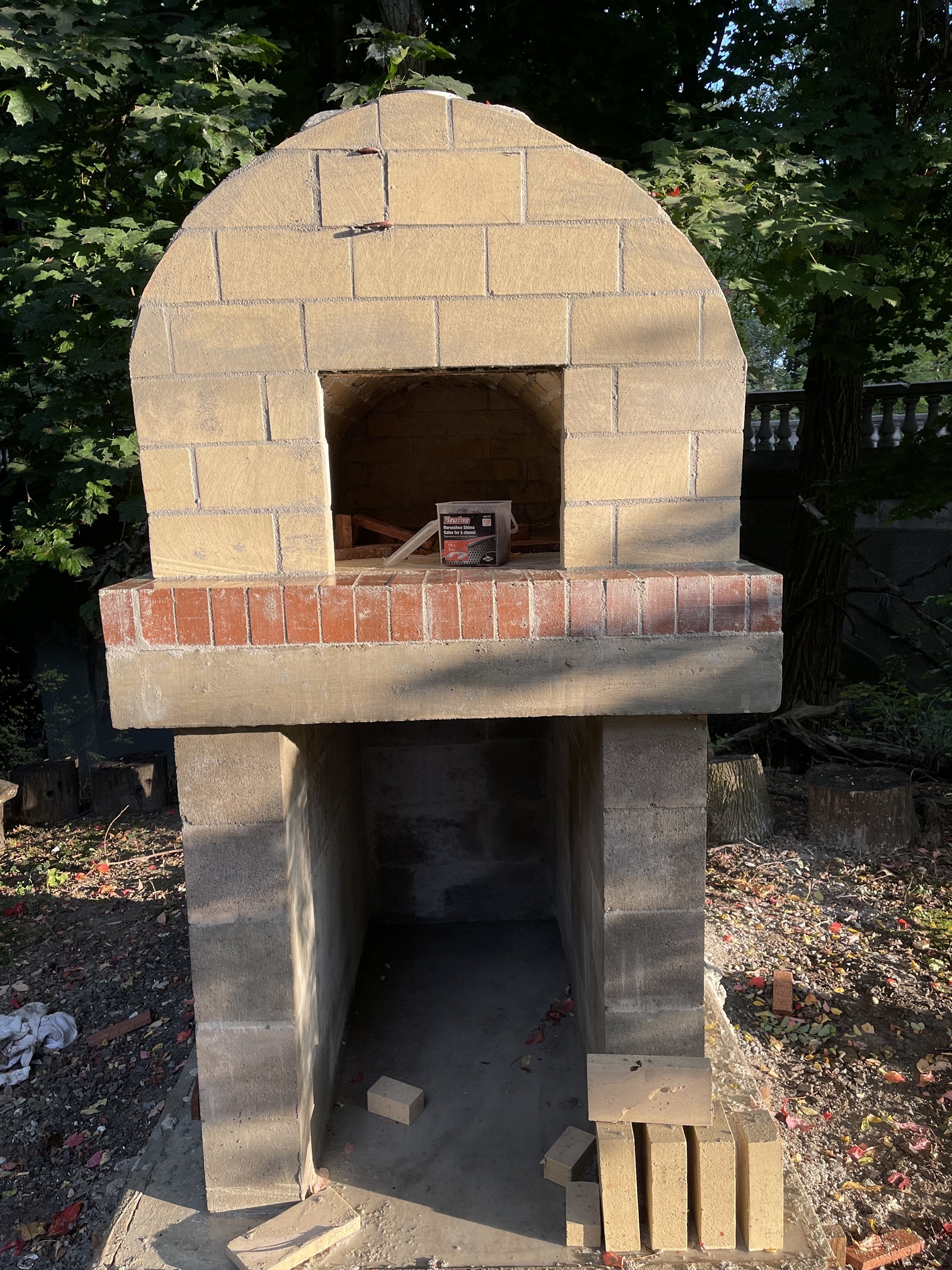

Ok. I’m lazy. I’ve got a seam where the brick doesn’t overlap on the top left/center. Worth redoing it? Or not a big deal. Please say it will be fine given it’s location. I’m tired.
But, if the answer is to pull it off and fix it, I’ll do it.
Not veneer? Be happy.
There is a small theoretical chance of a crack if that was three courses rather than two. But those seams don’t line up; they are just close.
And you are applying veneer over that, yes?
So pay attention when you apply the veneer and you’ll be fine. Only you will know, and you’re not going to worry about it.
Yes, I’ll be applying thin brick over that.
What you see here is the firebrick that I used to close up some of the oven mouth.
Thanks Matt!
