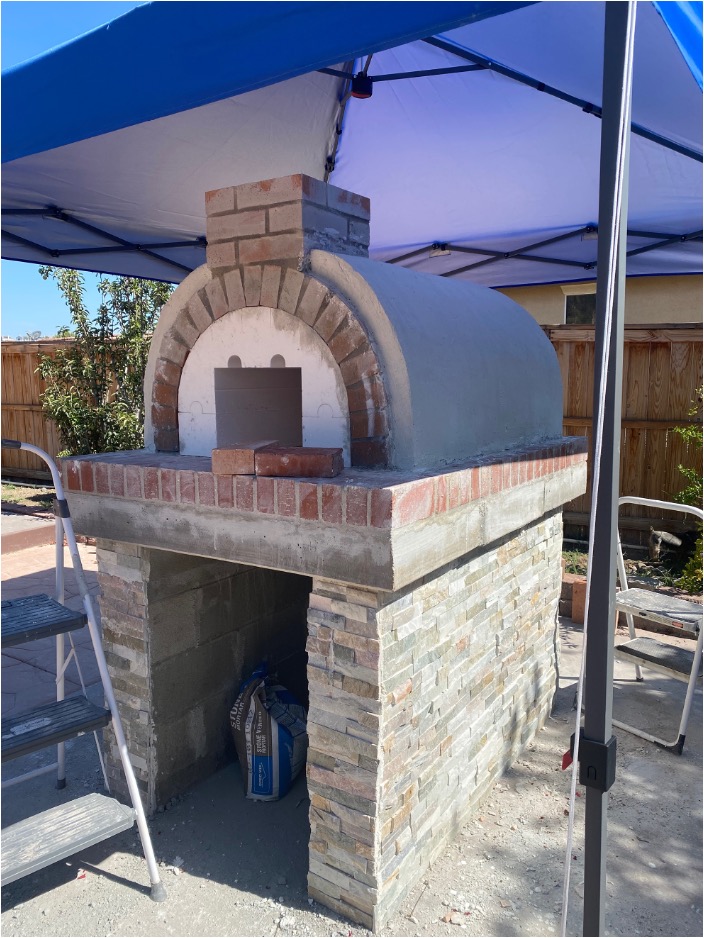

I’m moving slowly but I’m getting there
I want to close off the front after I remove the foam, and any suggestions are greatly appreciated from all of you that have completed this phase.

Great job on the stucco shell! The whole thing looks fantastic.
You’re making great progress, Lia! Thanks for this photo.
The foam is serving no useful purpose, and the longer you leave it in, the more difficult it will be to remove it.
As for closing off the front, we haven’t done ours yet, but probably will this summer. The prime tip is that you can wait a while if you’d like to see whether an open oven is to your taste, and then close it off if you prefer that. It will involve some cleaning of the front before you start so that there’s no issue with mortar, but other than that it’s totally up to you as to when you do it. This link will give you some more details on that option.

Thank you so much. The first layer of stucco scared me because it was cracking. On the second layer, I followed @BrickWood, and
Shaloha Creations advice to keep it moist or cover it with damp towels and plastic, it worked great . And lastly I mixed some white cement with water and painted over the all stucco shell.
You are SO right about “The foam is serving no useful purpose, and the longer you leave it in, the more difficult it will be to remove it.” It was a total pain removing the foam!
