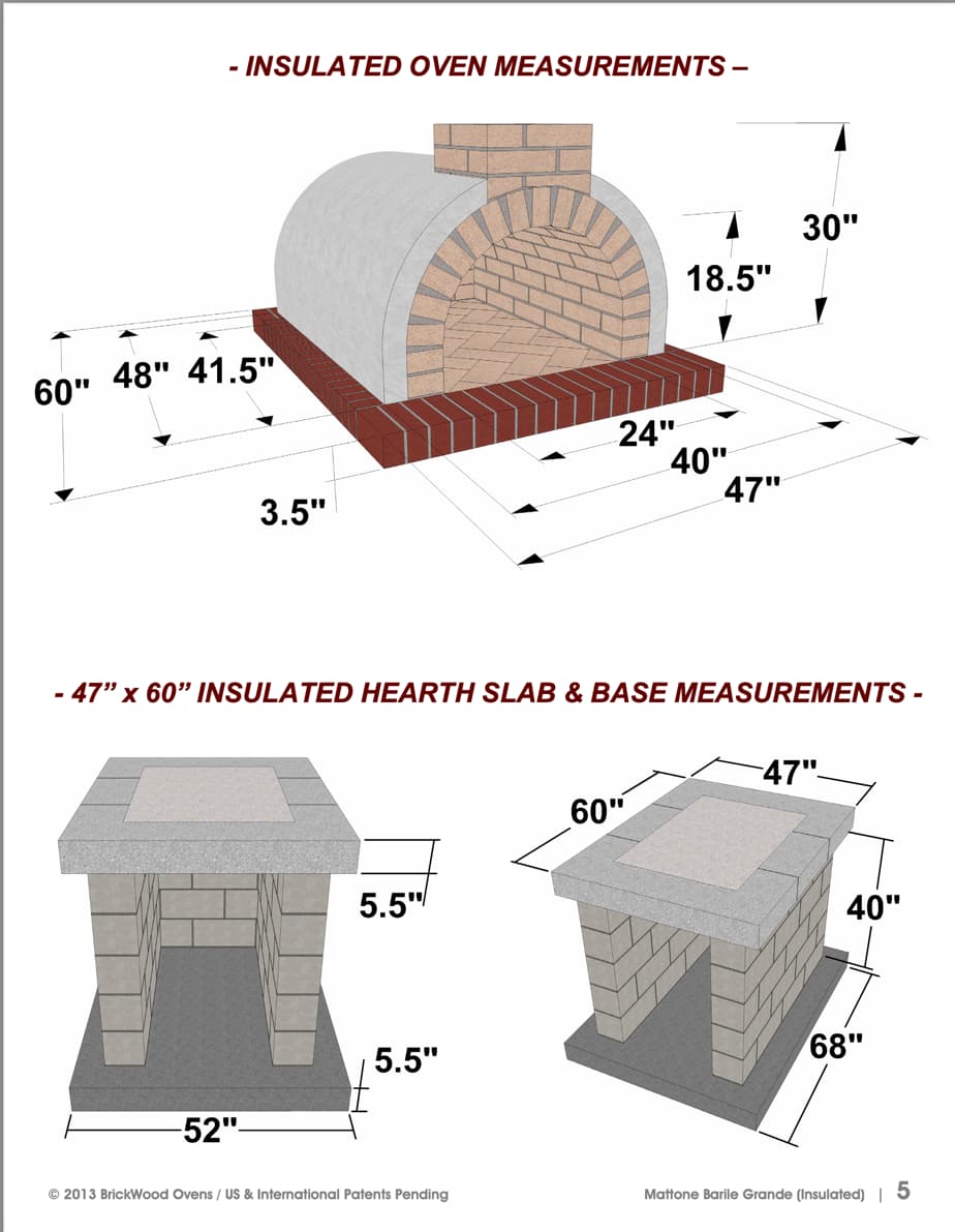

Can someone give me the measurements for the Grande foam dome please? Specifically the length front to back. Also the cooking floor as well? I have 29”x41” for the cooking floor. The foam dimensions state 39” for foam length. Can anyone confirm these dimensions?
Hi Rob,
Yes, I can confirm these dimensions.
The form stands flush to the front of the hearth (cooking floor). But it does not fully cover the sides or the back.
The reason is that the dome firebrick arch and back are intended to overlap the hearth and the outer hearth frame. So you need an allowance that runs roughly half across a firebrick.
The result is that the arch may appear to be “too short” by 2 inches. But that’s for the back wall.
Hope this helps!
