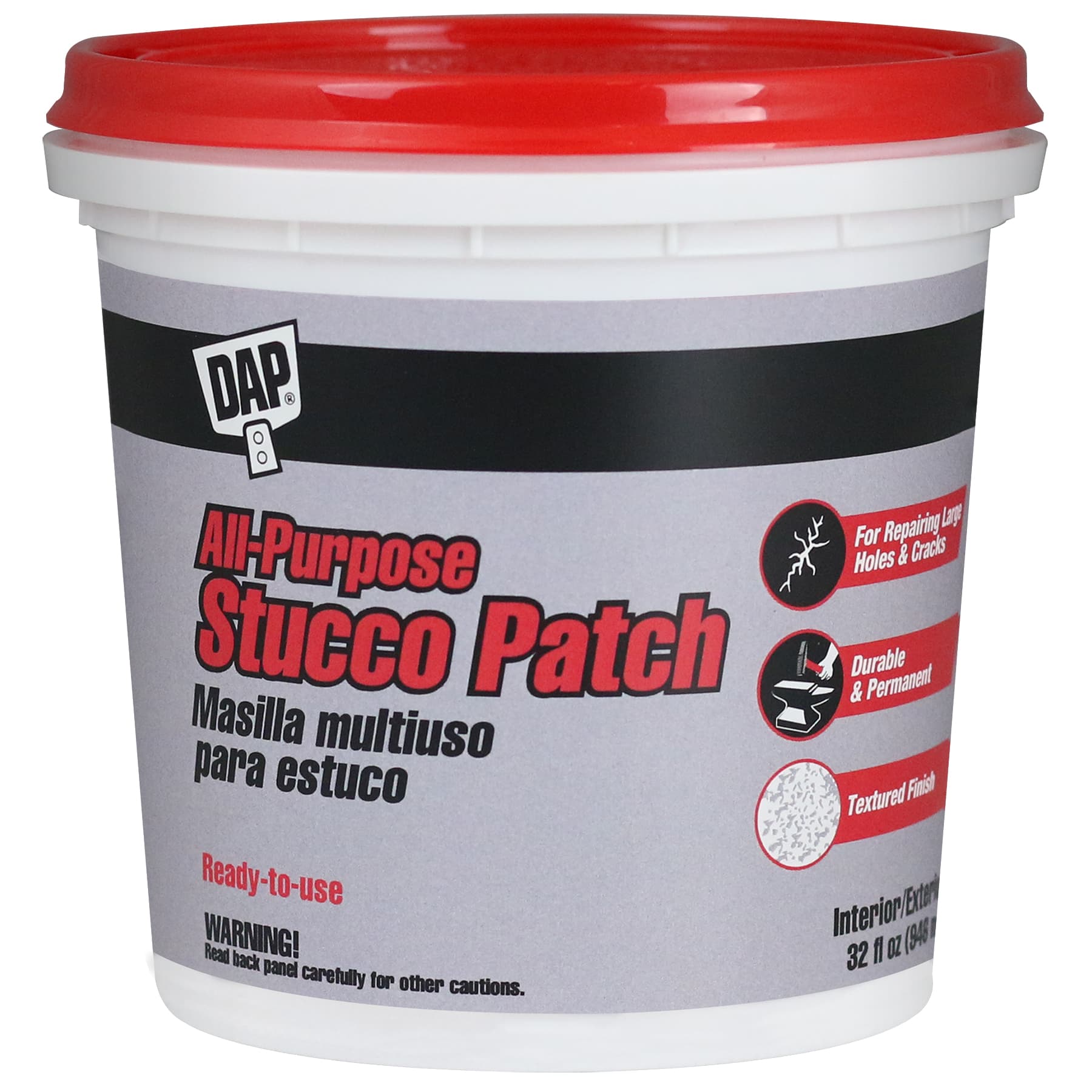

Fortunately there’s an inexpensive product that I found easy to apply.
This applies with a putty or taping knife, straight from the container. It is textured to match your stucco, and I found that all I really needed was a little finesse and finishing work with the putty knife itself.
When I checked this morning it’s about $10 for a 32-ounce container at Amazon.com.
According to the tech data sheet, it’s ready to paint after a 3 day cure.
Hope this helps and let us know how it turns out!
I did not use stucco (couldn’t find where I live) instead used mortar. Will this still work or should I use a ready made concrete type patch like this
Yes, absolutely. I used standard “Type S” mortar for my stucco shell. An actual stucco mix is mortar with some kind of reinforcing fiber added. You didn’t and don’t need it for this application.
I don’t recommend the concrete patch in particular; mortar is a weaker mix of the ingredients that go into concrete and I’d stick with a product recommended for mortar/stucco.
Presuming that you wet-sponged the mortar after applying the second coat, your stucco shell should have a grainy surface. This repair mix will blend very well with that. And again, you won’t see it under the superstructure you plan to build, but it’s important that you have an integral surface.
