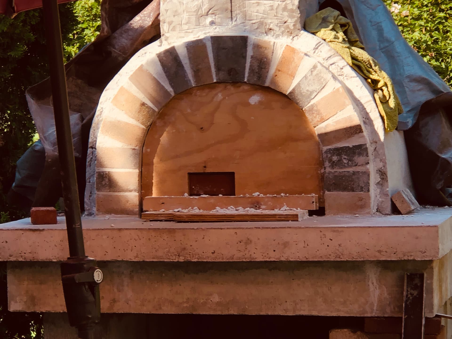

Here is what I did for the arches
Plywood works
2 “ rigid foam insulation (pink stuff )
Works great and easier to cut
That looks first-rate, Erminio, and it preserves the arch shape as you were hoping to do!
Thank you for sharing your technique through photos; I suspect @BrickWood is going to want to pick up this post for a FAQ.
Let us know how it works out for you for smoke control. Happy baking!

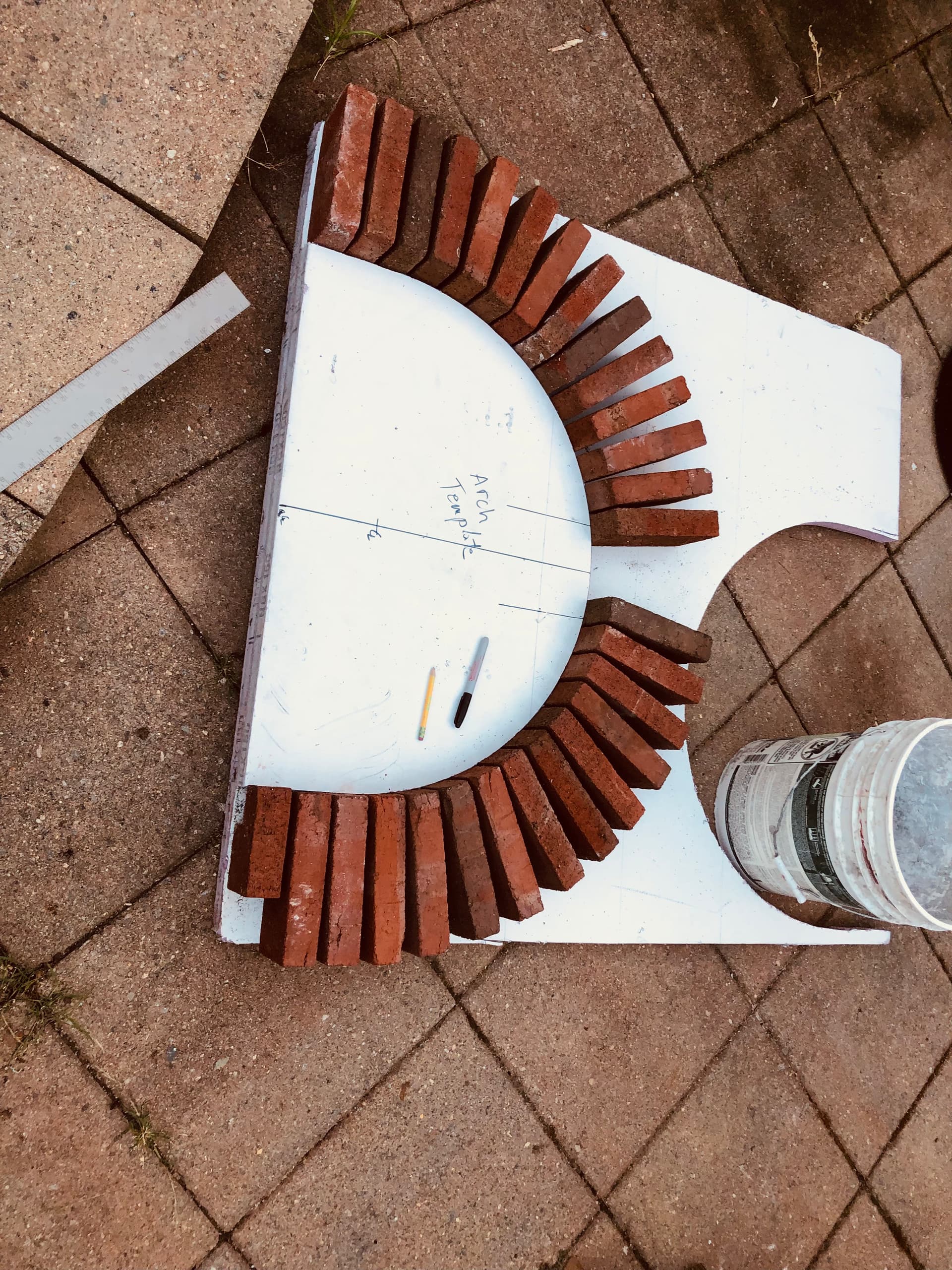

Here are some other photos of template and keystone in progress.
I’m not great at calculating all the angles and spacing.
So I laid all the bricks out on the floor and marked all the spacing on the temple .Then I measured the spacing on the outside of the bricks.
This allowed me to keep all the sides evenly spaced as I mortared the outside arch.

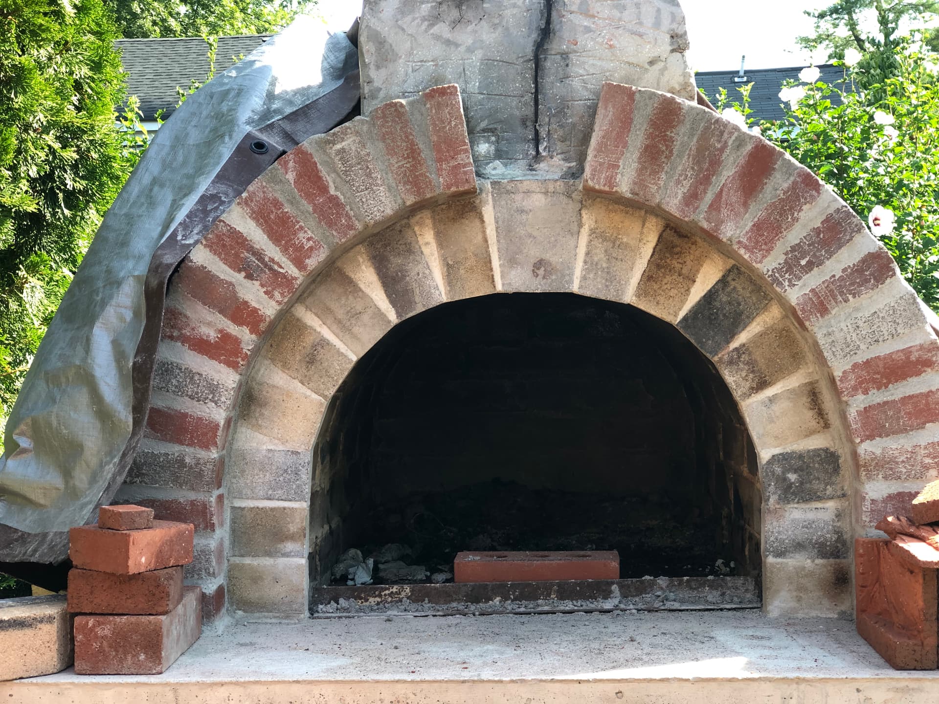

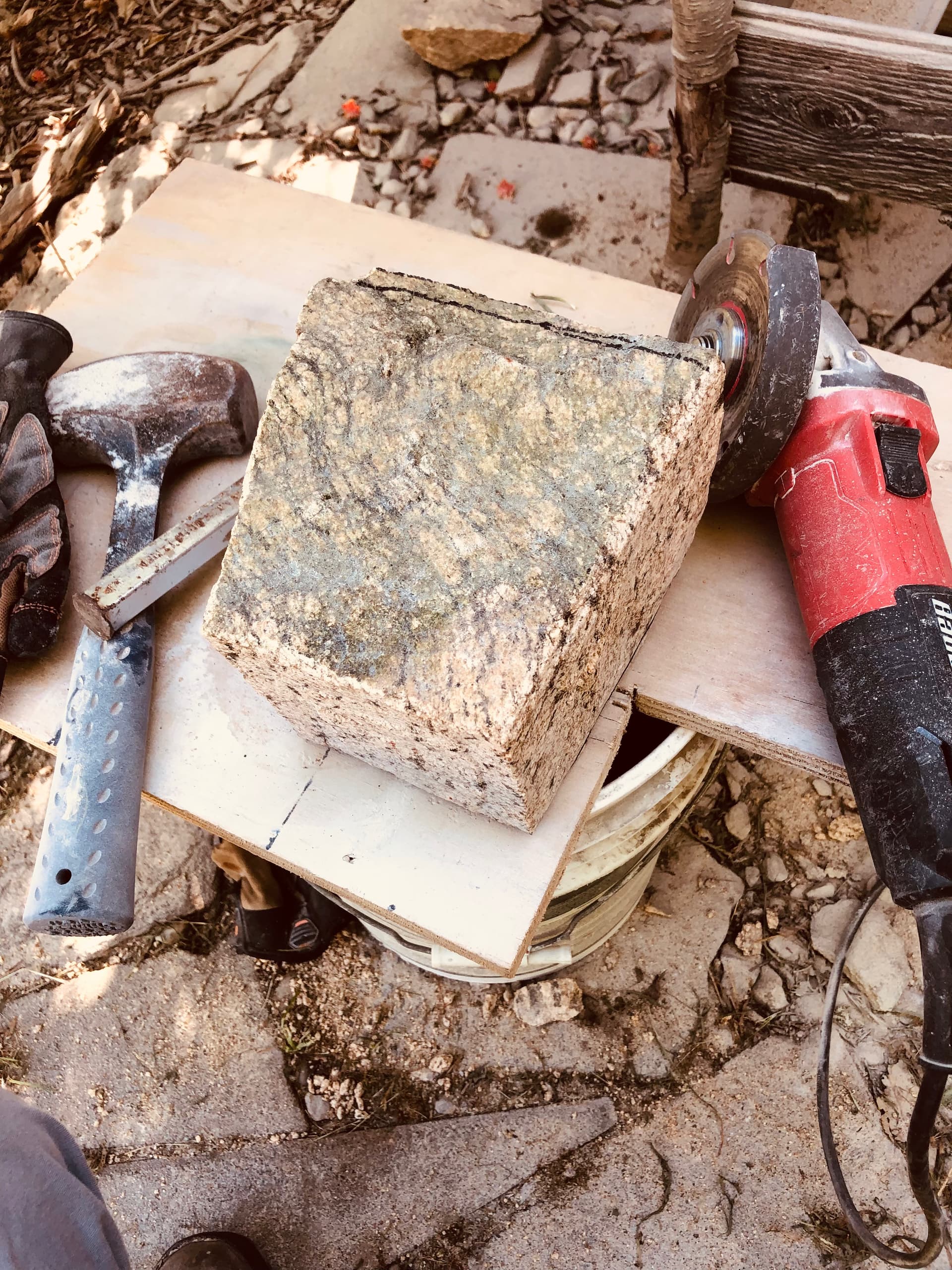

Now for the keystone😊
A few more views
