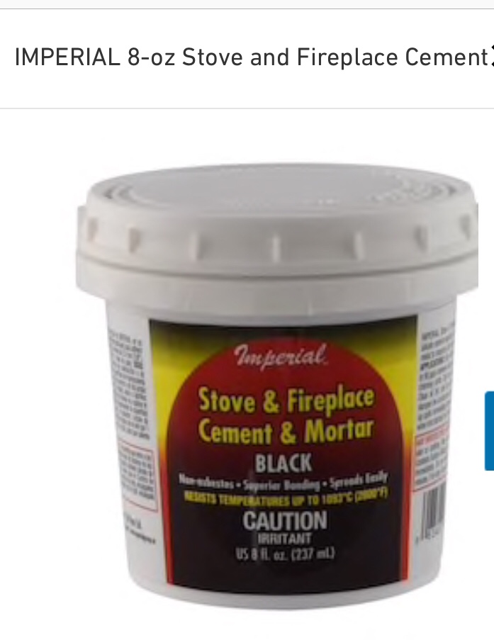

This is all you need.
Easy Peasy Lemon Squeezy…
Since I am mixing up more high temp mortar today can I just use that instead? I was planning to brick the doorway so would need access to enterior of oven now before I close it off.
Looks like a winner. Just make sure it is NON-WATER SOLUBLE! That’s the most important feature.
You never anticipate the inside of your oven getting wet - but if it happens… you’re covered.
Kids… sprinklers… crazy hard rain… inlaws trying to be nice and washing the oven before a neighborhood pizza party (yup - it happened)…
