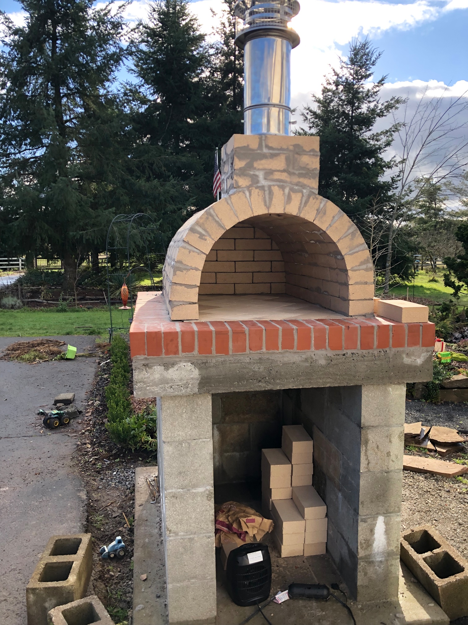

I am at the insulating stage of the build on the grande
(Just test fitting chimney in this pic)

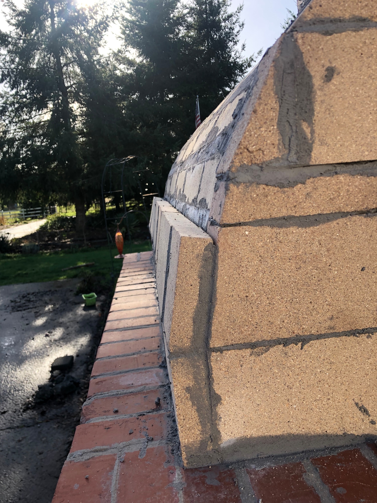

#1 Should I add some thermal mass to the arch at this stage to help retain heat for bread and tail end cooking? Idea would be to add a cladding of 1/2 thickness fire brick layer onto the outside of the barrel. That would then be covered by the specified insulation/mortar/veneer. Is this insane or would it compromise structural integrity to do so?

Hi Andrew, and welcome to the BrickWood forum!
You are most definitely in the right track. Your build looks sound and the chimney will look much more proportional once you insulate and stucco.
On the face of it, using splits as an extra refractory layer is a good idea for your intended use. You’re looking for long-haul heat here, not merely insulation, and I think that’s a good way to achieve it. My advice would be to use a thin layer of the heat resistant mortar (which itself is a refractory) to maintain contact between the two brick layers. You want to avoid inadvertently introducing an air break between outer and inner layer—so keep your second layer tight to the first, with just enough mortar to maintain good contact.
Related: I don’t think you’ll compromise the structure. You’ll be adding about 100 pounds overall plus maybe 10 pounds of mortar. The slab is specced to bear a lot more than that.

Made some progress on these ideas over the weekend. On to insulation later this week when I get some time.
Thanks again for feedback and advice!

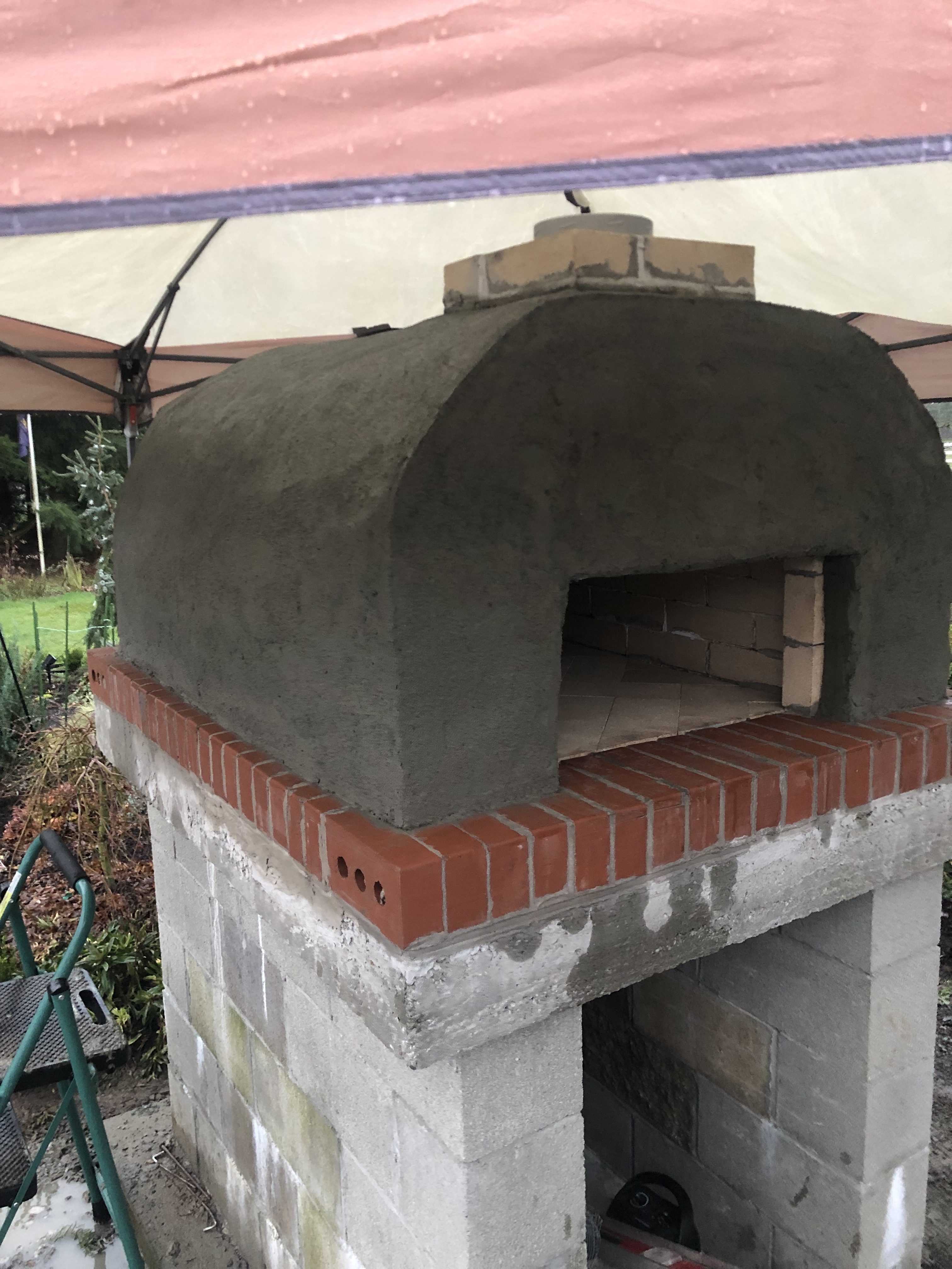

Current status:
Ended up with 2” insulation front and back and 3” around barrel. Stucco isn’t available locally so shell is type S. Was able to find MVIS mortar though so I might to get to veneer next week if forecast holds up. Curing isn’t far off now!
That looks great, I like how massive it is.
Looks like everything came nicely into the footprint. Great job!
