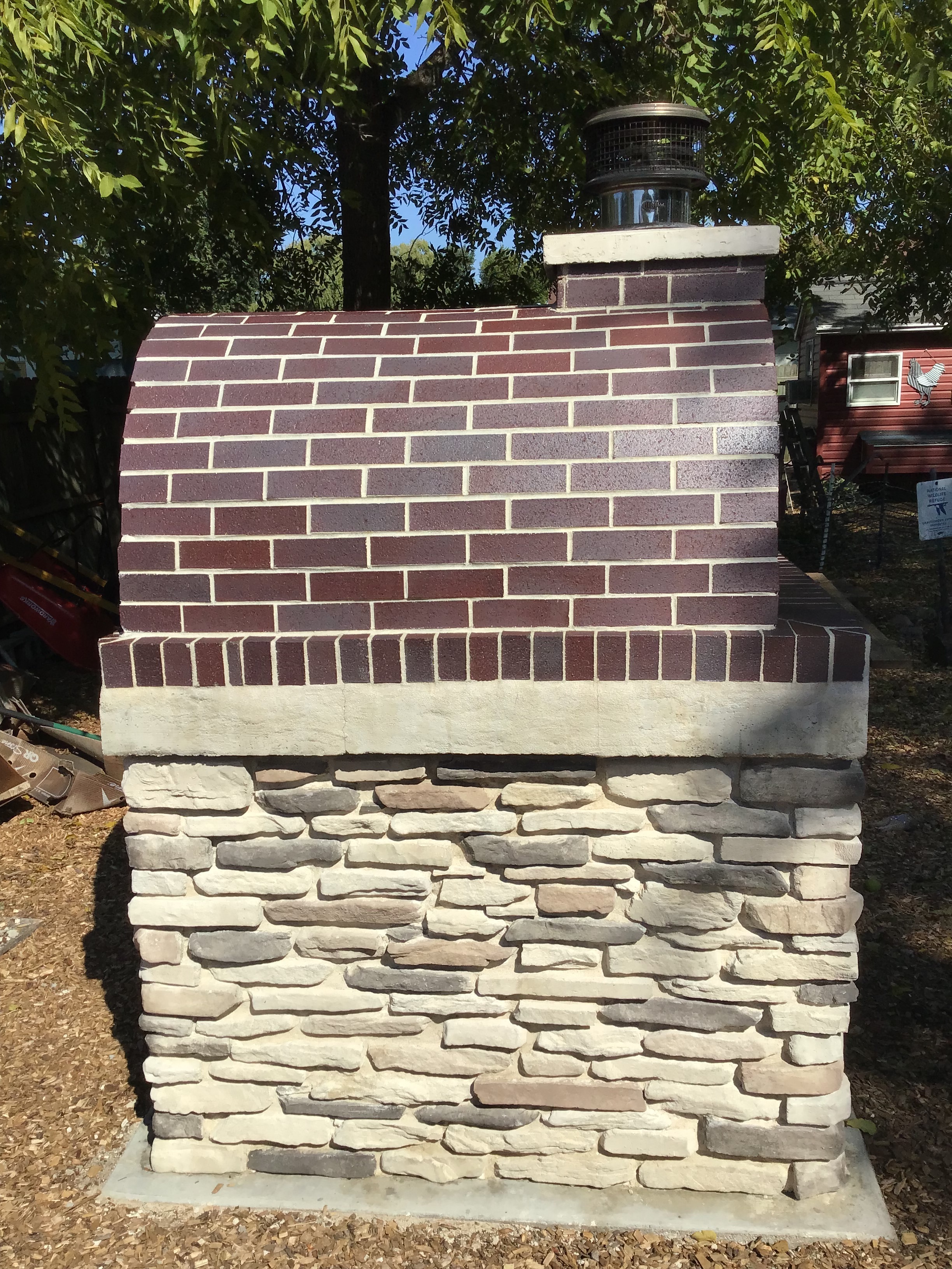

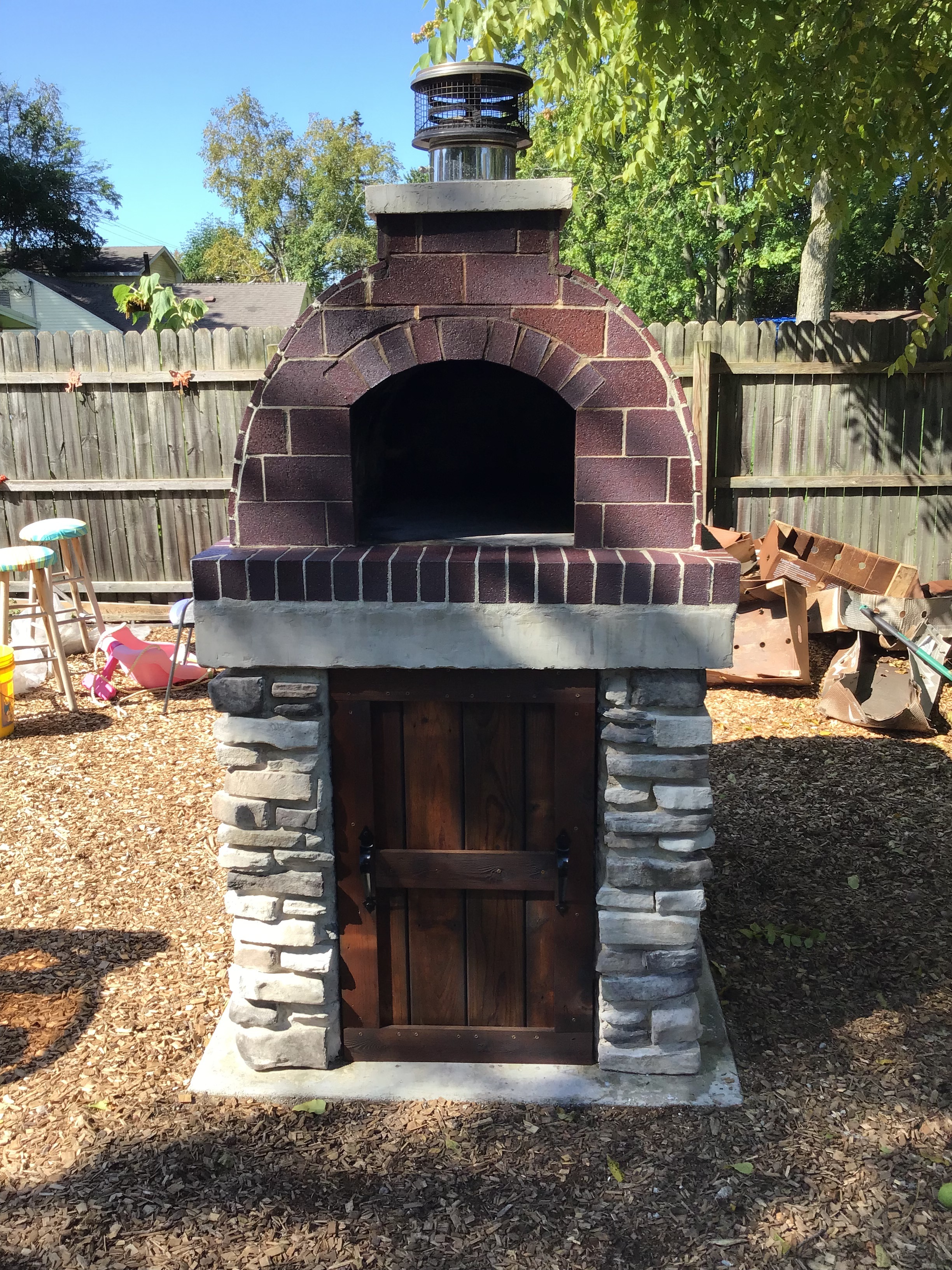

After a little over a year I’m proud to say my oven is finished. Everything is built attached, and sealed, ready for years of fabulous food, and good times.
That’s beautiful. I love all the details. Awesome job. Have you cooked with it yet?
Is the bottom door attached?
Thank you, yes I’ve been cooking in it while finishing it. The door just sits in so it can be moved out of the way while cooking
@Bill Fabulous job, I love the stone and brick veneers, looks professional. The chimney top is a really nice touch too, is it made of concrete? The door looks awesome too! Congrats and enjoy the great times ahead with the your beautiful oven.
Thanks for the compliment’s, the chimney crown is concrete. I built a form and poured it then placed it on top I haven’t sealed it down yet, I think it should cure a bit more first
First class job, Bill! Besides looking absolutely gorgeous, that oven also looks like it means business. Tasty, delicious business.
I like what you did with the crown. When it comes down to it, many people will not see the hearth or the hard work that went into making your oven a pizza boss. But everyone’s eyes are drawn upward with a structure like this, and you’ve got a statement there for them to see.
Congratulations, and many awesome apizzas to you and everyone you host.
