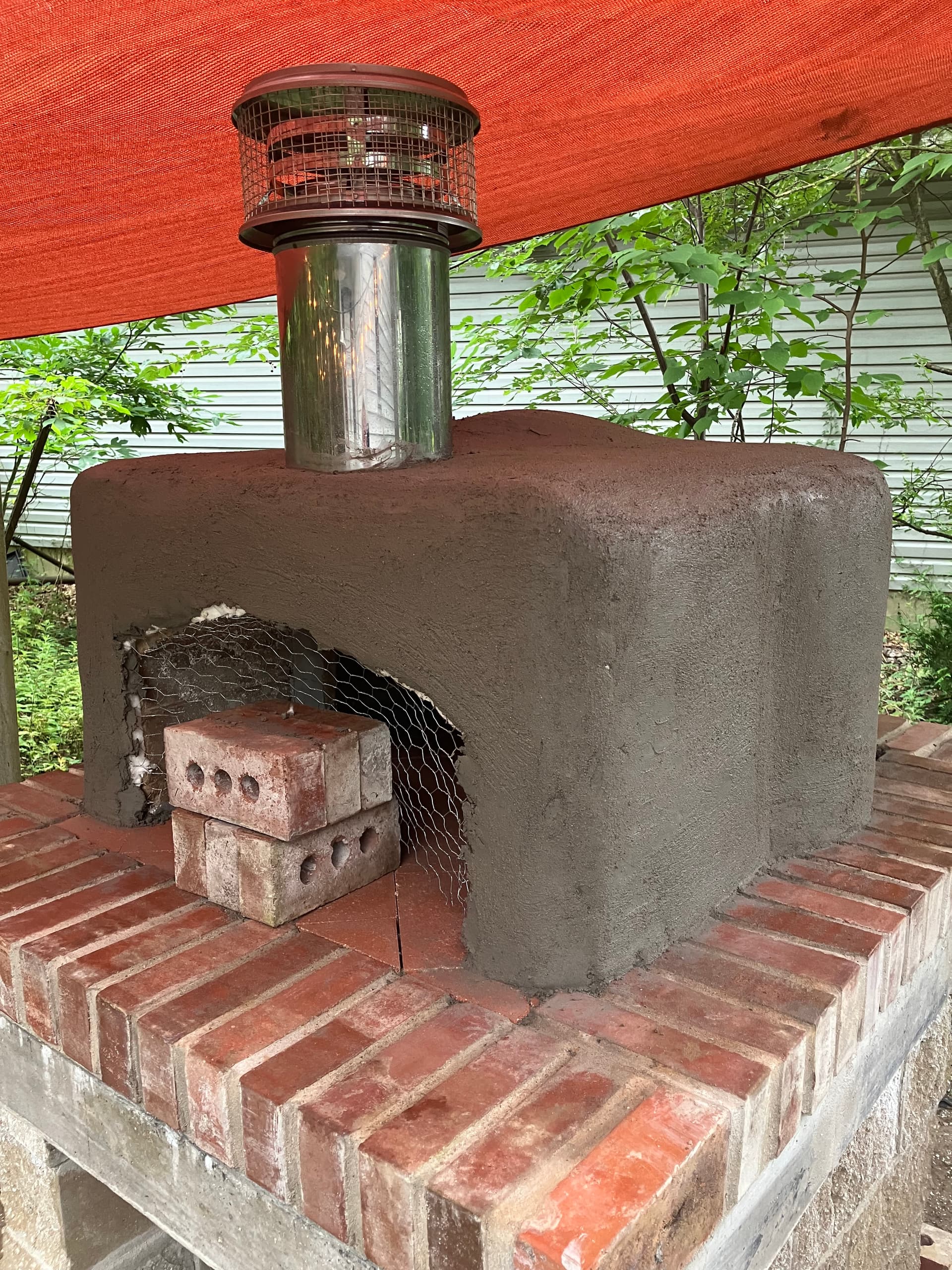

Hello all,
I have just finished the first coat of stucco over fiber blankets for my mattone cupola. I was wondering what different ways people finish the stucco around the door of the oven. I left the chicken wire over the opening to keep the blanket tight, yet tomorrow, with the second coat, I will need to finish and or clean up the edges up front. looking for guidance as to best way to do so.
Looks great!
To finish, I used a pair of nippers (like a diagonal plier cutter but with the jaws at the top) to nip the ends of the wire. You want to overlap the firebrick just enough to seal the insulation underneath, but do not cover the ends of the firebrick. The heat will crack the stucco overlay and could induce a larger crack in the shell.

Use a small trowel or putty knife to shape and smooth the stucco around the door. You can also tape off the door area first to keep the edge clean while applying the second coat.
Great advice!
Just a small additional detail: cut the chicken wire from across the opening before the first coat. After you apply first coat, use your wire nippers to cut back the loose ends. The second coat should cover any stray wire.
